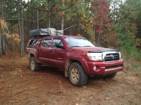

That's the plan for my 60. A 5 speed with 4:10s and 33s. I want this for more overland stuff and a daily driver. As soon as I sell my tacoma and finish rebuilding the transmission and transfer case I will start daily driving this. Hopefully the Tacoma will sell soon.
