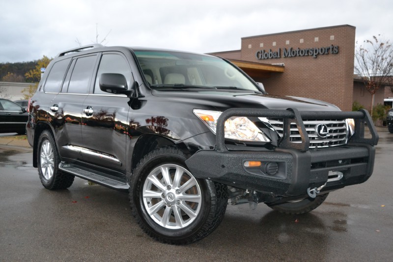

ARB front bumpers have been done to an LX, I don't know of a rear being done. If I end up with an LX, we'll find out though.
A little internet search led to this:
Now, I'd've painted them to match the car but to each their own. I'm still trying to find a TJM T13 on a 570.
