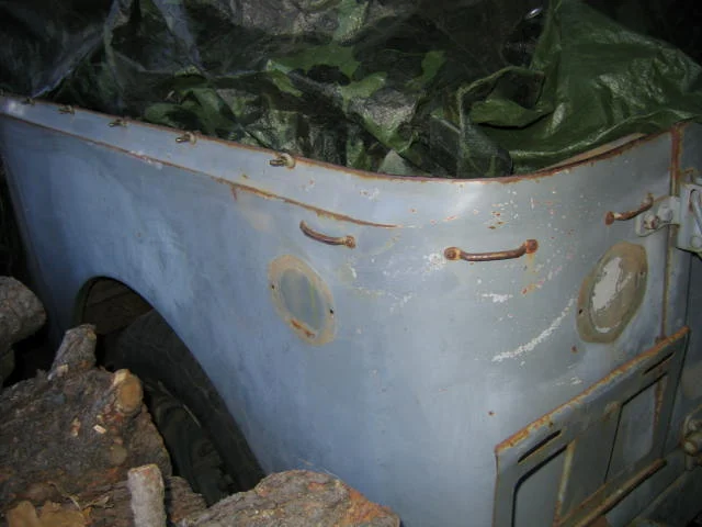

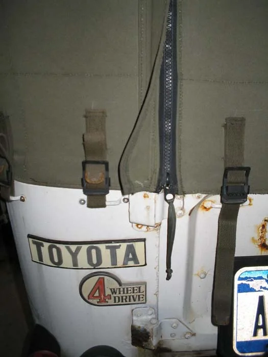

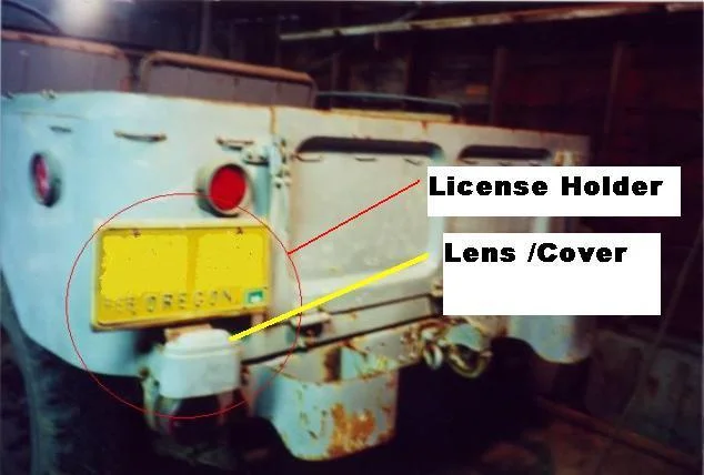

attachment.php
attachment.php
attachment.php
Digging deep to find pictures I see Johnny. No way to use the first one to measure from the front door on a FJ25 soft top. The footman loops on the tailgate in picture 2 are not footman loops at all but just pieces of insulated wire. That has been corrected and are now OEM footman loops. The one I planned on taking pictures of is a 73. That door measurement would be correct.
