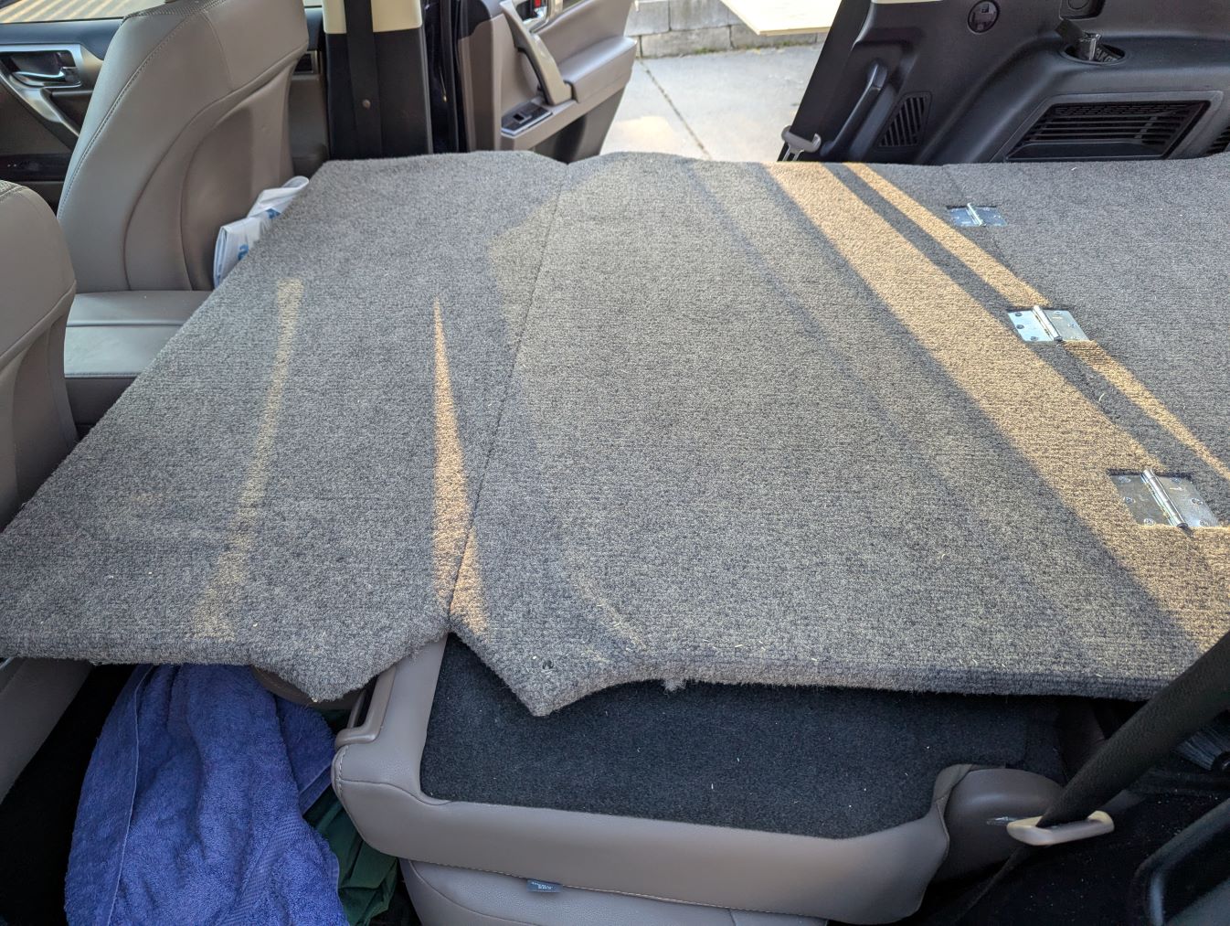

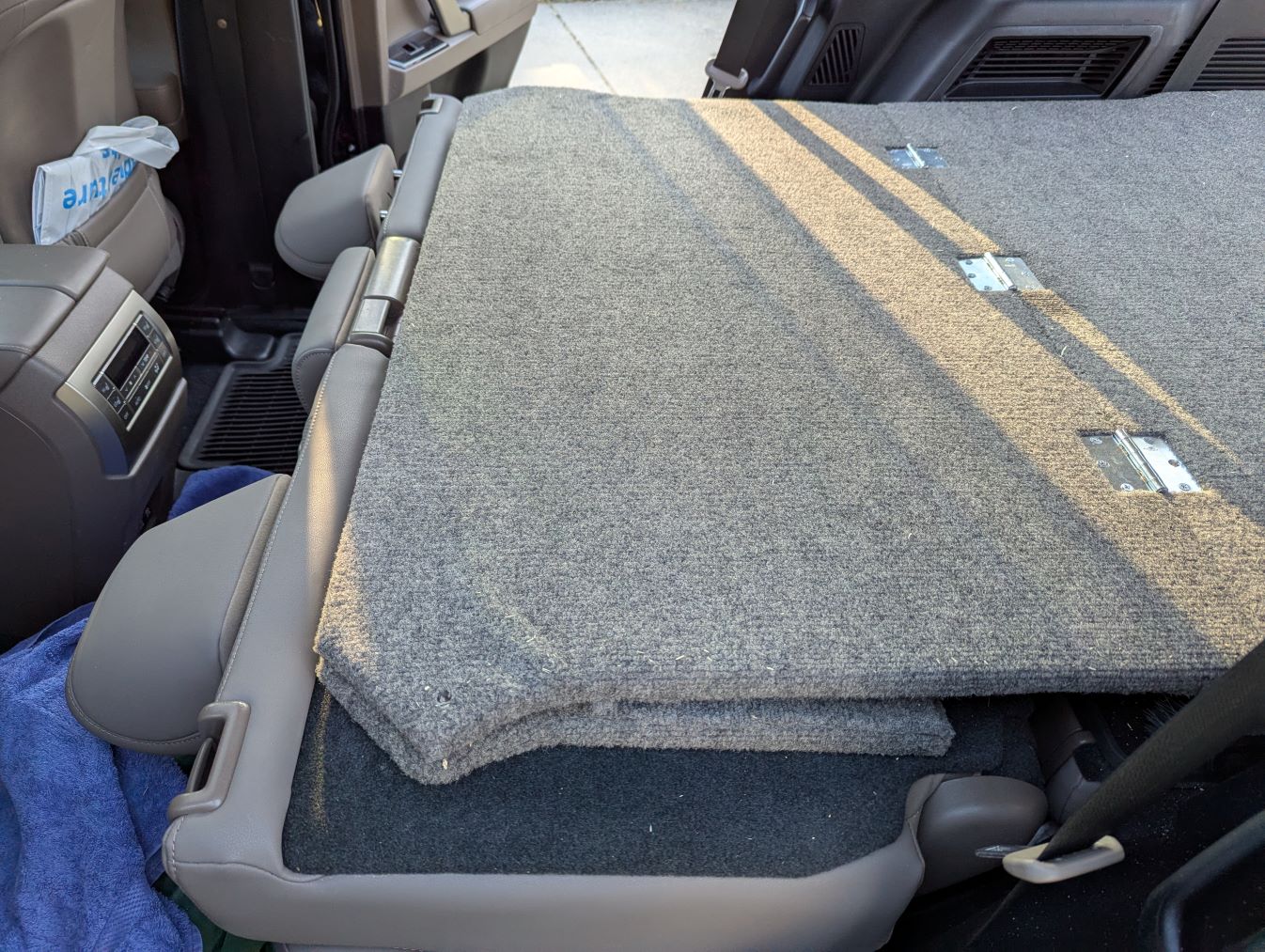

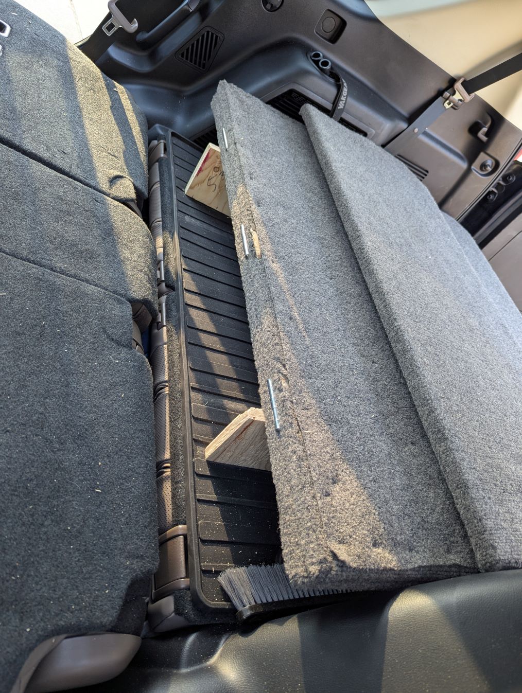

I plan to use my GX for some camping this summer, so I wanted to design the lowest-profile sleeping platform that I could build that will come out of the truck easily for storage. I figured I would share some pictures and dimensions to help out someone else trying in the future. These dimensions are pretty good, but not perfect, there is about 1/2in wiggle room between the wheel wells, and some open space behind the wheel wells so the hinged section can fold forward. I realized the dimensions sheet switches from fractional to decimal dimensions, but you get what you pay for.
It would be a lot easier to just make the whole platform a consistent width, but I wanted to get as much support for a mattress as possible since my fiancee and I will both be sleeping in it for a few nights. After I cut the shape for the rear-most section I layered the middle section on top and used a router with a template bit to copy the shape, rinse and repeat for the section at the front. I am also a little over 6' tall so this is about as long as I could make the platform. I used locking hinges like these for the "legs" Amazon.com - https://www.amazon.com/dp/B07TVNMSNQ?_encoding=UTF8&psc=1&ref=cm_sw_r_cp_ud_dp_A5V826T6P5446S2VG11P&ref_=cm_sw_r_cp_ud_dp_A5V826T6P5446S2VG11P&social_share=cm_sw_r_cp_ud_dp_A5V826T6P5446S2VG11P&previewDoh=1, and the middle section overlaps the legs by about an inch when it is extended and feels reasonably sturdy. I used 1 sheet of junky 3/4in plywood that was underlayment in a previous life, and it is covered in a $15 outdoor rug from Menards. The whole assembly stores behind the 2nd row without any issues, and with the mattress on top it is pretty quiet/doesn't bounce around too much on fire roads. The sections are all hinged together so I can drive to a campsite with the forward-most section folded under, park, scoot the seats forward, then deploy the last section and I was limited by vertical clearance (hence the corner cutouts).
The shaded sections indicate material was removed:

I will add my goal isn't to store the platform in the truck all the time. It folds relatively small (36x46x4in) so I can pull it out of the truck and keep it in my garage, so the drawer would just be another thing to store, but I might try and hunt down a good plastic tote to throw in the void.

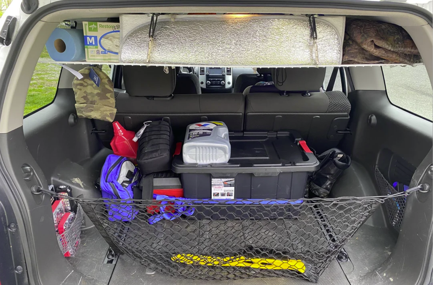

The Lobo rack is intriguing, but I already hit my back on the roof when I climb in, so it might not be ideal. To start I might just string up a cargo net or something like that from the grab handles, that would at least offer some storage, but I have some time to figure it out (). What I really want, though is to be able to hang a backpack from the rear handle and keep it tucked up in the window cavity.
I might just string up a cargo net or something like that from the grab handles, that would at least offer some storage, but I have some time to figure it out.
You could do a paracord frame that runs in a square around the passenger grab handles and the rearmost grab handles, then attach an ATV bungee net to it and tack the sides of the net to the paracord with small zip ties, or velcro wraps cut to about 1". This would be good for light weight bulky item storage like jackets and such. This is my old 4R but concept is same-same:

Edit, I forgot to add with that paracord square that you build as the framework for the ceiling net, I found the best way to keep that super tight and still build in some adjustability is to use a Nite Ize cam jam rope tensioner on one corner of it. That way you can cinch it really tight. It never sags and you don't have to worry about trying to knot it perfectly to keep tension.
I have a couple of those around here somewhere they work well for low to medium loads. Work very well. I also have several Nite Ize gear ties they are what I use to hold the front of the dog crates to the back of the rear seats.

I didn't actually have a roof net / hammock / what have you in the GX and this whole trip I just took I was saying to myself "damn, self, why didn't you install one?"
So I did today. I would note that the GX has different measurements than the 4R did. On the 4R I used a 28"x28" ATV net; on the GX a 15"x30" net works well. I got it for $7 at Rural King.
Set your paracord frame nice and tight with a CamJam as noted above, pull the hooks off the net, and zip tie the net up starting in the corners and working in.
