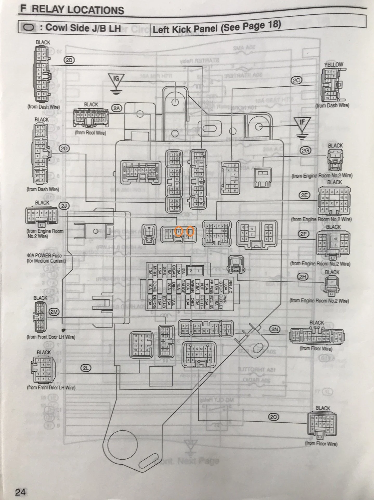

Looks like on later trucks ('04-on) the relevant wiring is underneath the main engine bay junction box on connector 1A. :confused: I updated my earlier post to indicate wire numbers & colors to cut/jump.
I think the point here is to run the fogs with the parking lights on, brights, etc. which in turn means the taillights are on as well. I don't think you would want to just run the fogs independently...
In that case you'd want to power the FOG relay's coil (connector 2J pin 11) from the TAIL circuit. On earlier trucks TAIL power can be found on connector 2F pin 2, or connector 2O pin 10 (both green wires), all at the left kick panel junction box.

Ok, after further study you can jumper one accessible wire to make this happen on '98-'03 trucks:
On the driver's kick panel junction box:
- On connector 2J cut pin 11 (red-with-blue-stripe wire) leaving a pigtail to work with.
- Tape the wire end that's coming out of the harness (red-with-blue-stripe wire). This wire is hot when your headlights are on.
- Connect pin 11's pigtail to pin 8 on the same connector 2J (black-with-red-stripe wire). This is ignition-switched power.
This way the FOG relay's coil will get its power from the IGN circuit, ready to be activated when you turn on the Fog switch like always.
For later year trucks this wiring is underneath the main engine bay junction box on connector 1A:
- On connector 1A cut pin 61 (red-with-blue-stripe wire) leaving a pigtail to work with.
- Connect pin 61's pigtail to pin 60 on the same connector 1A (black-with-white-stripe wire). This is ignition-switched power.

Just did this on my 2003 as well exactly as Ayune describes for the "later year" trucks. The following post about replacing the junction box does a great job showing how to get to these connectors. Pro tip be smarter than me and use a multimeter to make sure your pins have been connected per the Ayune mod before putting everything back together, ask me how I know... Also make sure you count the number of pins on the connectors to make sure you are tapping into the correct wires! Both connectors look very similar and there are many same color wires down there, use the 1A pin diagram it only has 9 pins in the middle blocks! Use the ribs in the diagram to make sure you are looking at the connector in the right orientation.
