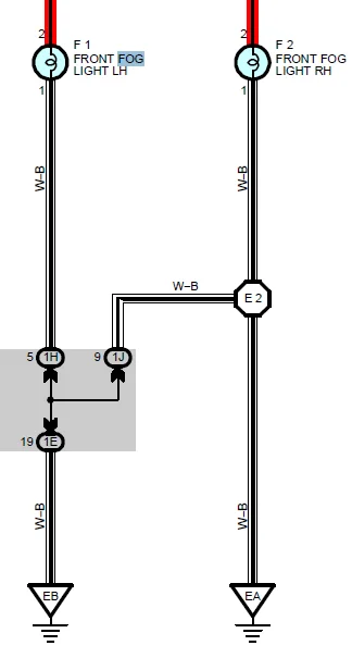

thanks for the response, i got na ew switch as well but no luck , could you tell me where is the ground wire the in bumper or anywhere else for the fog light

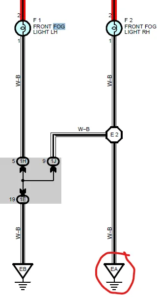

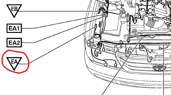

Did the old switch test bad? Check the engine routing diagram for ground information
This is from a 2001LC. Probably accurate for yours.
