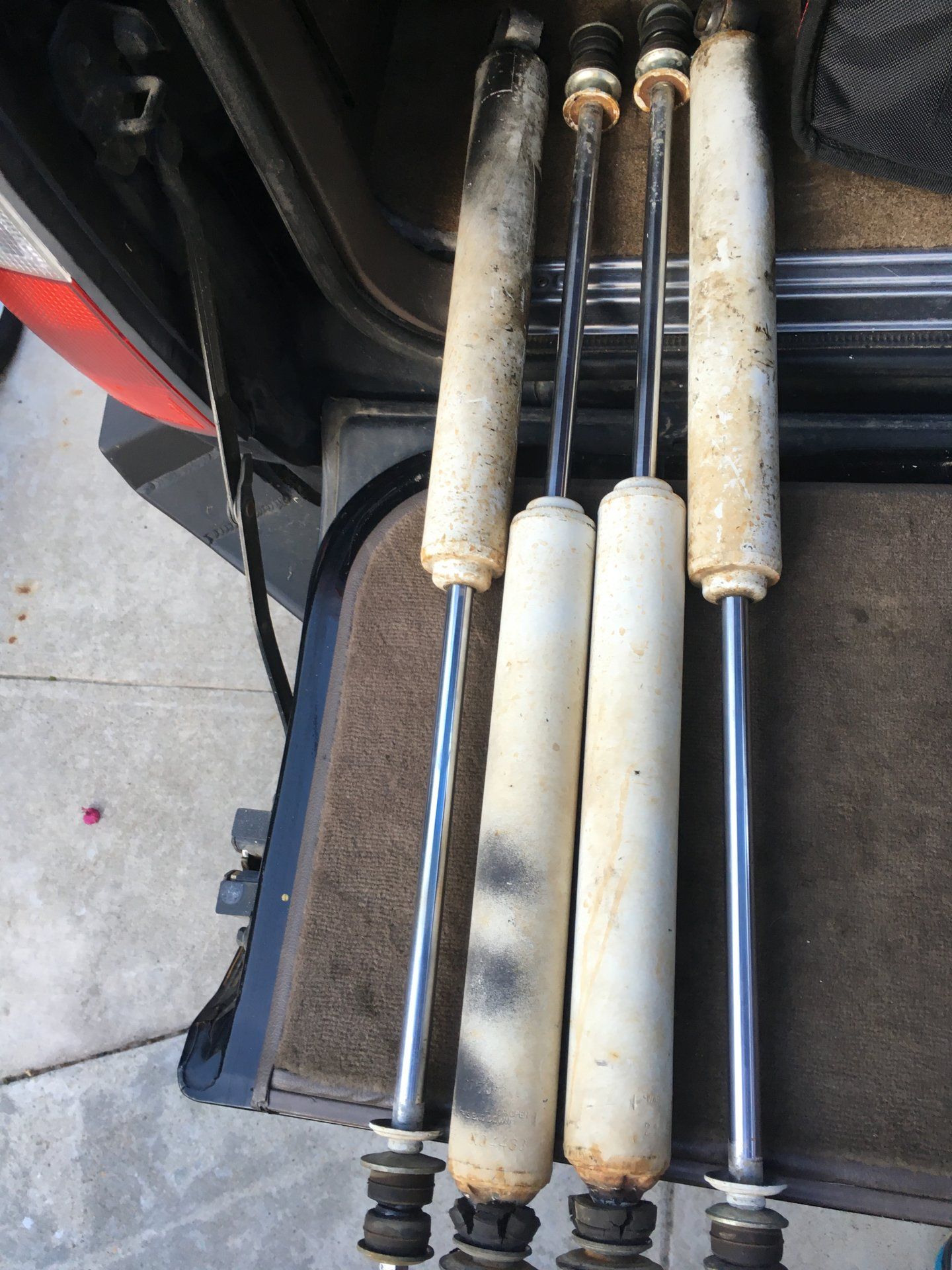

I've had the Metric TLC (out of business, no longer available) for years and just got around to having them installed. Now my truck is a mix of new car and mouse piss smells. Replacing the foam and leather helped a bunch with the mouse pee smell, but I still need to pull the dash and get, hopefully, the last areas clean. But the seats are comfy and clean!!
Went from Procomp ES9000's to Icon 2.5 remote reservoir shocks. I ordered the rears with the CDC valve and the fronts without. I figured I would only need the adjustability for the rear. Now that they are installed I feel I should have ordered CDCV all around. It would have been a few hundred more to outfit the front with CDCV and at the time of ordering I appreciated the savings, but with hindsight....
The shocks came with a mounting bracket for the front and rear reservoirs. The front RR mount is installed on the spring perch, the rear RR mount attaches to the frame, right above where the LCA attaches. I ran into an issue because of a plate used to mount the sliders. There wasn't enough room to slide the reservoir through. To get home I ran the hose underneath the slider with plans to have some of the plate cut out in order to be able to run it properly. Once the plates were cut out they mounted up no problem.
The reservoir hose contacts in some places, most concerning is it rests against the rear sway bar mount. Anywhere there was contact I cut 3/4" heater hose and zip tied that around the reservoir hose. Seems to work and I'll keep an eye on those points for wear. I also had to increase my bumpstop length by another 1.25 inches, so overall they are 3.25 inches longer than stock.
Can't express how much better the ride is. No wallow, feels planted. Took it out to some local trails (Corral Canyon, Alpine CA) after the install and am extremely happy with how they performed. No more rocking and bouncing back forth. On the highway I feel almost like I'm driving a car. Bottom line they are worth every penny. Thanks to those who answered a few questions I had during the install. Oh yeah, sometime since last post also replaced all rear LCA and UCA bushings, rear sway bar mount bushing, and a few others so I'm sure that helped with the improved drivability.
