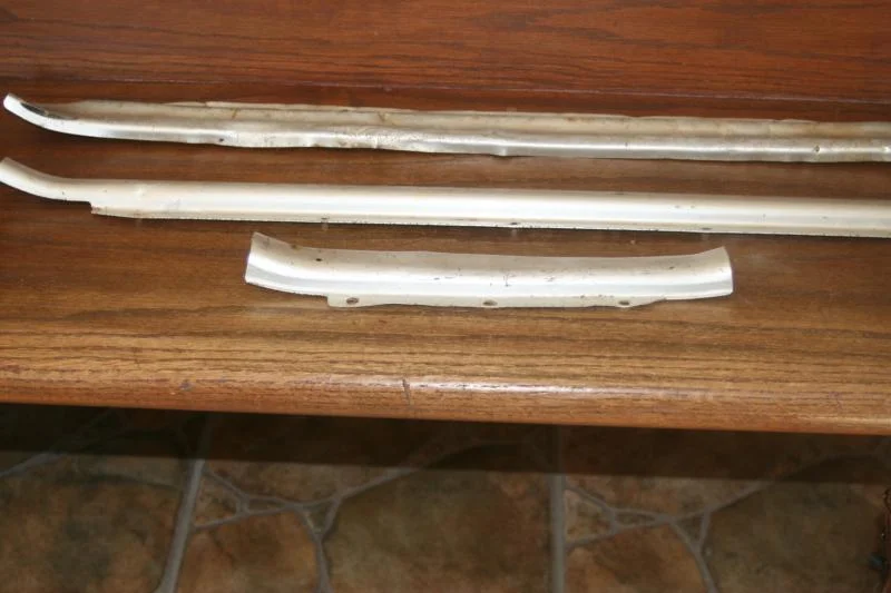

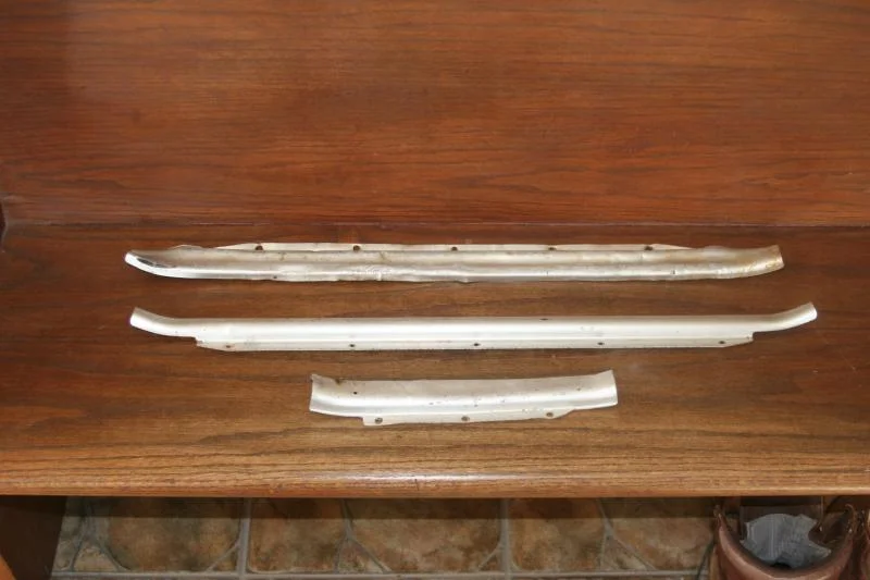

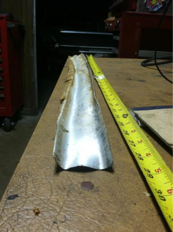

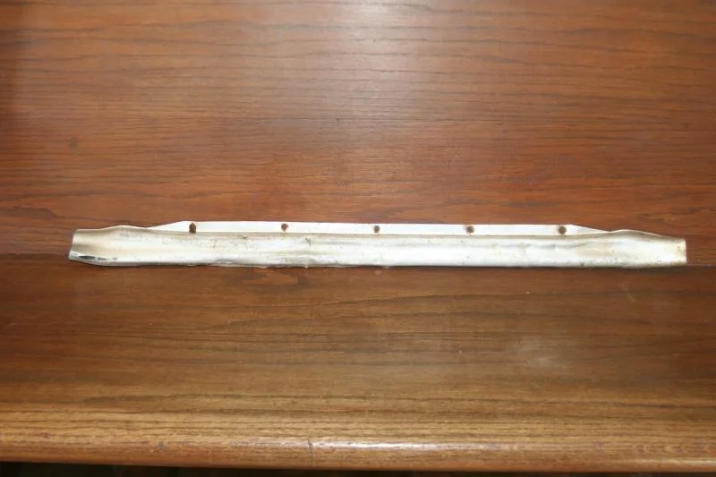

Bob,
All I have are three loose ones. I have a full set on the 69, if you need them.
The long fat one is the front driver's side
The long skinny one is the front pass. side
The short fat one is the rear driver's side
And the one I'm missing is the skinny pass. side rear
:whoops: Sorry Bob, I forgot to measure them today. I think Mel is right, we should send you some templates. They have alot of curves in them. Not sure if you want to take that on.
I can send what I have also. Betwwen us, we should come up with a good set.
