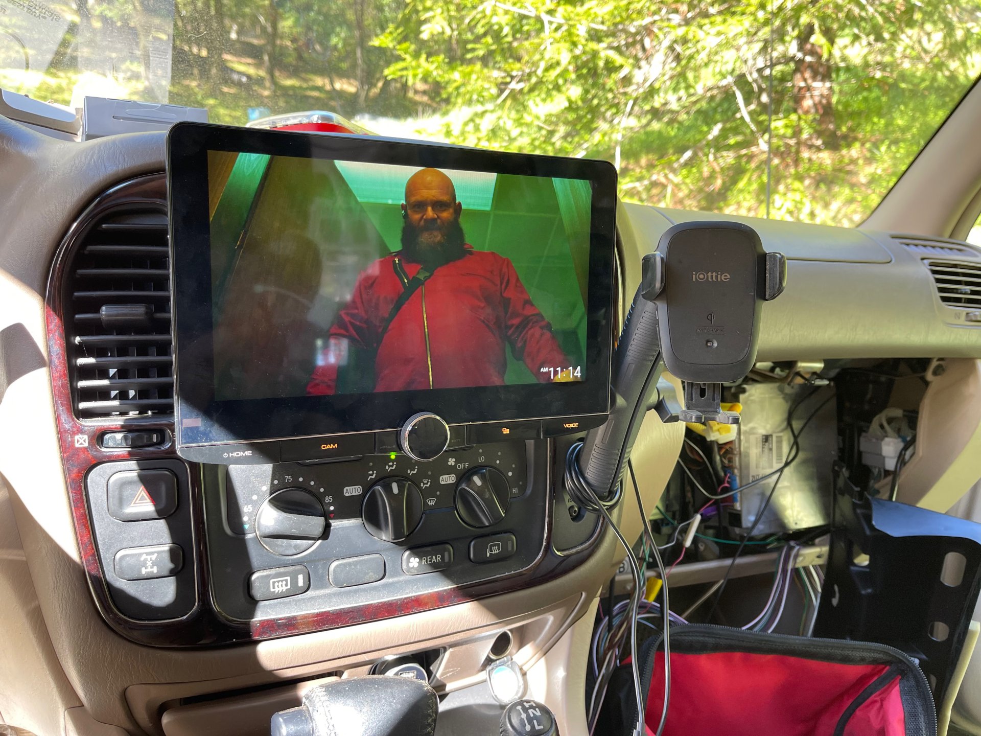

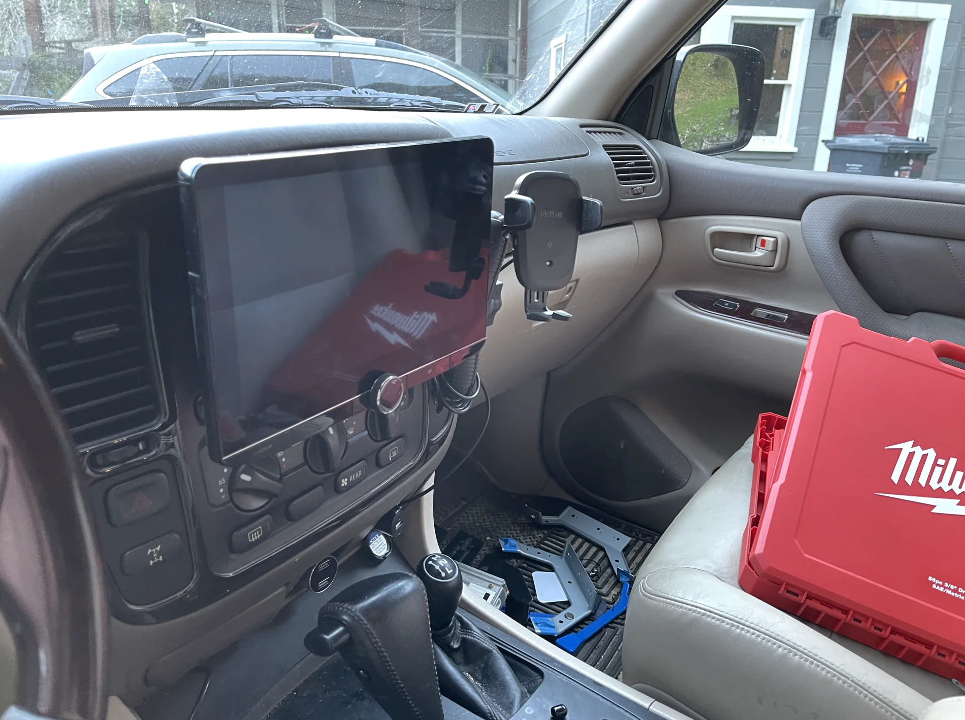

Kenwood 10" DMX1057XR in a 2000 LC100 non-nav. Did the factory amp delete. Very happy with it. That's the highest it can go, I think. I might extend it out a bit more so I can tilt it back a little. It obscures the antenna controls and the clock, but climate controls are ok.
Hey @skink, are you still liking the Kenwood? Anything you’d do different, and any experience with whether it bounces around when the road gets rough?
I still like the Kenwood a lot. It does way more in terms of EQ and modes and all that than I need, and the ergonomics of the interface are great. I've had no problems with it.
I very rarely try to do this, because I don't watch movies in the car, but the ability to mirror the screen from the iPhone to play a video is somewhat hit or miss. I hear the Android functionality for this is better and even works over wireless, whereas the iPhone must be plugged in. But again, I've maybe tried that twice and gotten it to work eventually, just not as easy as you might hope.
The main thing I'm after, wireless CarPlay, is very solid. All apps work great. The mid-price speakers I put in with factory wires sound great, except the tweeters are a bit loud and harsh, which I fixed with the equalizer on the head unit. The screen is very responsive and crisp and the HD backup camera looks awesome.
The playback of dashcam videos from the paired Kenwood dashcam is not HD which is kind of a missed opportunity, since the camera itself is, but no big deal.
No bouncing around whatsoever.
You really can't see the clock and the outside temperature anymore, which is mildly annoying, and I never tried adjusting it further to fix that (it's not clear you could easily do that). Parts of the climate controls are obscured but it makes no difference to my ability to manipulate them, you just might not see the top of the gauges.
I wouldn't change my choice of head unit at that time, although I don't know what might be available now. I should have changed out my D light on the dash since I already had some of the trim off to route the mic, but I don't think I would have done anything else differently.

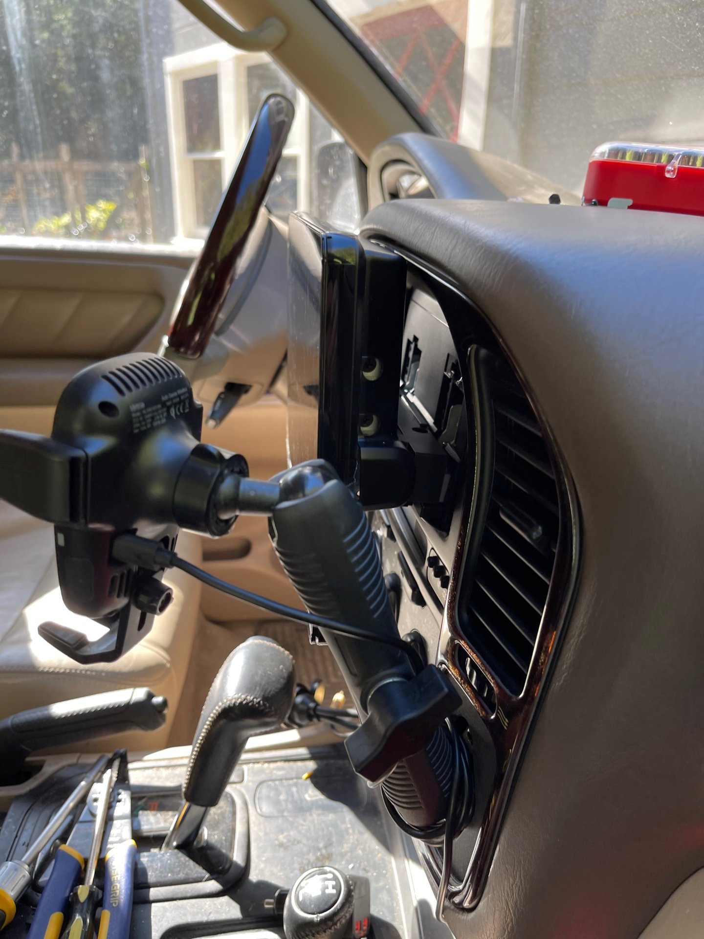

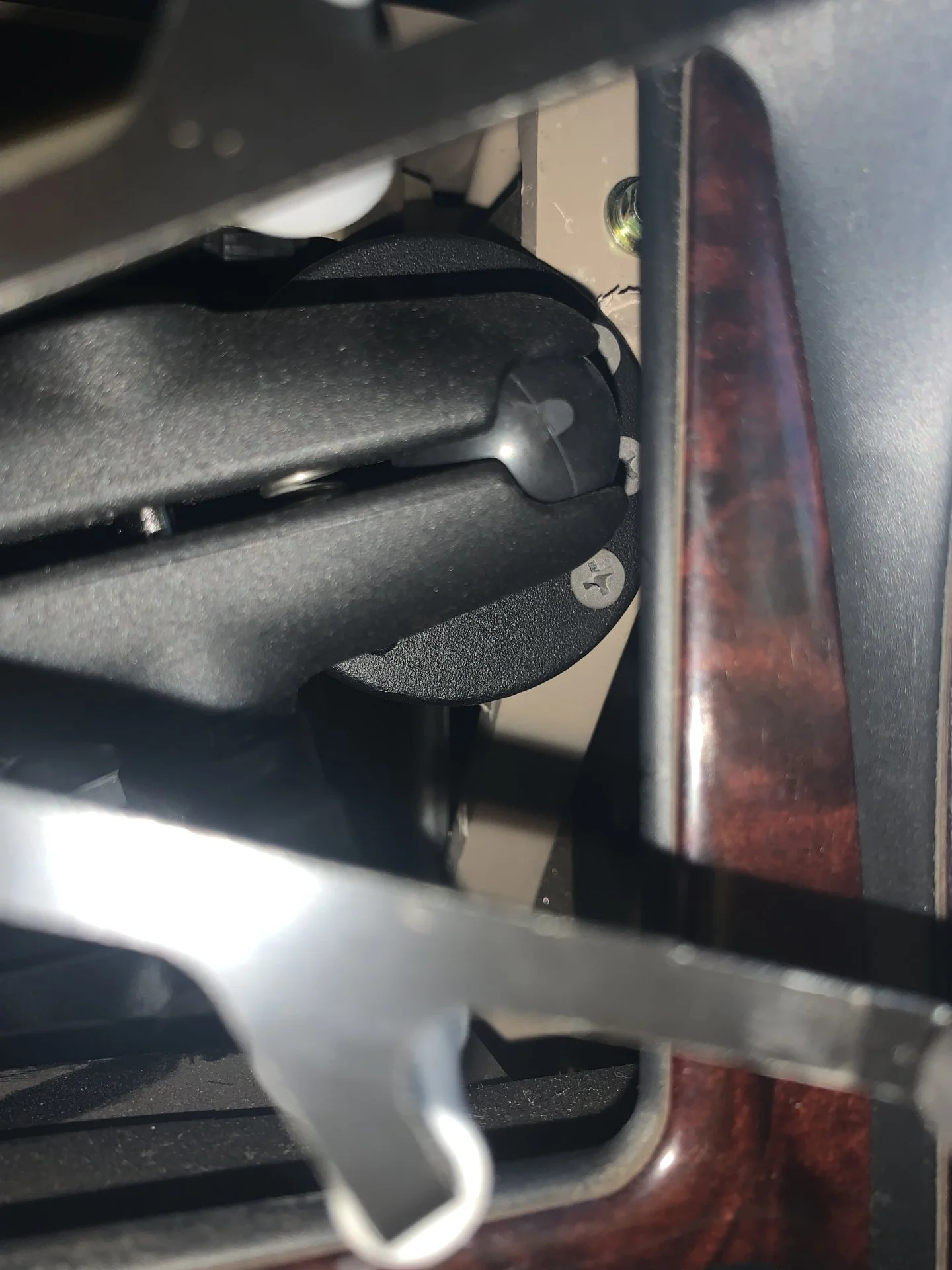

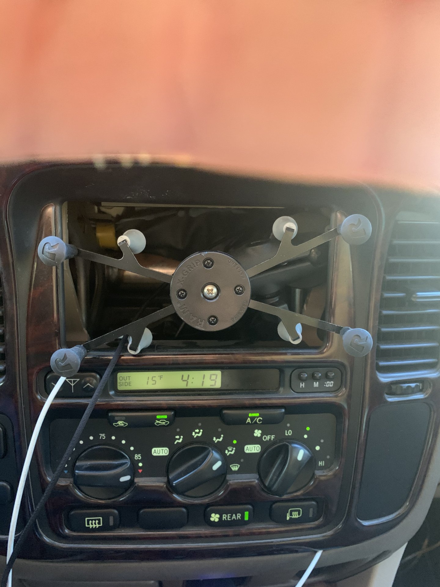

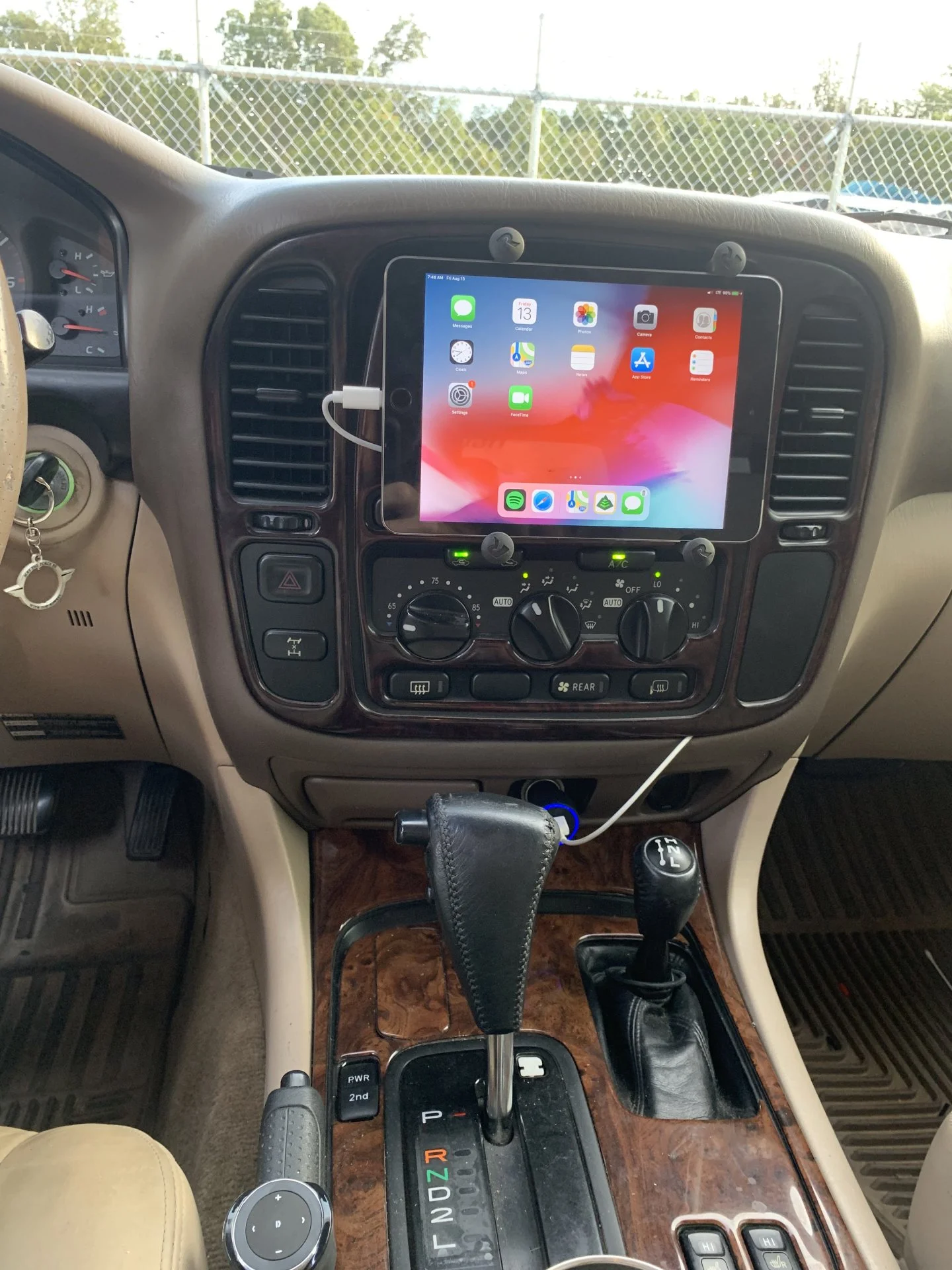

My 2000.. stupid simple. I stream everything so no worry about radio with me. Cellular iPad.
Ram mount, factory amp replacement, rca to lightning adapter, rca input to amp.
Works pretty darn well.
Just screwed it to the factory mount. Pretty solid really.
I think total cost with the amp ans buying a used iPad was under $400. Amp was $250 of that.
I really do like the ease of this installation but I have two questions for you.
**First how tall are you?
That will tell me approximately your seating position. I'm 6 ft tall and the top of my head sits approximately two and a half inches away from the ceiling. Being a RAM mount I'm sure you have tons of adjustability to get the screen angle satisfactory.
**Second question while driving off-road or rough streets with your mounting point do you get very much bounce or wiggle while driving?
Anytime I've ever mounted something to hold my cell phone or a screen it inevitably wiggles and drives me crazy. Any chance you have a video of you driving off-road?
I’m 5-10.
No problems that I remember about it wiggling. I sold my 100 earlier this year so no more pics or video.
I used to have a video my son took while driving and it was pretty solid, he was more shaky than the mount 😂
That's the same model I've been looking at.
Based on some of the YT install videos, I would have thought it could sit just a little bit higher?
I know you've been asked about it, but have you looked at adjusting it since install?

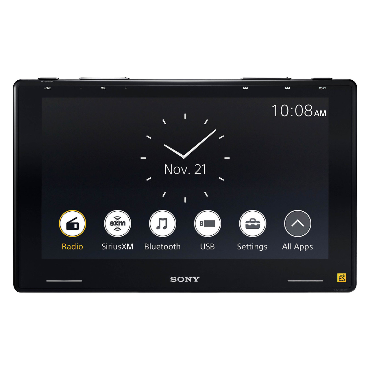

I thought I'd revisit this thread with Black Friday sales coming up.
So I'm trying to figure out which floating display to go with the Focal components in the LC; Alpine, Pioneer, Sony, or Kenwood.
I used to be a big Kenwood fan, then they got bought by JVC and their quality really dropped. But understand they're much improved.
I have a tablet for off-road trails using Gaia, but I'm thinking a floating display with all the audiophile bells and whistles and CarPlay would serve both purposes.
Right now I'm sort of leaning towards Sony's XAV-9500ES.
Any recommendations or experiences are appreciated!

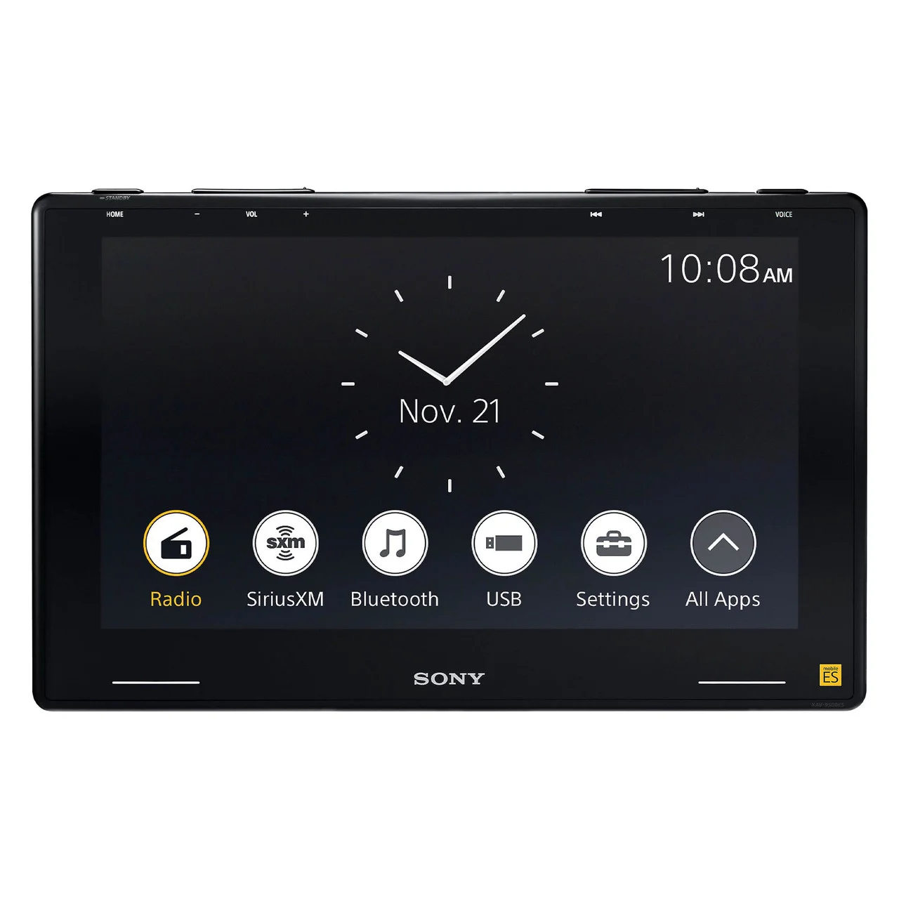

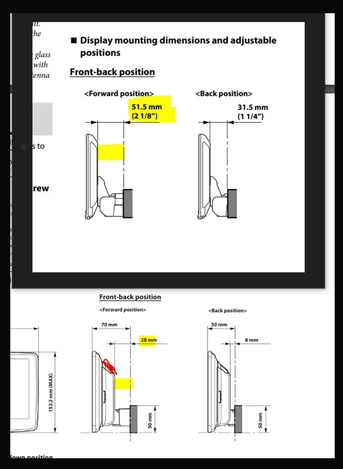

There is someone on here that installed an older Alpine floating head unit and he had to cut out part of his bezel to make it fit which wasn't something I was willing to do. But the newer version of that headunit should fit. I'll see if I can find the conversation...
So it was the ILX-F509 someone installed and it looks like it fit. The issue with the older Alpine floating screens is that the screen is too thick, like an old computer monitor. The newer ones are much thinner and thus seem to clear the bezel much better.
That's a big help @shtbrwn86! Thanks for that.
I was wondering if it was simply how far out the screen extended and if it was past the top of the dash in the '99 LC.
From what I remember he wanted to install the stereo, put the trim back, then attach the screen but it didn’t clear. He had to attach the screen and then slide the trim around the screen and when he did that the screen was too big to fit through the opening. This is from our chat…
Howdy - when I bought the unit I thought I'd be able to install the single DIN unit, put the dash back together, then attach the screen. Unfortunately, you have to attach the screen before installing the unit and THEN putting the dash back on. The screen won't fit through the regular space in the dash, so I had to cut a chunk out of the top to get the dash around it. See below in red, I had to cut out a piece about that size.
With the unit installed you can't see the cut in the dash at all from any angle. But would be problematic if you/next owner ever wanted to downgrade to a different unit without the floating screen.
