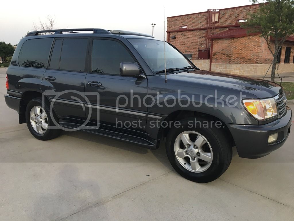

My ‘04 has 133k miles on it’s a little hard to handle on the highway. It’s not scary feeling- you just have to be constantly “micro-correct”. I guess another way of saying: it doesn’t track well. Maybe this is typical. It just doesn’t inspire a ton of confidence for a long, fatiguing road trip.
I don’t know where to start - from a diagnostic standpoint.
My Cruiser isn’t totally stock. If you care to read my mild build/repair up story, here it is:
It has 285 75 17s on it and maybe that’s the simplest explanation.
I’ve also experienced a minor steering rack leak but it’s just weeping a bit from the driver side boot. I would think major steering rack issues might cause this kind of thing.
I’ve cranked the torsion bars to level it out some but still have some rake. It’s been aligned since.
Any specific thoughts or places you guys would start?
Pic
Vehicle looks like it doesn’t have very much front to rear rake (front lower rebates more castor angle this in turn increases the self centering force on the steering).
I’d try adjusting the torsion Basra for 1 “ less ride height in the front, checking proper tire inflation, followed by an alignment.
I'd start at the torsion bars. These seem to need a bit of rake to drive and steer properly. Or said differently, you shouldn't have to micromanage the steering inputs.
Measuring the droop is a good spot to start. Measure hub to fender on both sides, then do it again with the wheels off the ground. You should see 2" (or more) of droop. If not, the bars are cranked too much.
Edit. @Octous beat me to it.
What are your hub to fender measurements front and back? Your front looks like it may be 21"+ and if you go that high it just doesn't drive well. I run mine that high and I get alot of torque steer, even with a set of UCAs designed to correct castor. Mine is really just an offroad rig so I don't worry about it much.
Also, don't count out the possibility that is Ball Joints, tie rods, rack, ect. Lastly, shot bushings in your REAR control arms and panhard can cause floatiness on the highway. I know mine are all shot and need to be replaced.

For all that read this - I have a resolution.
I heeded the above advice and approached it from several different angles.
First, I checked my air pressure. It was sitting at around 35 psi all the way around. I bumped that up to 45psi and it helped somewhat.
Second, I "uncranked" my torsion bars three full rotations on each side. This helped quite a bit. I don't notice any rubbing, either.
Last, I went and had it aligned.
Together, these three things, essentially, eliminated my problem. It drives great now and barely wanders at all.
Just for grins, I flushed my PS fluid for the second time in a year. I don't know if that will help at all but the fluid that came out (along with the ATP205 to help with my weeping DS boot) looked and smelled awful. I'm going to keep an eye on the level. It's never leaked enough to register "low" on the reservoir. I just see wetness on the bottom of the drivers side boot. Oh, also, went ahead and rotated my tires but that shouldn't have any effect.
Thanks to all that chimed in!
