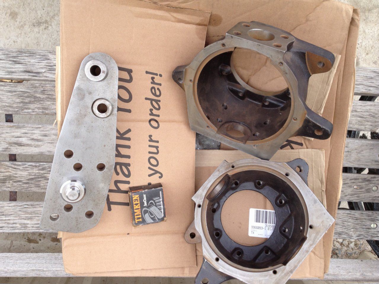

1. HF Knuckles with 80 TREs.
2. Hydro assist (can finally do if tie rod is on the front, as planned, and box is ported for)
3. Raise the front pan hard at axle to match new drag link angle.
4. Raise rear pan hard at axle to match front pan hard angle.
5. Raise front and rear upper coil and shock to lower to 4".
6. Cut and turn for caster correction.
7. Now this is where debate should abound.
Opposed to a conventional 3 link, thinking of modifying the DS arm mount, effectively rotating it to the back side of the housing, in a vertical orientation.
The arm currently attaches to a plate that is captured at the front of the DS mount, but the arm only connects in a vertical manner. Pic of joint to follow, but all I'm proposing is doing away with the goofy plate.
8. Sway bars that function.
9. Remove any sheet metal that may contact tires at lessened elevation. Won't be much, as there's no rubbing, due to coil bind (have no bump drops), currently.
What I believe I'll accomplish, based on what y'all are saying is, correcting body roll, correcting bump steer, ( for lack of better term) correcting caster, gaining hydro assist, and it all appearing that it was meant to be that way, by eliminating unnecessary bracketry on the axle housing.
Looks matter :flipoff2: as this would be the final polishing to establish permanent finish of the turd.
Detractors?
I'm all eyes.
Already bought knuckles, ready to round up the rest as determine how I'm gonna go about implementing.

Gonna jack this thread further:
So, I'm readying to tear my chit apart to correct the undesirable mannerisms and handling characteristics, all while fixing the lift issues I don't care for, due to those traits.
Since everyone's so comfy and fuzzy in the thread, no better place, since now is the time to 3 link, if what I'm suggesting is ludicrous.
Detractors?
I'm all eyes.
