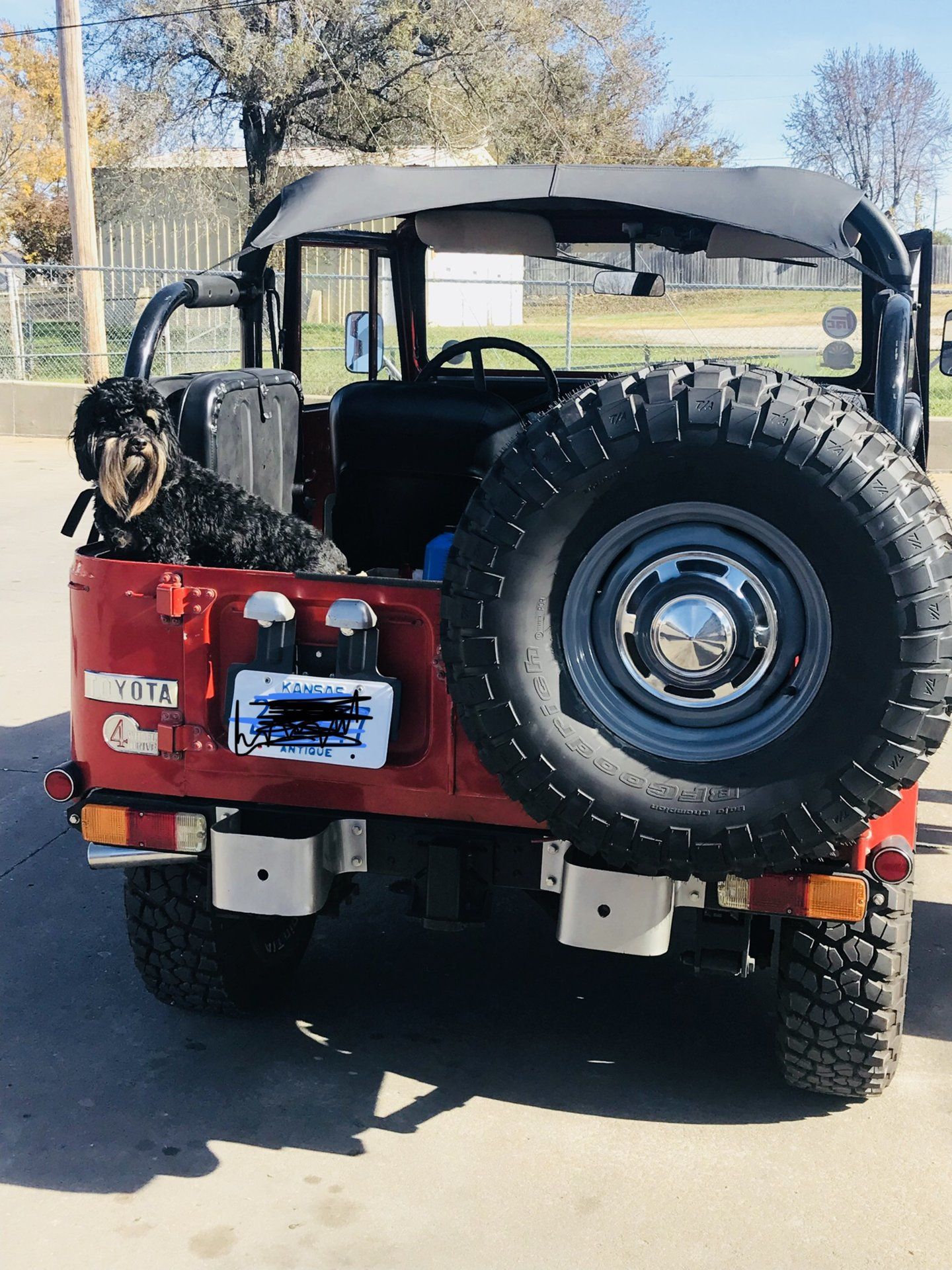

Picked up the 40 today. Put my doors on. Holding out as long as I can for the top. Check out that dry garage floor :clap:
