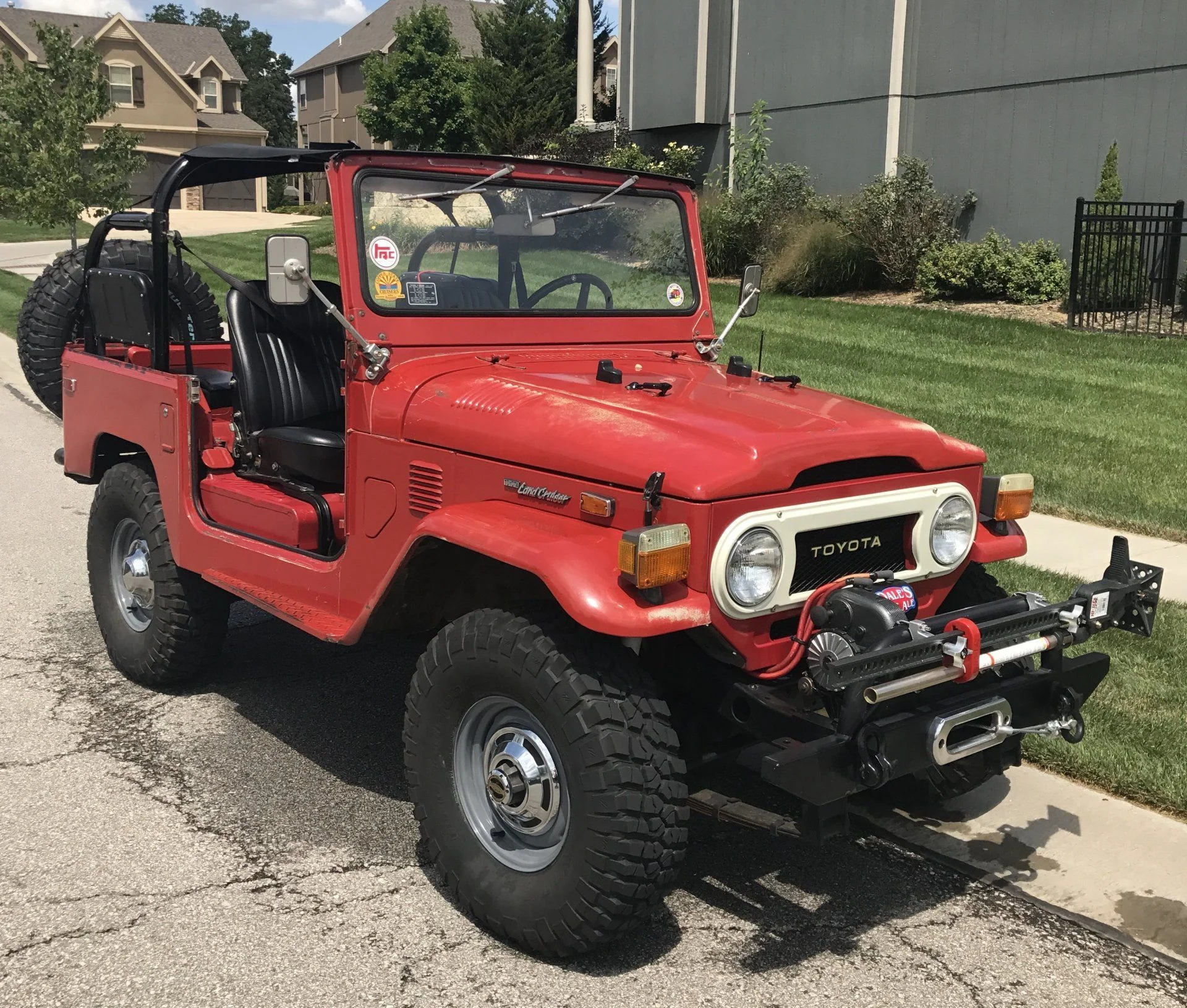

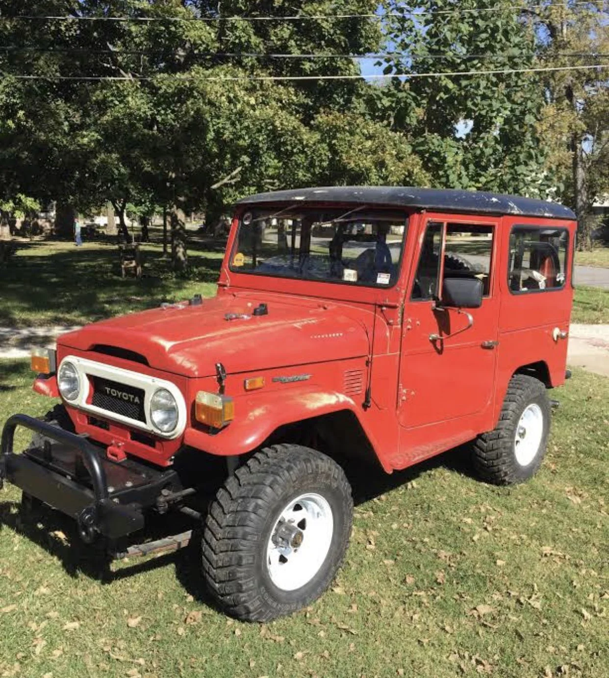

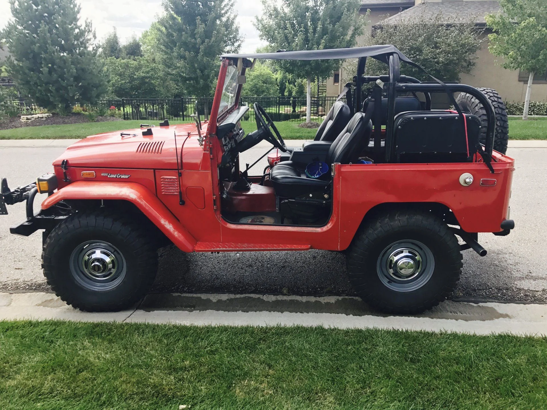

The one pic is interesting! I see a bottle jack as wheel chalk and a mysterious stream of oil under the front end haha. Im sure it was there before
Bottle jack, yes. Stream of oil, no; it's tar on the pavement...she does leak a bit of tranny fluid, at this point it's only a few drops :hillbilly:
Show me a cruiser that doesnt leak awesomeness lol
I have a couple drips that pop up. Front knuckle leakedin the winter so i swapped out the fluid in the diffs and its been bone dry since haha. Im afraid its only a temp solution...

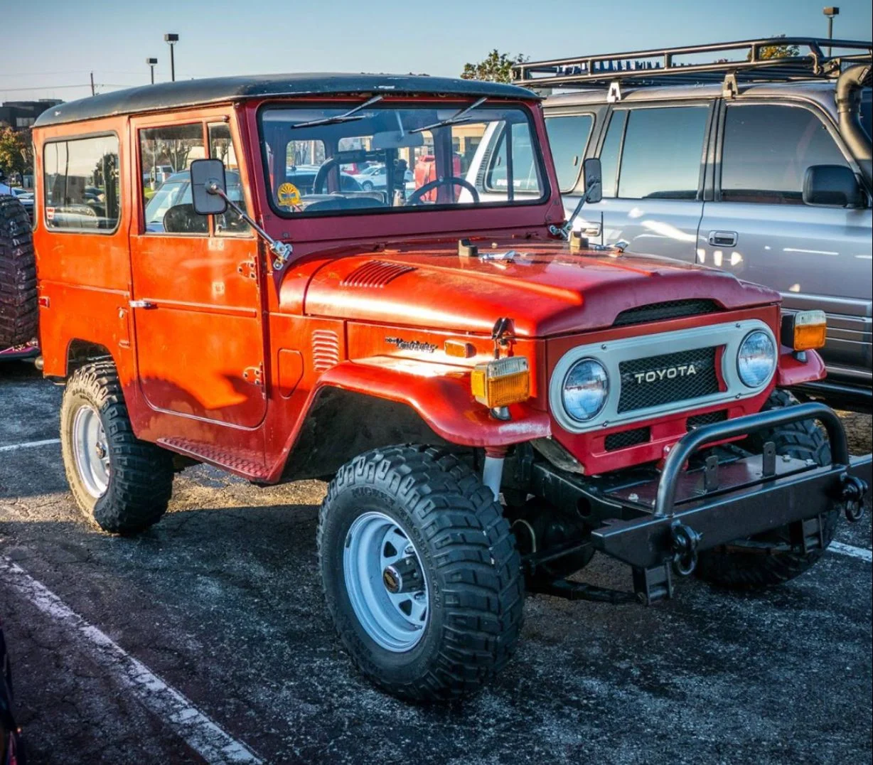

Wow.. mine is really close to yours

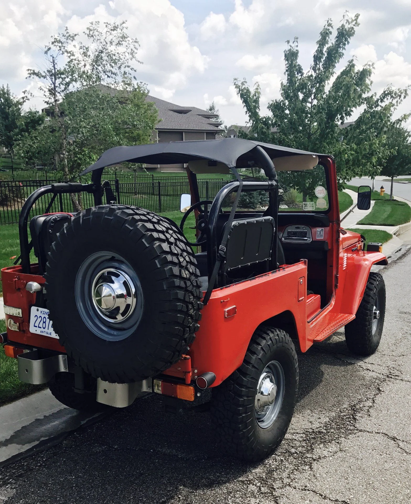

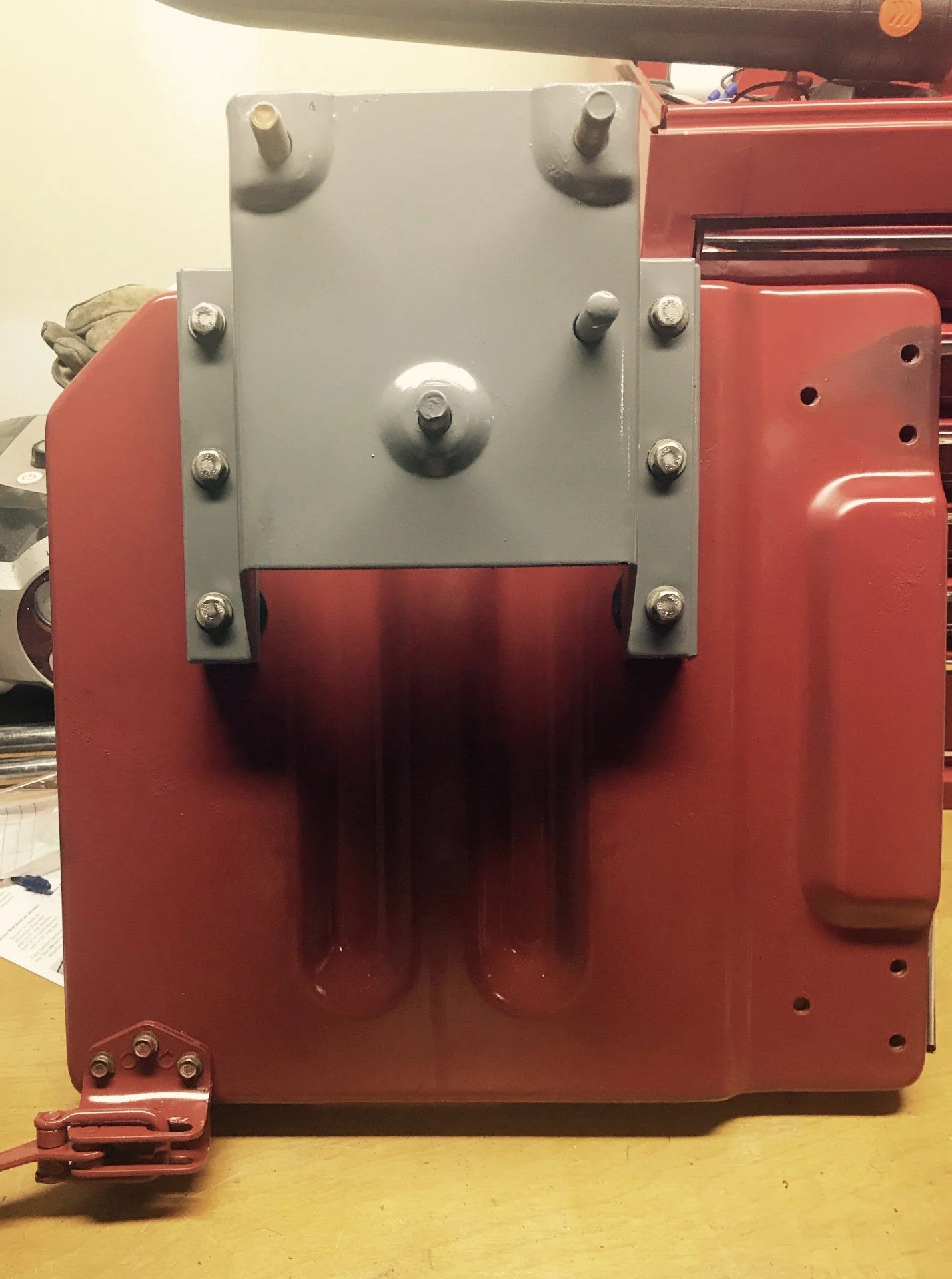

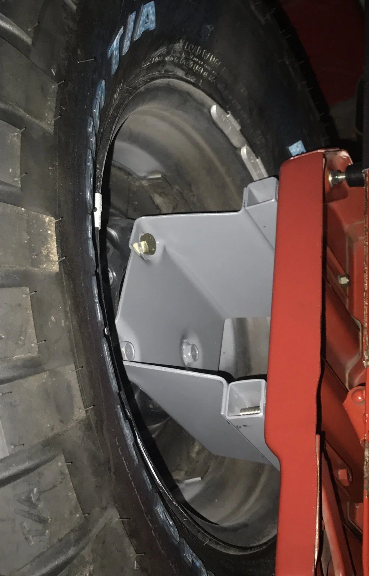

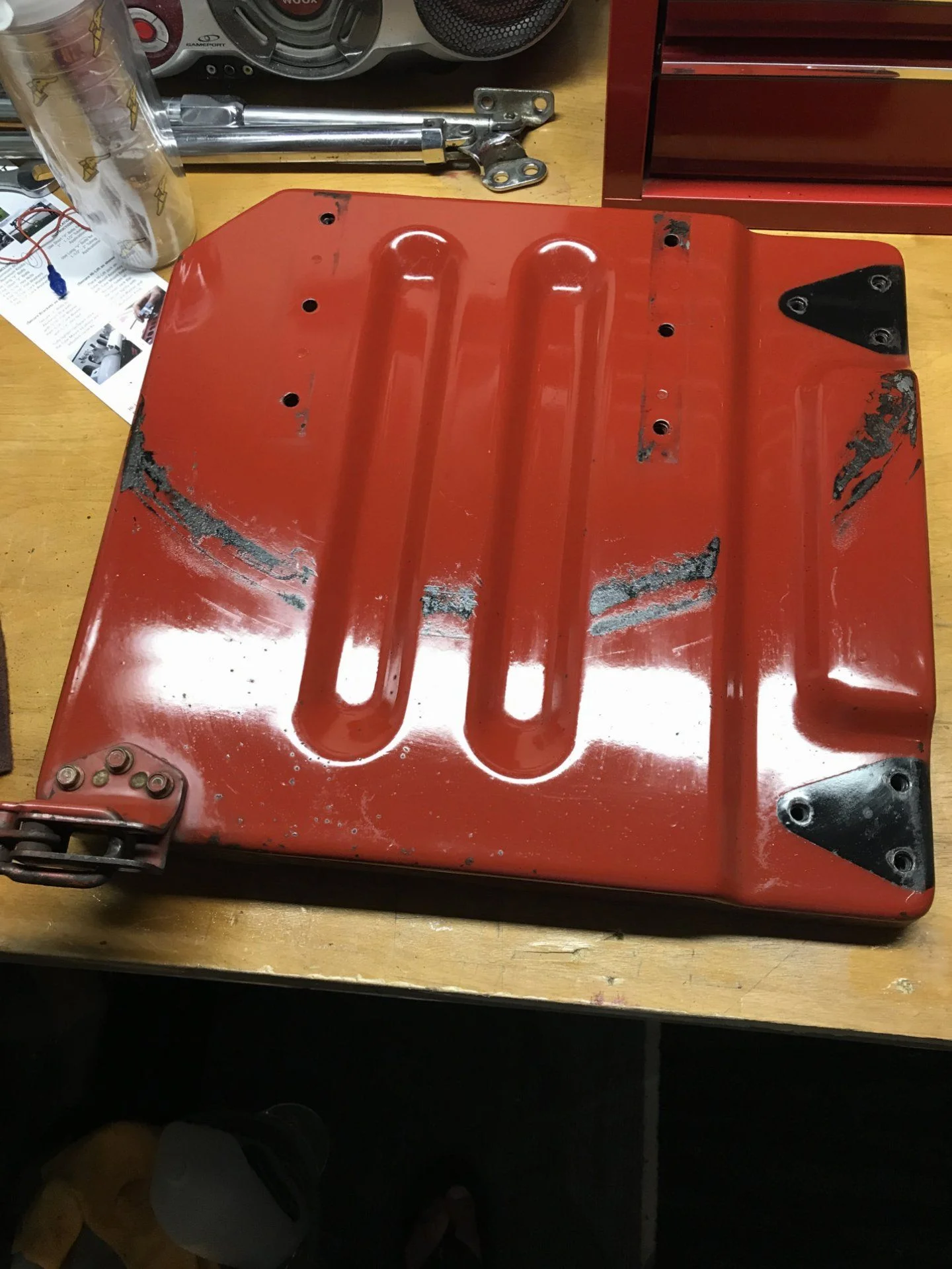

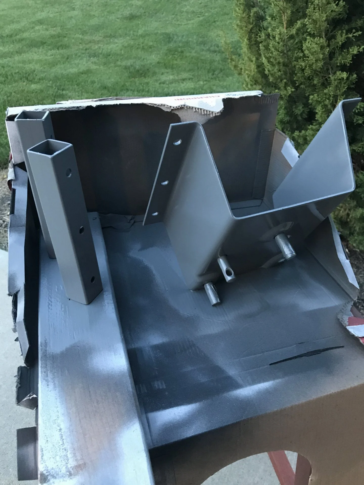

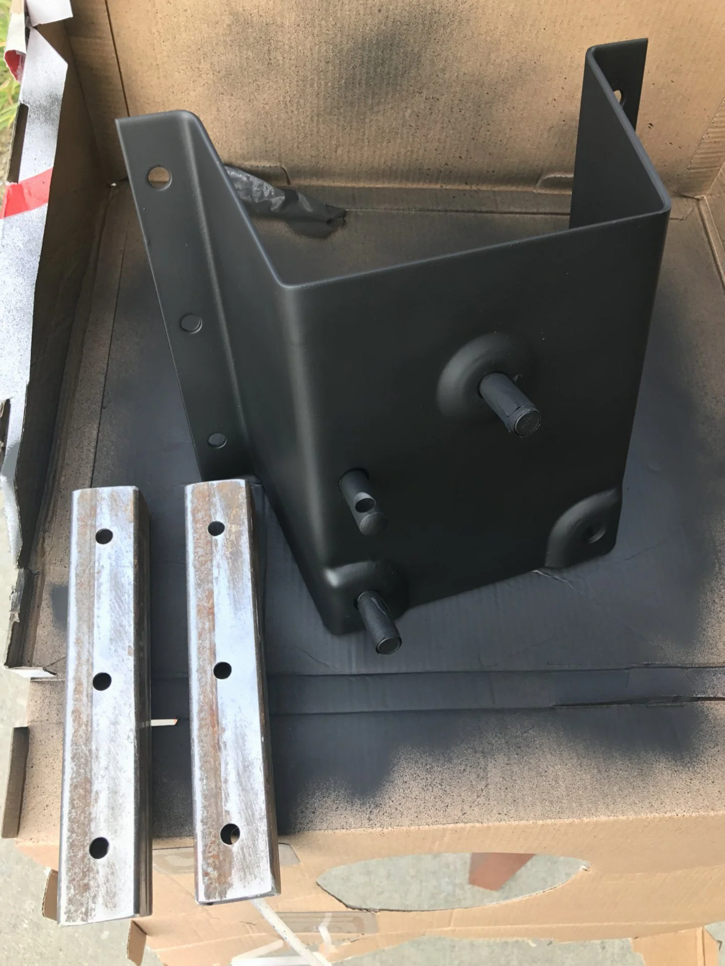

Spend a little time on the 40 today. Subject: spare tire carrier. The 10.50" wide tire has been rubbing. Made some spacers to address that. Cleaned and painted the mount. PO had 2 cans of cruiser silver but they must be too old. Wouldn't spray. Decided to use the same color I painted my wheels, Machinery Gray.
Ended up taking the door off and cleaning it. There's some surface rust where the tire has been rubbing. Going to sand down and hit with rust Doc them match freeborn red.

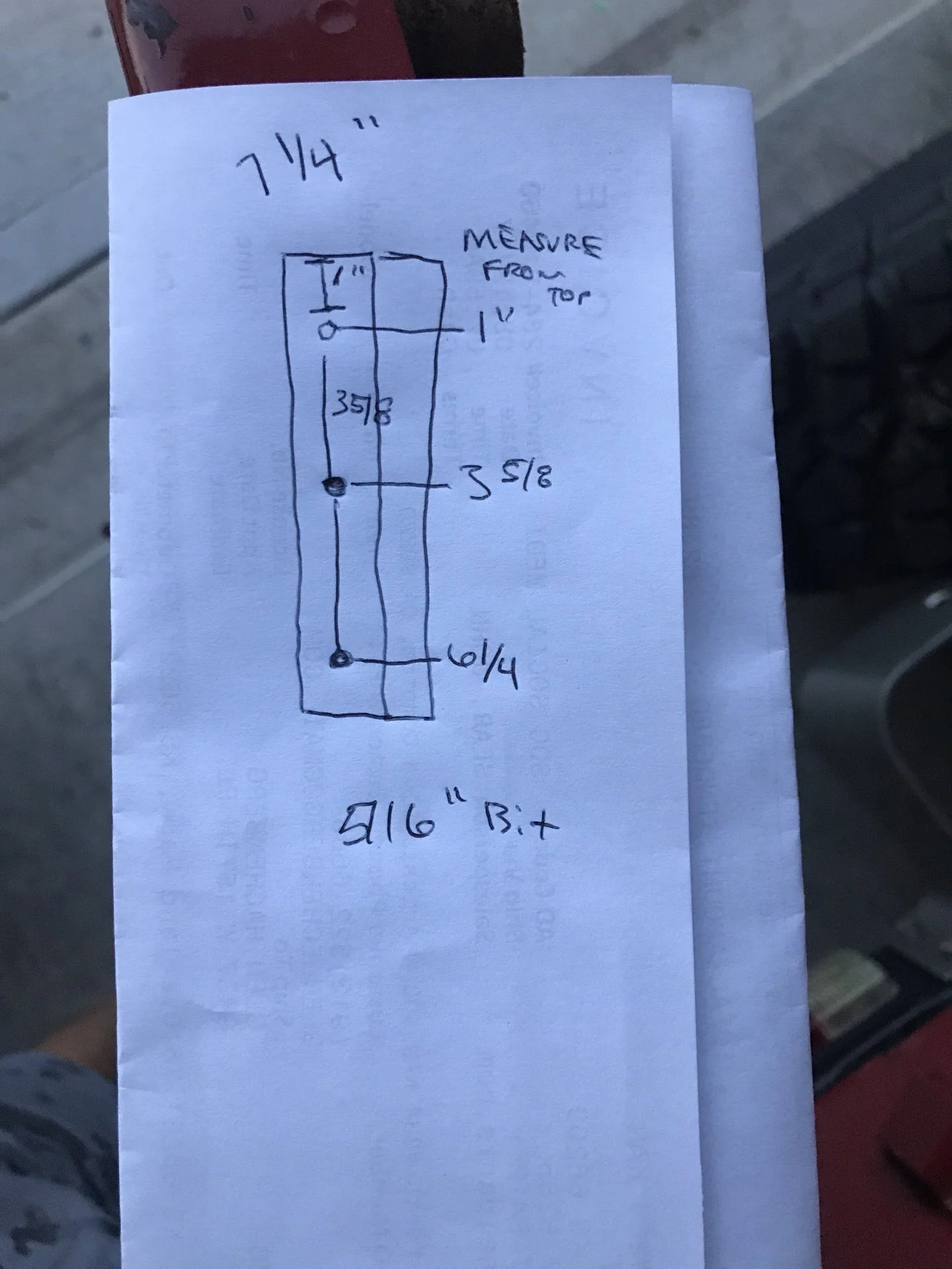

I attached the spacer measurements in case anyone needs reference.

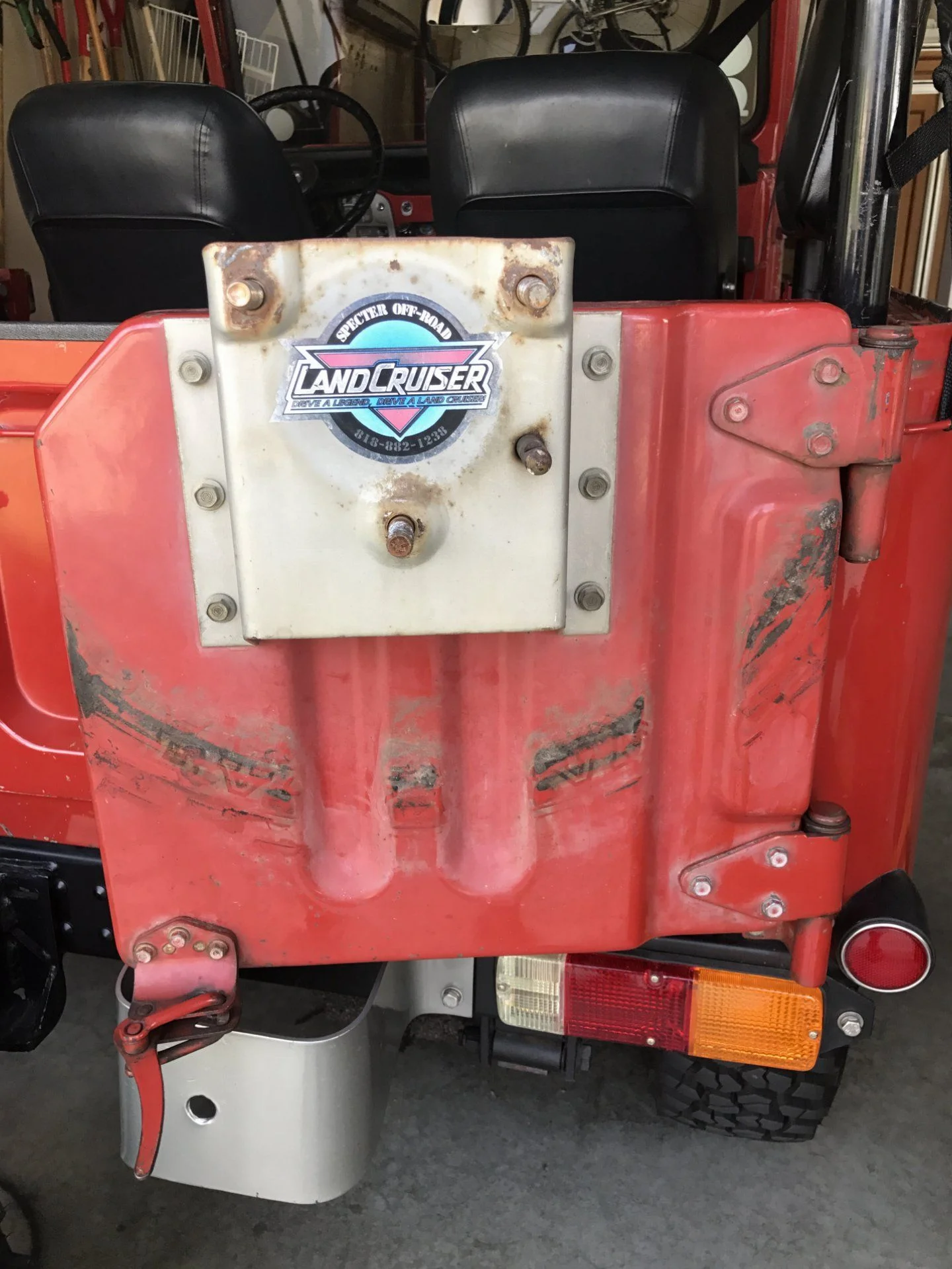

All back together. Used the $2.50 part from Ace Hardware for the upper cushion @ginmtb :)
Had I known I had extras could've sent one to you! I'm going to also install little black plastic caps on my spacers. Will help keep water out of them and finish it off nicely.
Looking good!

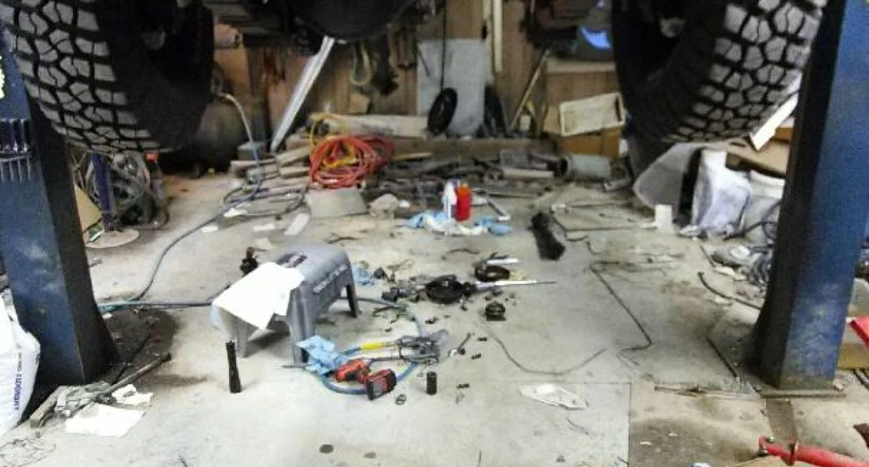

1 yr anniversary of 40 ownership...She’s come a long way. Dropped her off at the spa for her birthday with plans to address the leaking undercarriage. When the PO rebuilt the tranny they neglected to address the original output seal (so I was told). We shall see...
Of course pictures from 1 year ago and current.

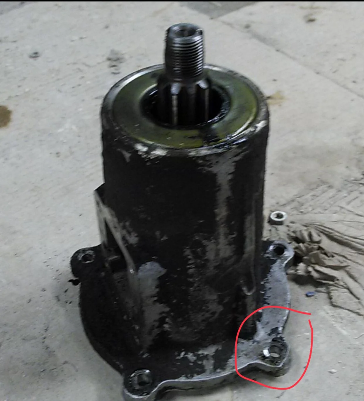

Clutch master leaking and slave cylinder is bad. OE replacement on the way. Found 4 leaks underneath. It appears whatever the PO hit resulting in the damage to my front & rear fender snagged the front output shaft cone crushing one of the bolts. Surprisingly, there aren’t any cracks in the nose cone. New seal and gaskets installed and that leak is fixed.
