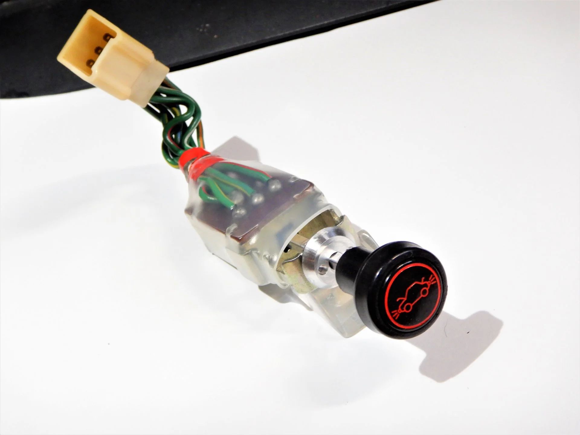

its a grounding issue finding a path THU your hazard switch or a bad hazard switch circuit most likely

I completely agree that the issue is not @Racer65 's LED headlights. They worked great. I did order his upgraded Halogen kit and it arrived today and I installed it.
Before I did that though- I reinstalled my original lights as I had not checked my hazard switch. With original lights installed- the hazards are not functioning, but everything else functioned as it should. Then I checked with the LED's installed and still the hazards did not work.
After installing the upgraded Halogen kit-
In low beam postion- left turn signal- left indicator blinks and right indicator light is dim and blinks.
right turn signal- right indicator blinks and left indicator light is dim and blinks.
In high beam positon- left turn signal- right indicator light blinks
- right turn signal- left indicator light blinks
With original lights- no issues other than hazard not working
But then this happened- took it for a drive tonight- In low beam position- when I moved the blinker to left turn - the headlights started to flash. It happened a couple a times as I drove around the neighborhood, but not every time. Then the kicker- as I pulled into the driveway, I thought I would try the hazards again. When I pulled the switch - it turned on the headlight high beams. Turned off the switch- back to low beam. Tried it again- nothing.
So- who the f&&k knows. I went with the halogens- to keep it simple ,not spend a lot of money and to not chase gremlins. But, I guess it is time to chase gremlins as this is my everyday driver and not something that I would have to just occasionally deal with.
I am going to pull the hazard switch and clean some contacts and maybe order a new turn signal assembly.:bang::bang::bang::bang::bang:

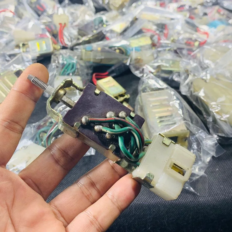

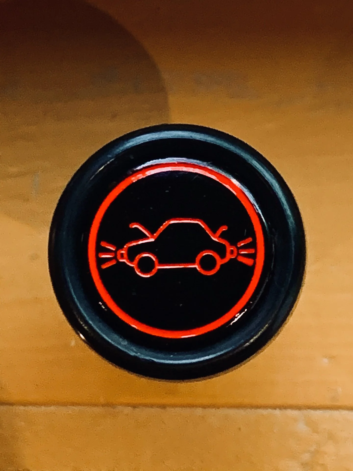

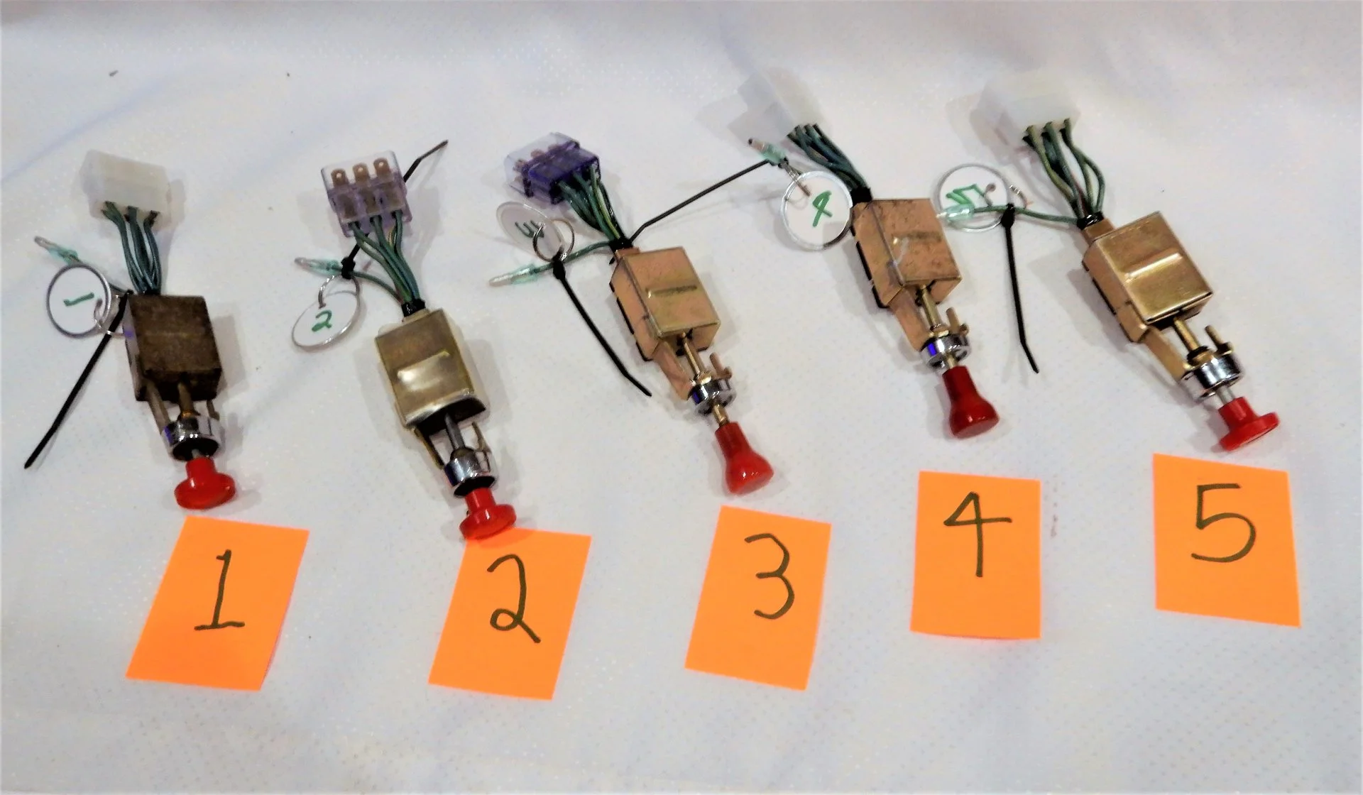

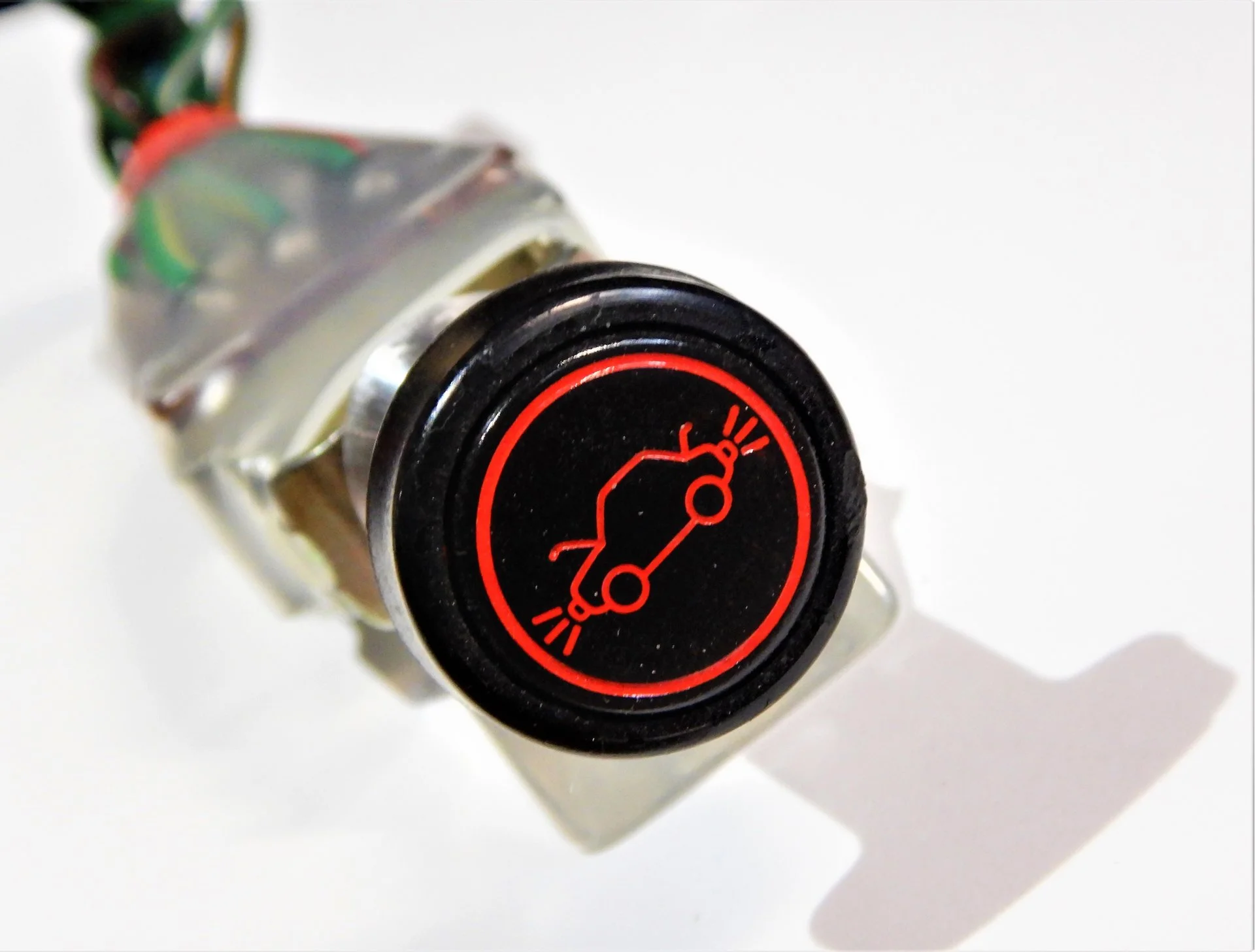

Mine is the solid red button early
1964 to 6/70 FJ40, FJ55​
version you have on your site.
well that's a intriguing fact and even more likely the first GEN, 6 wire and 1 single Bullet Connector style / era HAZARD switch is at the center of this Teq mystery ..........

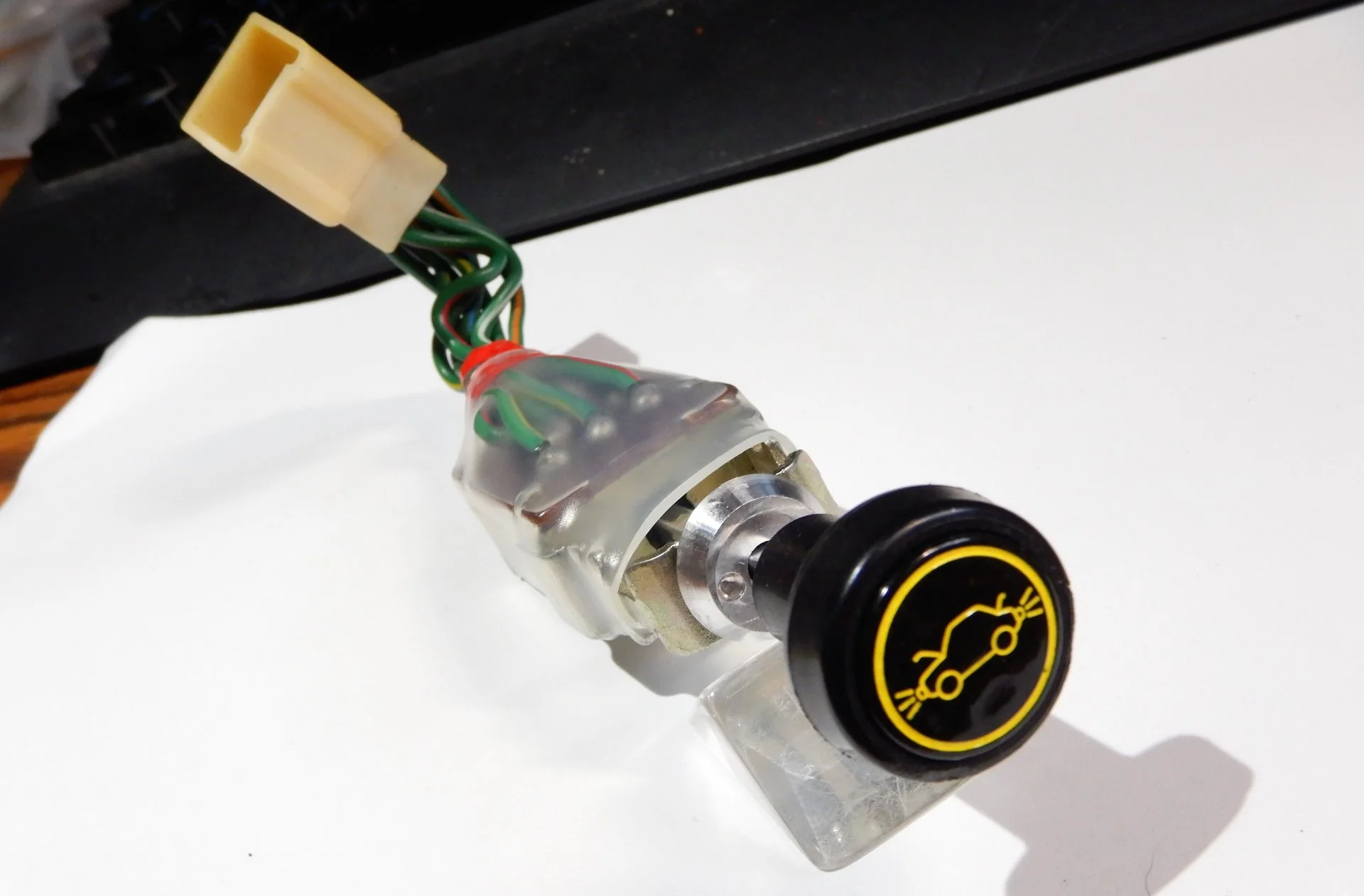

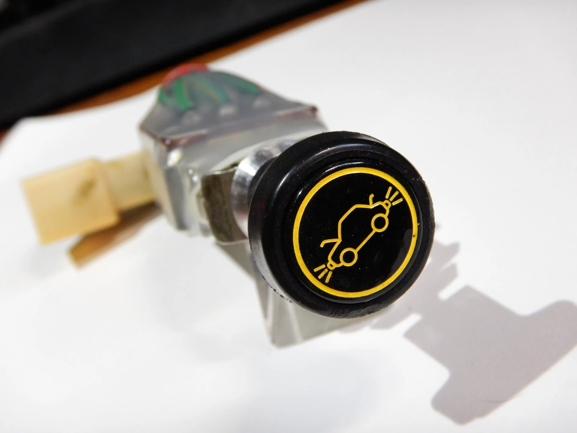

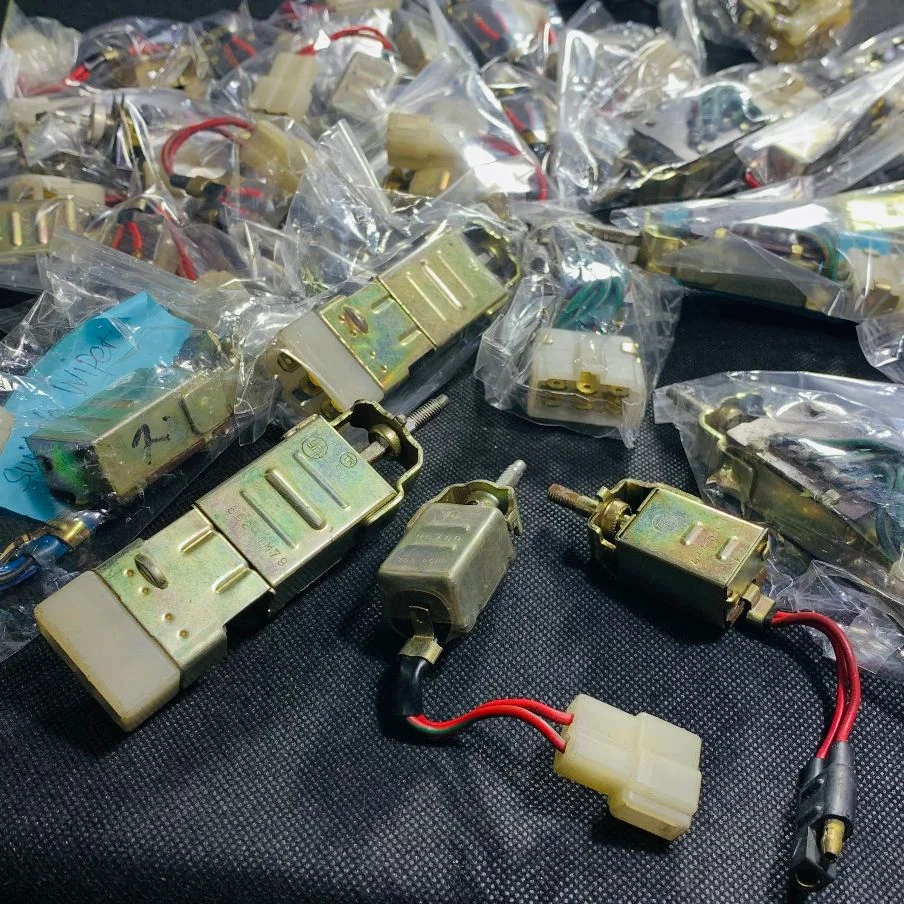

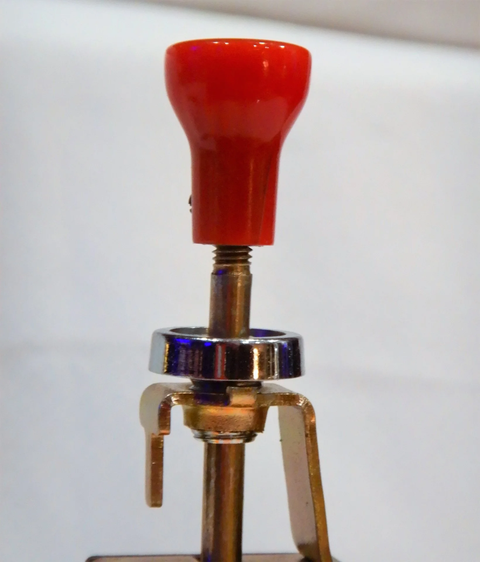

@ToyotaMatt Took apart the hazard switch- cleaned the old grease. Polished all the brass parts in side- added a bit of dielectric grease - put it back together and I now have functioning hazard lights. Will test tonight in the dark to see how everything else works. Still in the high beam position- opposite indicator turn signal lights flash.
like i said ,
i got your back 100% SOLID here , and that's killer kool this was a simple GREMLIN that cost u ZERO Dollars to make right too !
i am making a TECH video on the entire 1st gen hazard switch tonight , for others better understand both its strong points and weak points too

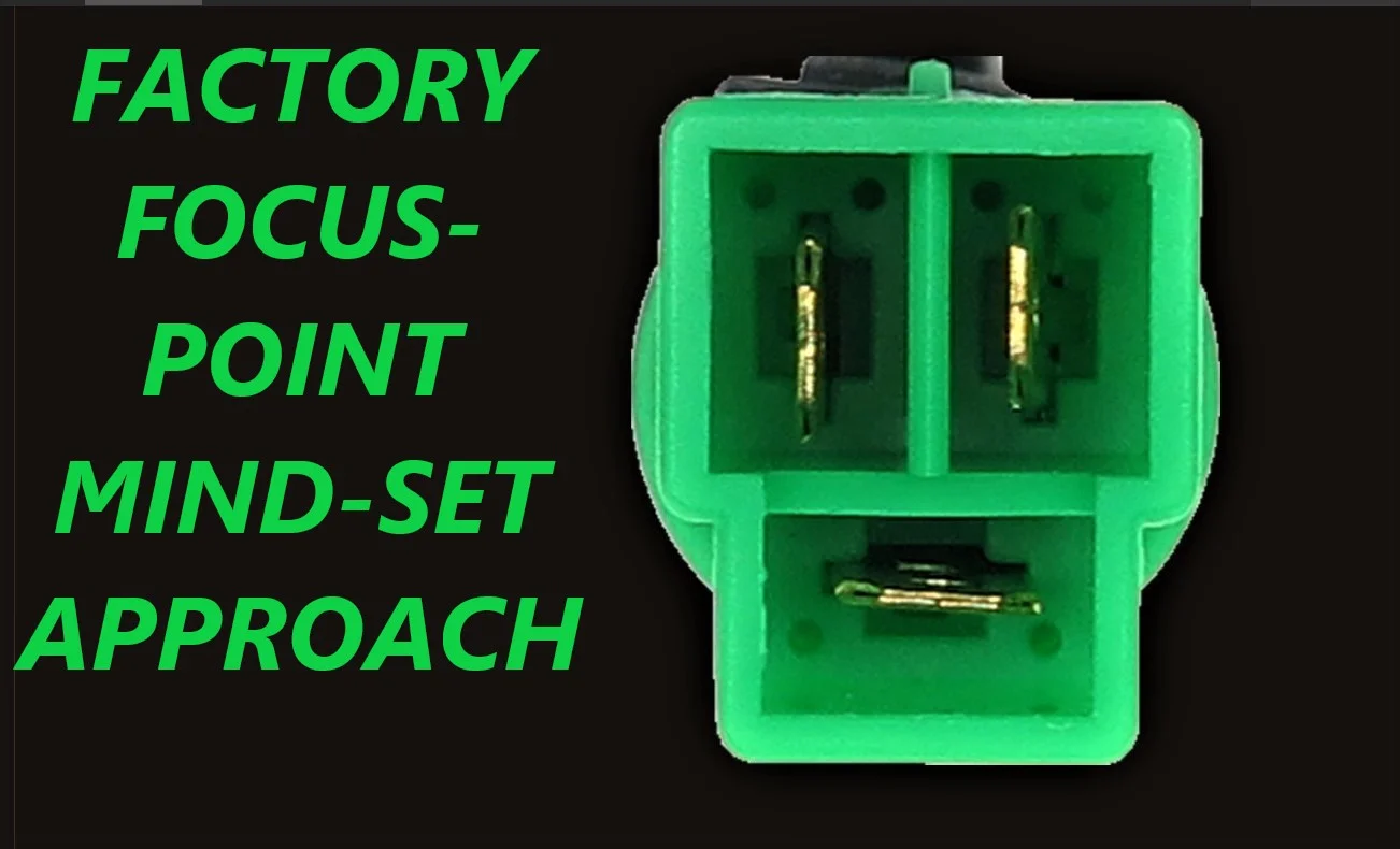

make DAM sure you apply the die electric grease the the 6 pin connector plugs and move in and out several times to help spread the DIELECTRIC LOVE and coat all spade terminals both male and female
using my proscribe TECH above
u can NOT fail !
your now set up for success now so run with it brother
happy to assist as always
kindly
matt :)
