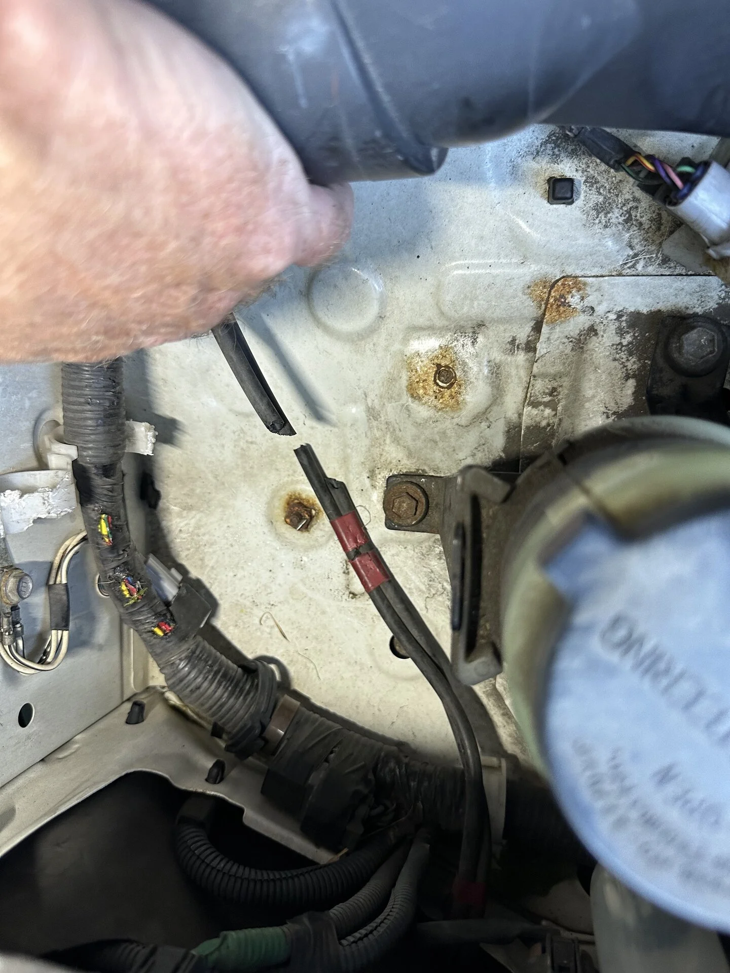

While checking the fuse I noticed some leaves on the other side of the engine compartment under the cover. I popped the cover and found 2 baby squirrels. I gave mom all day yesterday to reclaim them as I left the cover off and the hood up. About an hour ago I relocated the baby squirrels and nest into a near by bush.
After cleaning the rest of the nesting material out I saw that I had some light damage on a wiring harness and there are 2 severed tubes in front of the air box housing. Does anyone know what these tubes are? Are they vacuum tubes or drainage?
Is there anything else I should check regarding the shifter being stuck in PARK?
Thanks!
Derp, the line is my window washing fluid line. Still stumped on being stuck in PARK.

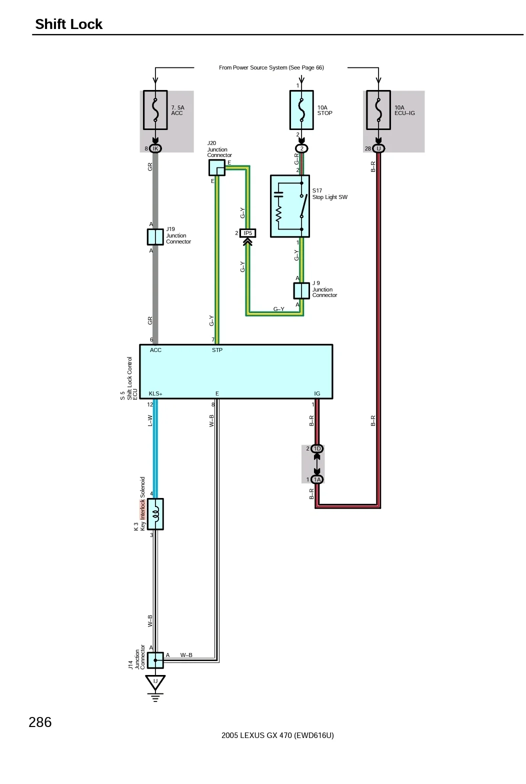

Did you try pushing the button below this cover? If it shift out then something prevent the solenoid from releasing. If it does not it's something mechanical with the shifter.
Yes, I can shift by pushing the button. I was able to put it in neutral and start it which I think should rule out the neutral safety switch or a solenoid, I cant remember which, I watched so many videos lol.
Those tubes are your front & rear washer hoses. The one that goes into the firewall is for the rear. The windshield hose goes into the fender then comes up through the cowl. Mine was chewed through inside near the sub as well.

I forgot to update this thread. So yes, the squirrels chewed very slightly on 2 wires which was enough to not send the signal to the ecm to let the vehicle know that the brake pedal was pressed and to release the shifter. I fixed the wires and it's been fine ever since.
