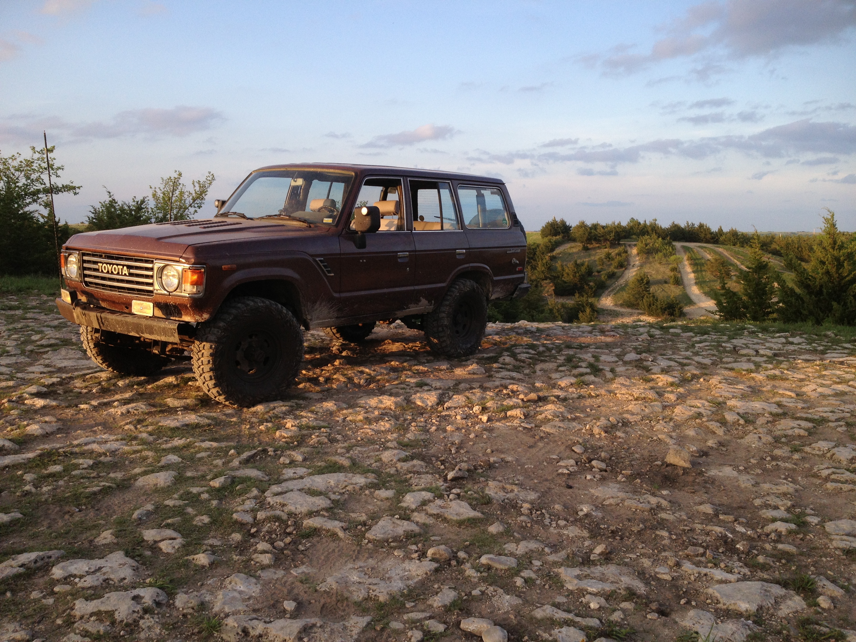

To install I had to drill 4 new holes (3 for mounting and 1 for wires), and grind down alignment bosses and screw mounting surfaces so the mirror would sit flush on the door. The 60 door contour matches the mirror profile perfectly.
Here's a before and after shot.

The install looks almost too simple to be true. How well did the mounting surface mate up with the door sheet metal? Did you have to massage anything?

On installing: I started out trying to modify the door to fit the mirror. I didn't get very far, and decided this is stupid. I just need 3 mounting holes and a center hole for wires. I took off the mirror mount gasket and ground down everything on a bench grinder until the mirror set flush on the door with the gasket on. I also painted the silver a nice flat black (obviously). Popped the glass out and removed the black trim, sanded the nice clear coat over the shiny silver and sprayed it.

Can you give us some more pictures? Possibly with full light and a head-on shot?
