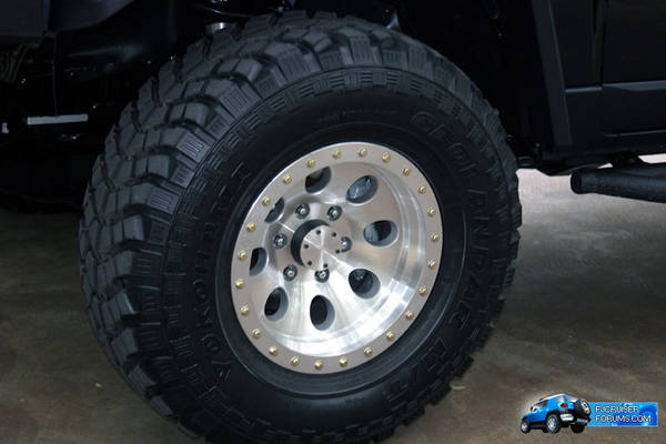

295/70/R17 Toyo open country M/T and I have had no issues whatsoever. Man do I love this tire, quiet on the road for a m/t, and great in the mud. Hope this helps.

I would recommend the body mount chop. If this is done right it has absolutely no impact on the frame strength. You can probable run the 33/12.5/17 Nitto Mud Grapplers on the road with the right offset rim with out cutting the body mounts, but any extreme angles or sharp turns will definitely rub. I am currently running 305/70/17(34x12) maxxis bighorns on the stock rims with 1 inch wheel spaces with the body mount chop, and I have never rubbed. Even with the wheels pressed up into the fenders on some extreme angles. I did the chop myself with a friend that had a welder, but I've seen a lot of people getting it done at local garages for between $100 to $200. I would highly recommend doing it.
I am running GY 285/70R17 on the factory rims with an OME 3" lift with no rub and no body mod. In checking with the crew at Toyota of Dallas who sells the OME kit the issue is more about the width of the tire and not strictly the diameter. If you want to run the factory rims then the 285/70R17 is about as big as you can get without potential issues. If you get aftermarket rims or use backspacing then you can go bigger. The other problem with the width is that a much wider tire on the factory rims starts to rub the upper control arm.

I'm running 305/70 R16's (Yokohama Geolander MT+s) on mine. That's basically a 33 x 12. No rub even at full lock and as much articulation as I've been able to muster.

305-65-17
Just got a set of 305-65-17 BF Goodrich KM2 Muds on my steel wheels and they fit awesome! Ro rubbing and they look terrific. They are actually the same heigth as my BF All Terrain 285-75-16 tires on the factory wheels but they look a lot bigger on due to the way more aggressive tread pattern.
