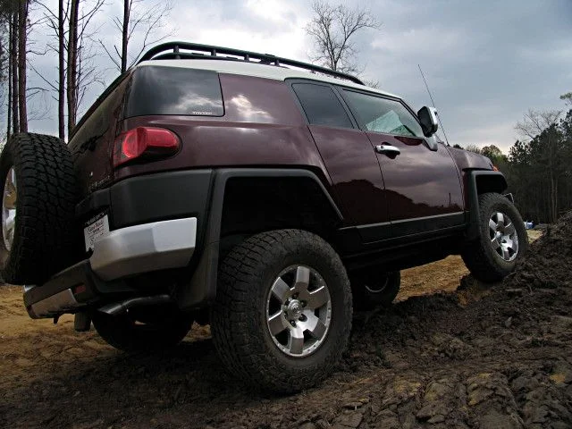

Added ToyTec.com 3" lift with OME springs MED/MED and made a huge difference. No rub at all now and with the much stiffer spring rate the vehicle does not compress enough going into drives or in full turns at good speed to rub. It might if I am wheeling it hard but so far not a touch at all.....
After the suspension settles in some this weekend I will let you know if it changes....huge difference in look and handling and would highly recommend.
So at least on my 08 FJ....I can run full 33inch tires with 3" OME/TOYTEC lift and no body mount chopping. Will still chop to make sure there is no issue at full wheel articulation but does not have to be done this weekend.

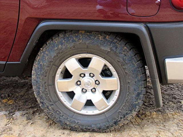

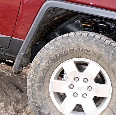

As you see these are on two hills of 20% and 30% grade where I went down and over and around....no rubbing at all. More than hands width between tire and upper fender...almost two for rear...and a good 2 inches left on front tire with it compressed and sitting there with most of front weight on that tire.
So far no rubbing or anything with ToyTeck setup and 33s
I have 295 75 16 on mine with stock wheels. I have a truxx 3" lift. The picks are in my post.The picks are taken with one tire on a hoist at full flex you can see how close the tire is and it does not rub.
It's the total combination
