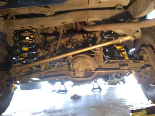

I'm planning on putting a Aussie in my FF rear axle. I have a 91 and had a 94 that i rolled. That's why I swapped the axle before giving the rolled LC away. I went with the stonger axle. I swapped the axle when I lifted the LC. ARB's would be great(the best), but with only on a budget I have to go with the Aussie. Here is a picture of the rear axle with my lift for ref. Good luck!
