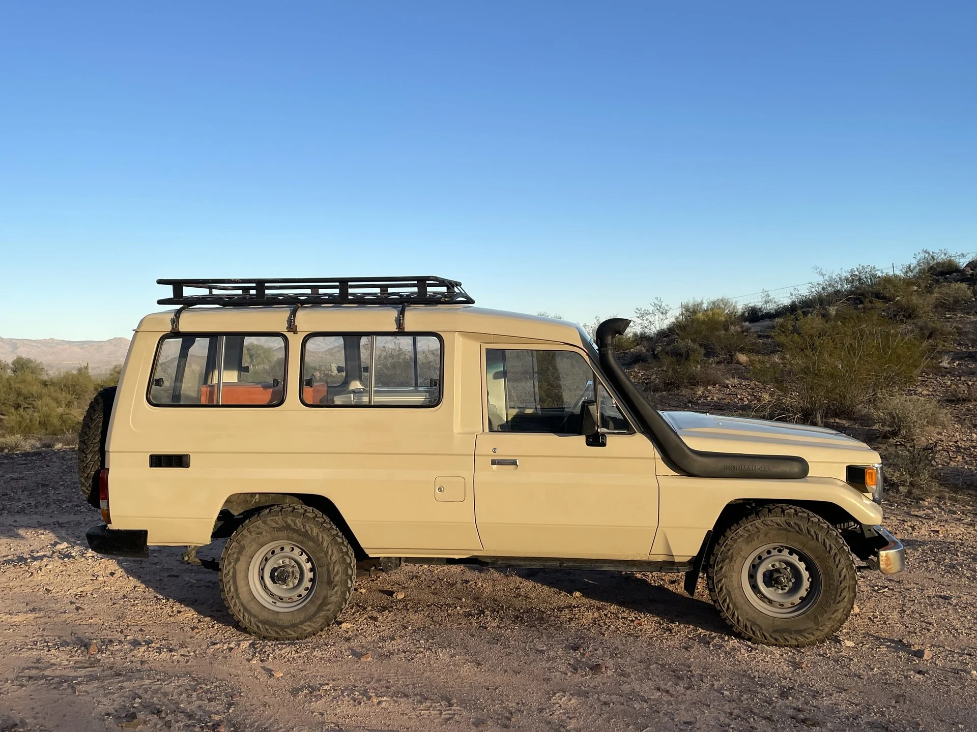

Hi all, I'm so excited to finally make this post!
I am the proud new owner of this 1991 FJ75, which has been loving cared for by the PO, @FJ40|RUNNER
My goal is to spend the next year with grease up to my elbows, learning about this truck and building it out, before departing for the Pan-American Highway at some point in 2024.
I've got a long wish list of projects to tackle:
  • Pop-Top
  • Suspension
  • Rear Windows/Gullwings
  • Interior Build
  • Mechanical Overhaul (mostly to learn about working on this truck)
  • A/C needs to be overhauled
I have been reading all the build threads I can find and learning as much as possible about these vehicles. But am recognizing that I have a long ways to go to really feel competent.
My first question for all the experts here is around brakes for these. I've got the stock setup now, with drums on the rear, and responsiveness + stopping distance leave a lot to be desired. Is there a known upgrade here to improve things?
Looking forward to sharing my own learnings and mistakes with this community! Thanks!
