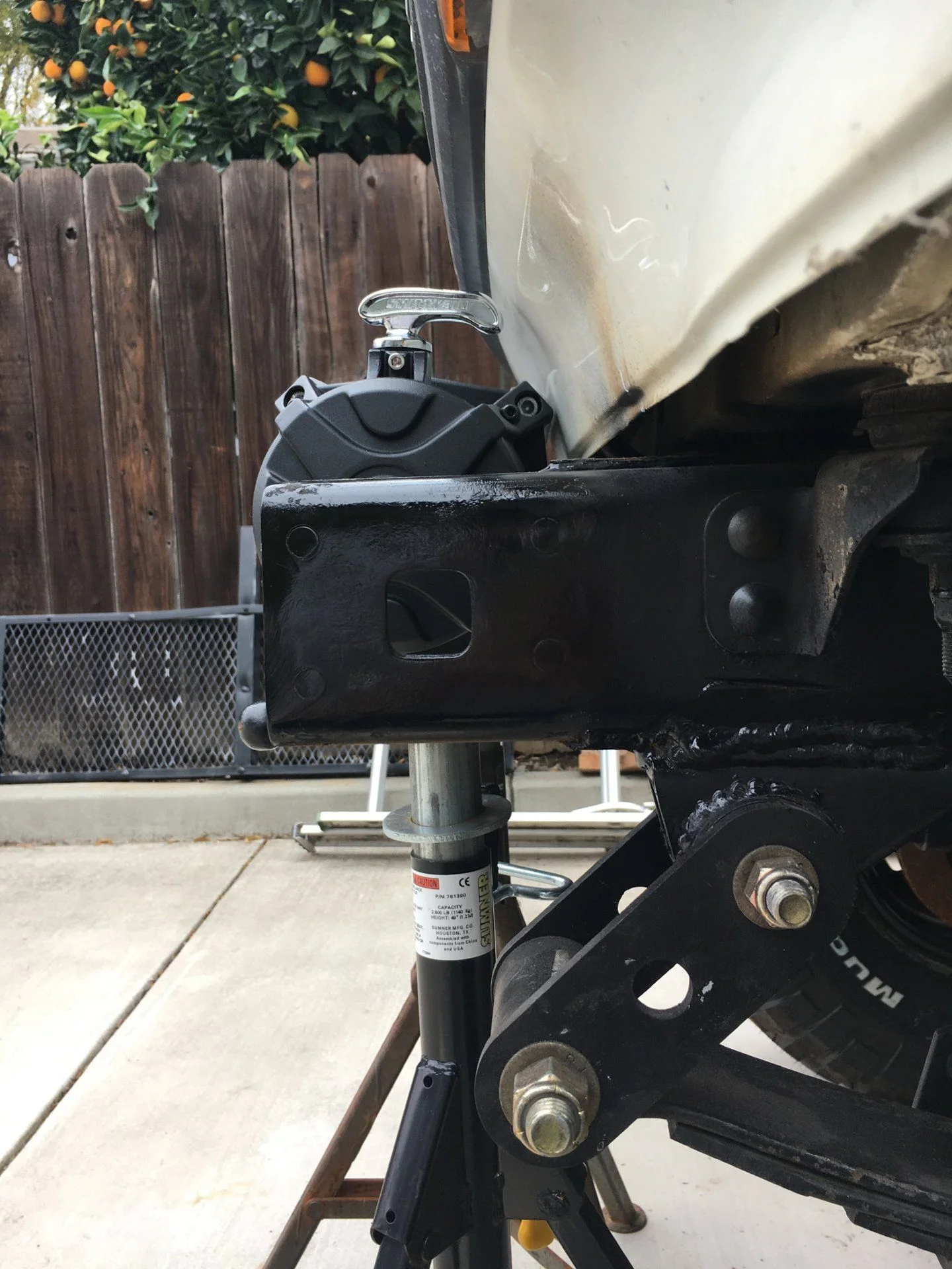

Good evening everyone, after searching, I couldn’t find exactly what I’m looking for.
I want to build a front winch bumper for my FJ62, that has a good approach angle and strength that will be used primarily in snow and rock.
Here is what I’m looking for:
Where is the best place to position the winch?
Most commercial bumpers all seem to position it in front of the frame rails, but above. I figured for strength, wouldn’t it make more sense to build a low profile mount that placed the winch between the frame rails, instead of in front?

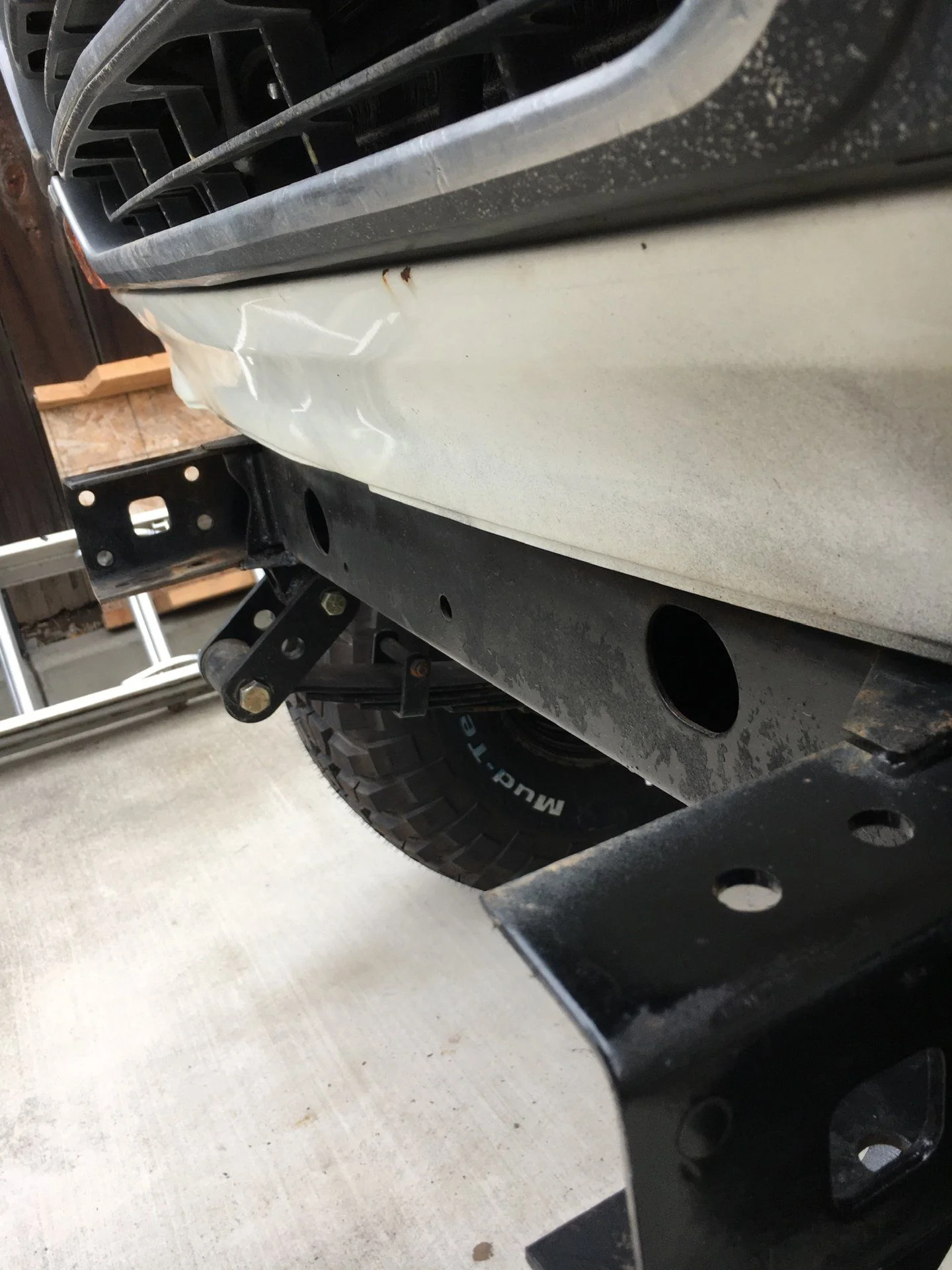

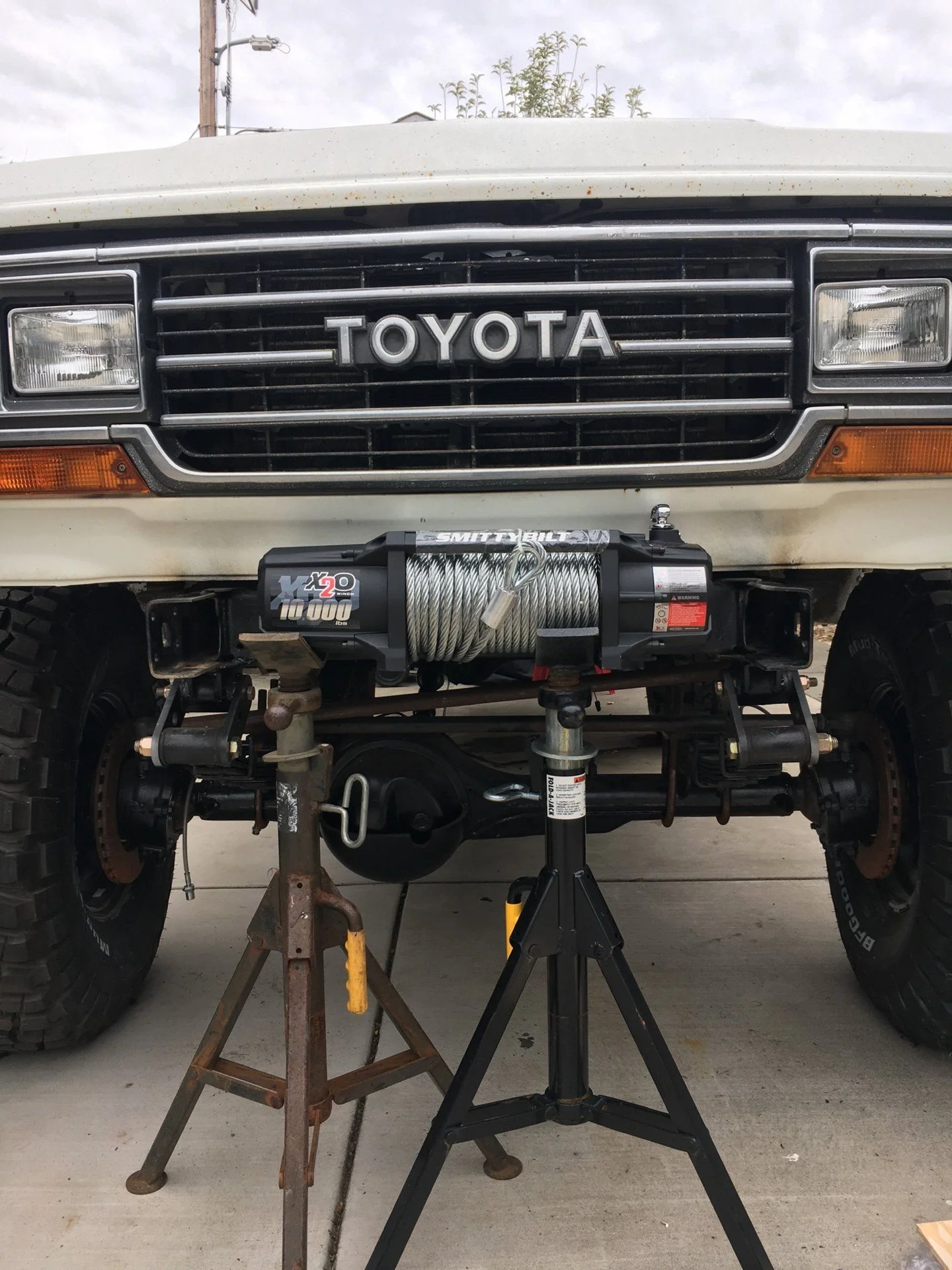

Here are pics of what I mocked up today. Any pictures of the way you mounted a winch/built a bumper in something other than ARB or a stock bumper configuration would be great!
For reference, here is what I’m using for reference. I know this is a Trail Gear, Tacoma bumper, modified by Yota Masters. But note where the winch is positioned, above top of frame rails, and in front.

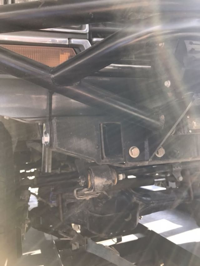

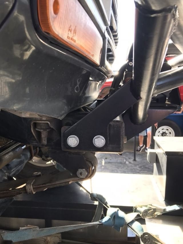

That's where I had mine for while. If cut or loose the valence panel there is nothing under it, tons of room to move it back and up a bit. Is that the winch you're dead seat on using? That control handle being vertical is going to limit you a bit, otherwise I'd go for a winch you can clock the control handle on. There are more pictures in my thread but this is what I did first, and then the second picture is what I have now. I was able to move the winch back about 4". In the current setup the bumper is independent of the winch mount and only adds about 2.5" to the front, but it's higher then the bottom of the front frame rail.

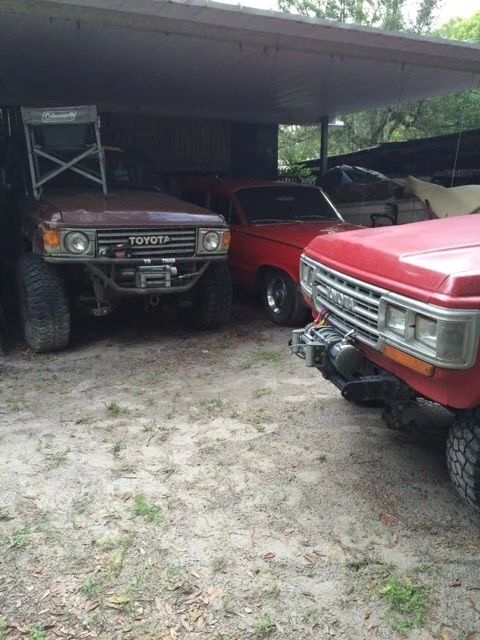

The brown 60 in the third photo is another idea and probably the best for approach but it has a 3" body lift.

@cruisermatt the second photo is a great example of what I’m looking for. Thanks.
I will likely build some more gusseting or steel around it so I can build a tube or plate bumper around it. Ideally something similar to 4x4 labs 80 series bumper.

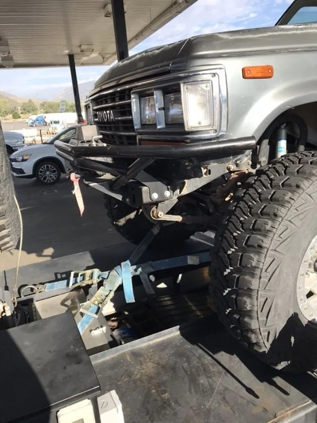

Winch mounts feet first with the 4 bolts through the front of the arb bumper. Two of the bolts also hold your fairlead. In this picture I am in the truck waiting for the little kids to stop laughing and tell me how to get out of the messed up line I took.
