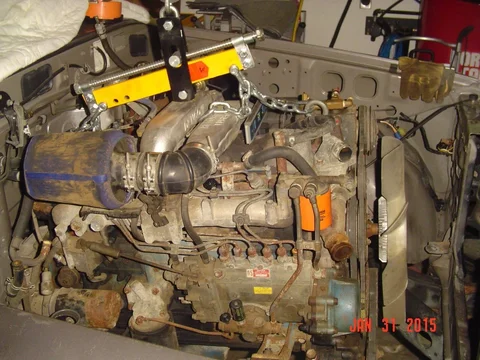

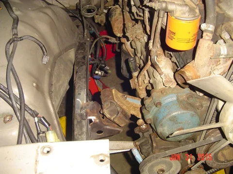

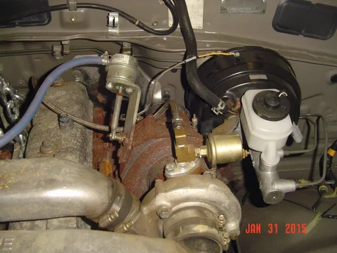

First off I would like to give Rob a big thanks for the several days he has spent helping me with the truck. So here are some pics of the issues we ran into this time. In the stock location, used another HJ, for the engine mounts the Denco Turbo was hitting the brake booster. On the second try we moved the mount ahead an inch but we are still going to have contact. Also for a note the factory location mounts the engine diagonally in the frame. I am trying to put it in square. The next try is going to move the engine to the right an inch. Maybe Monday!

Looks like lots of room over the top of the turbo . Why not move the turbo a bit ( make an offset adapter) and land the engine in the stock location ? Seems to me like more work making the engine fit around the turbo placement than making the turbo fit when the engine is the stock location ? Are you going to have to modify the drivelines after you get it to where the turbo fits ?
