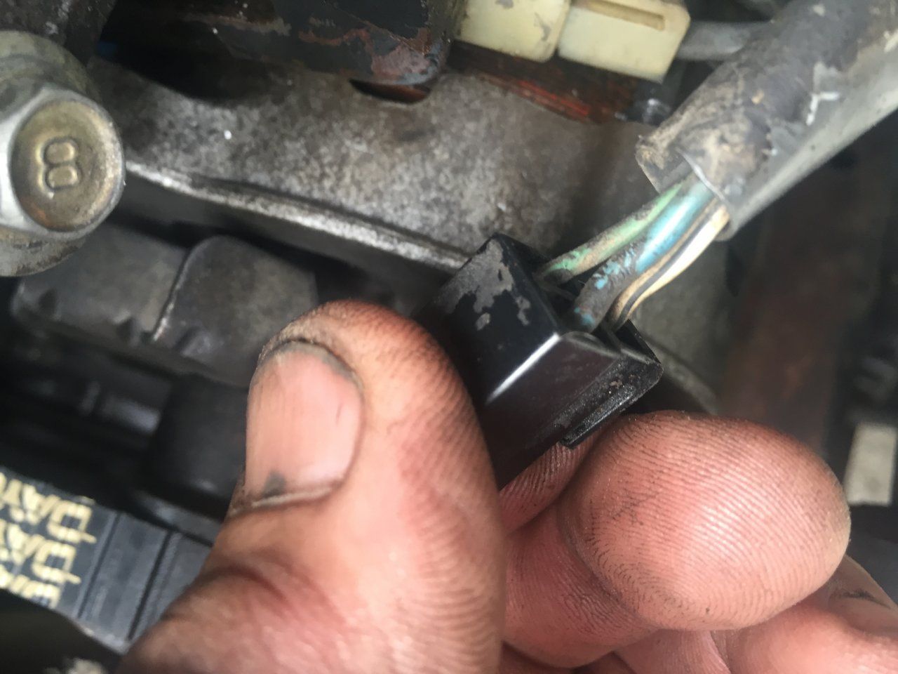

Pic #1: shows the internal IC Regulator and the three wires from the green connector (red, blue, white)

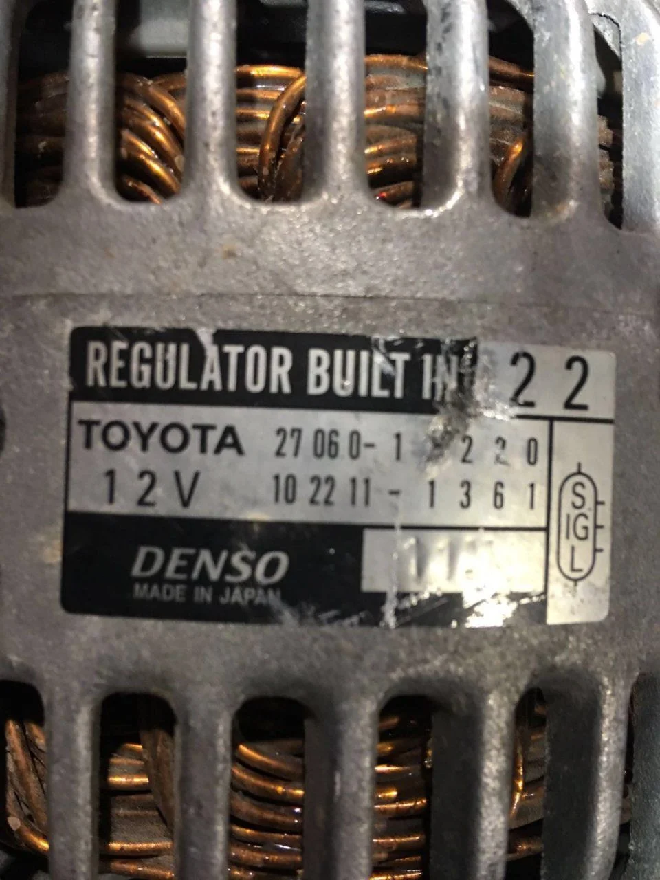

The sticker. It shows the plug and tells you what is ignitioN, sense, and hot.
A.J

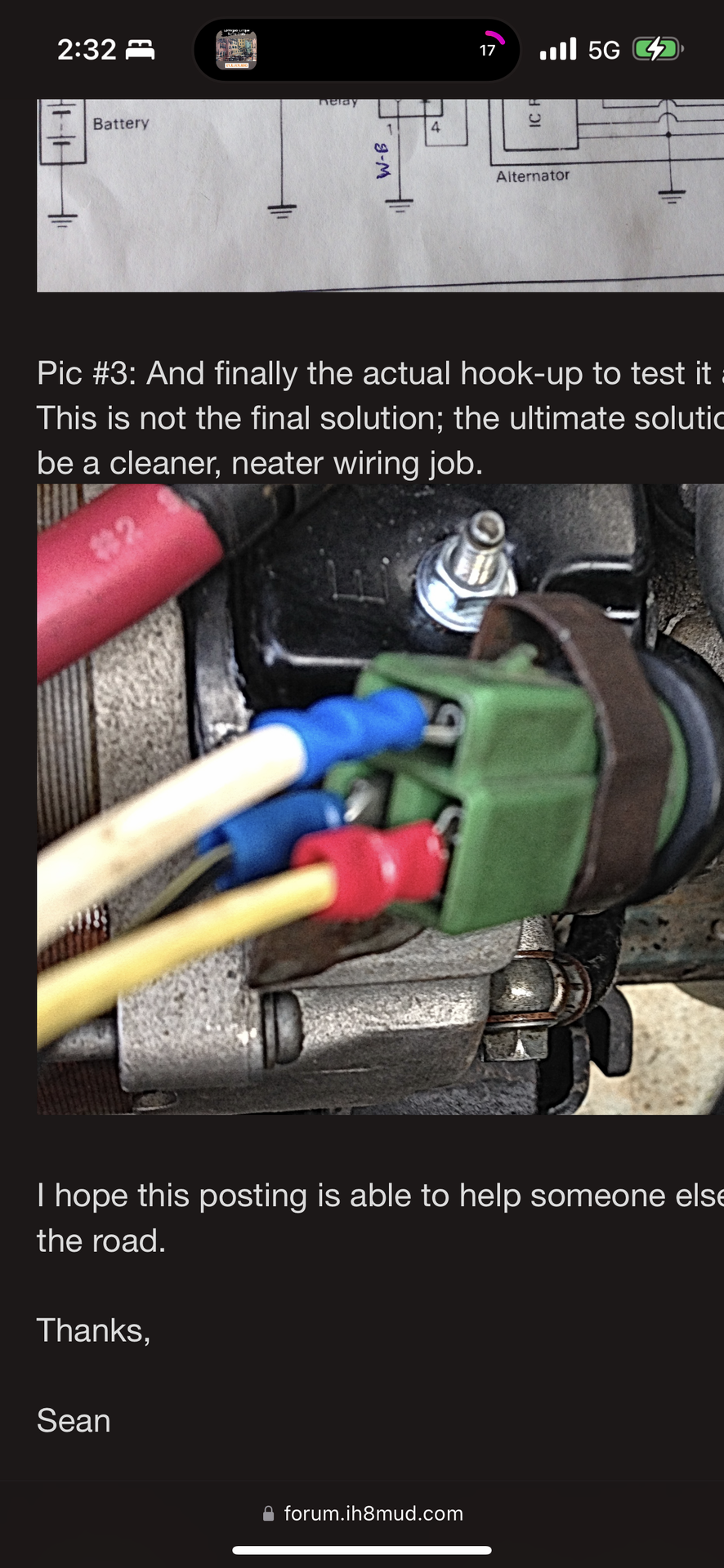

Pic #2: Shows my translation of the above information onto the Charging System Circuit diagram, labeling the color of the wires and the pin-outs. This picture also shows (upper right hand corner of pic) the pin #s on the male connector (alternator-side) when looking at the pin-side of the male connector.
Pic #3: And finally the actual hook-up to test it all out. This is not the final solution; the ultimate solution will be a cleaner, neater wiring job.

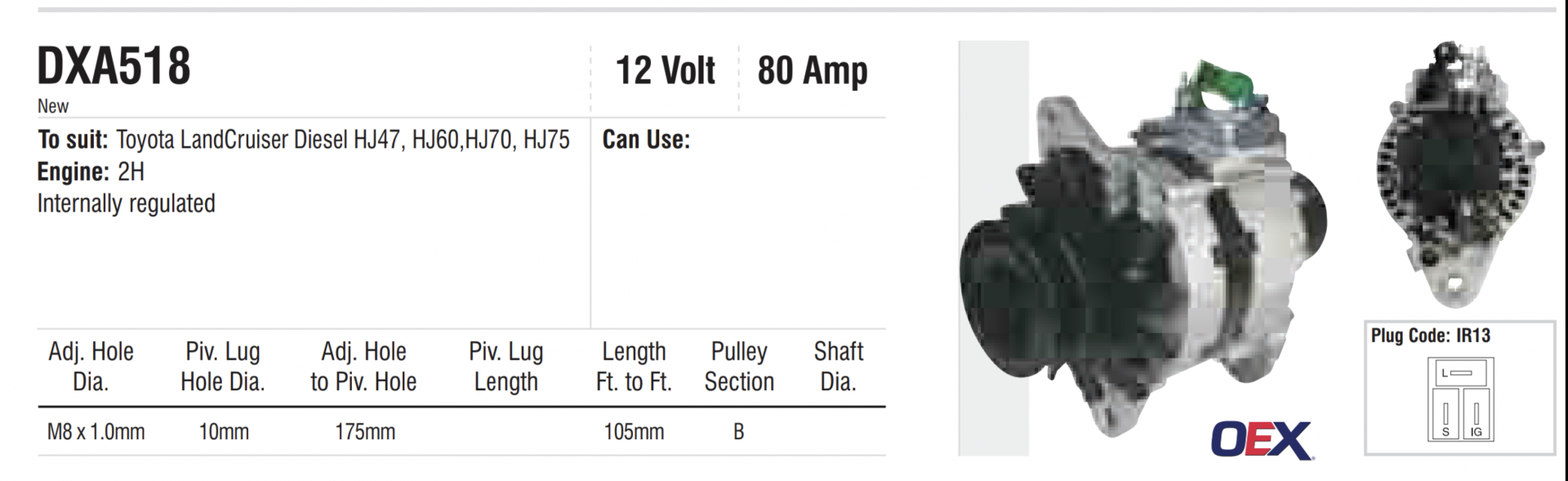

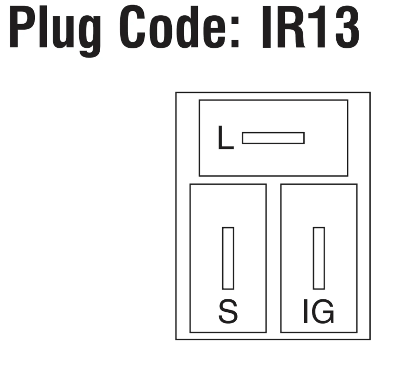

So I ordered replacement OEX brand alt (DXA518) denso style after market and found the pin out for this which I will try. 🤞

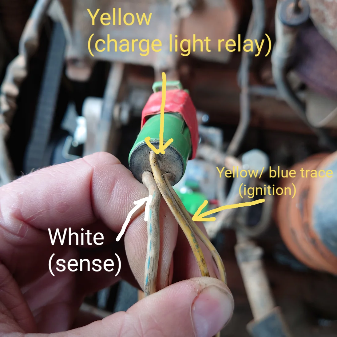

Turns out on the fj62 loom, big white wire is sense, small yellow/black wire is ignition hot, the other is the charge light circuit. Put in a brand spanker new alternator and all problems gone, except brake instrument light but I'm certain it's unrelated.

My reg was dead but It works great now with the new alternator and is wired up to manufacturers diagram above. I noticed the sense wire is the thickest, then the lamp wire followed by Ignition being the thinnest. (on alt, fj loom and hj loom)

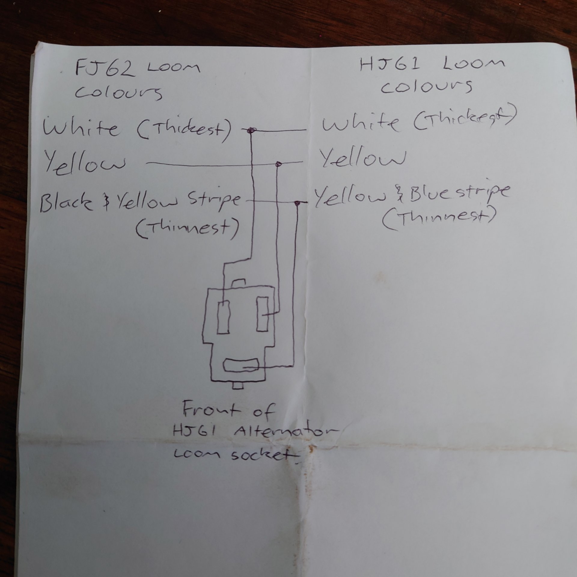

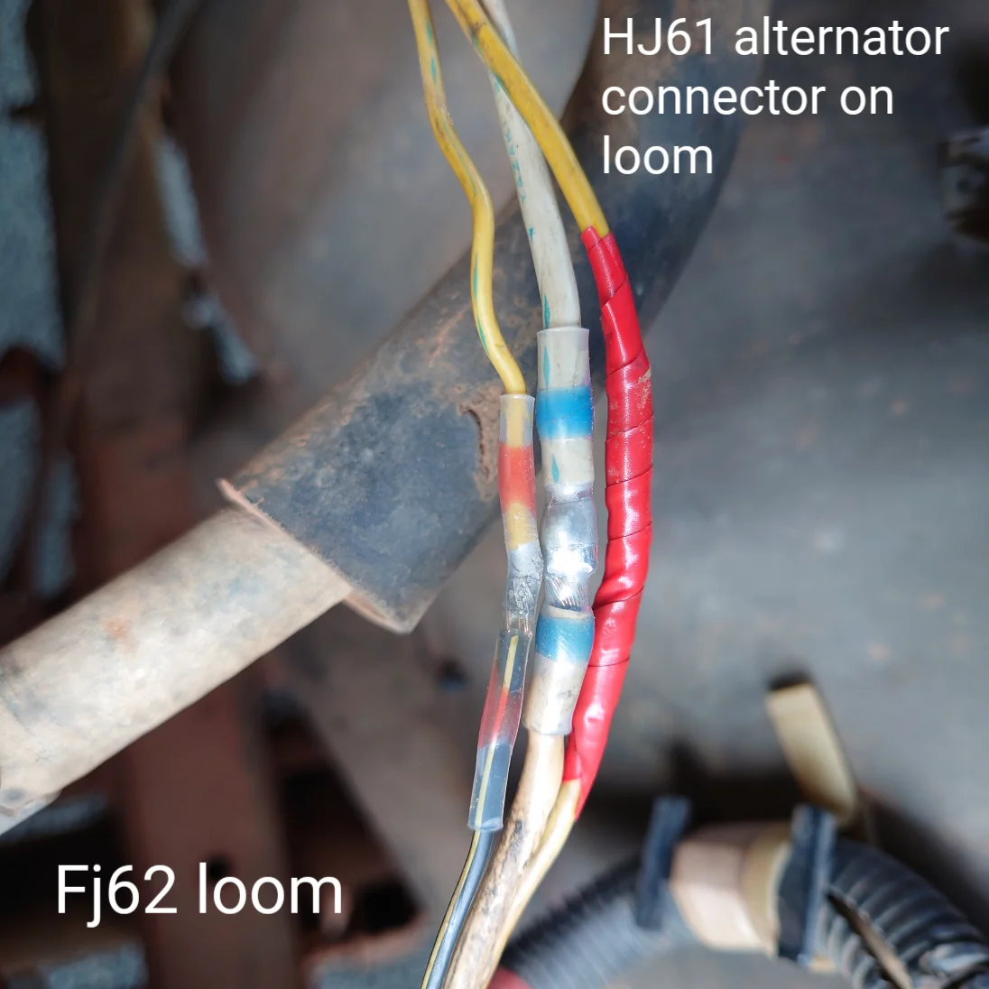

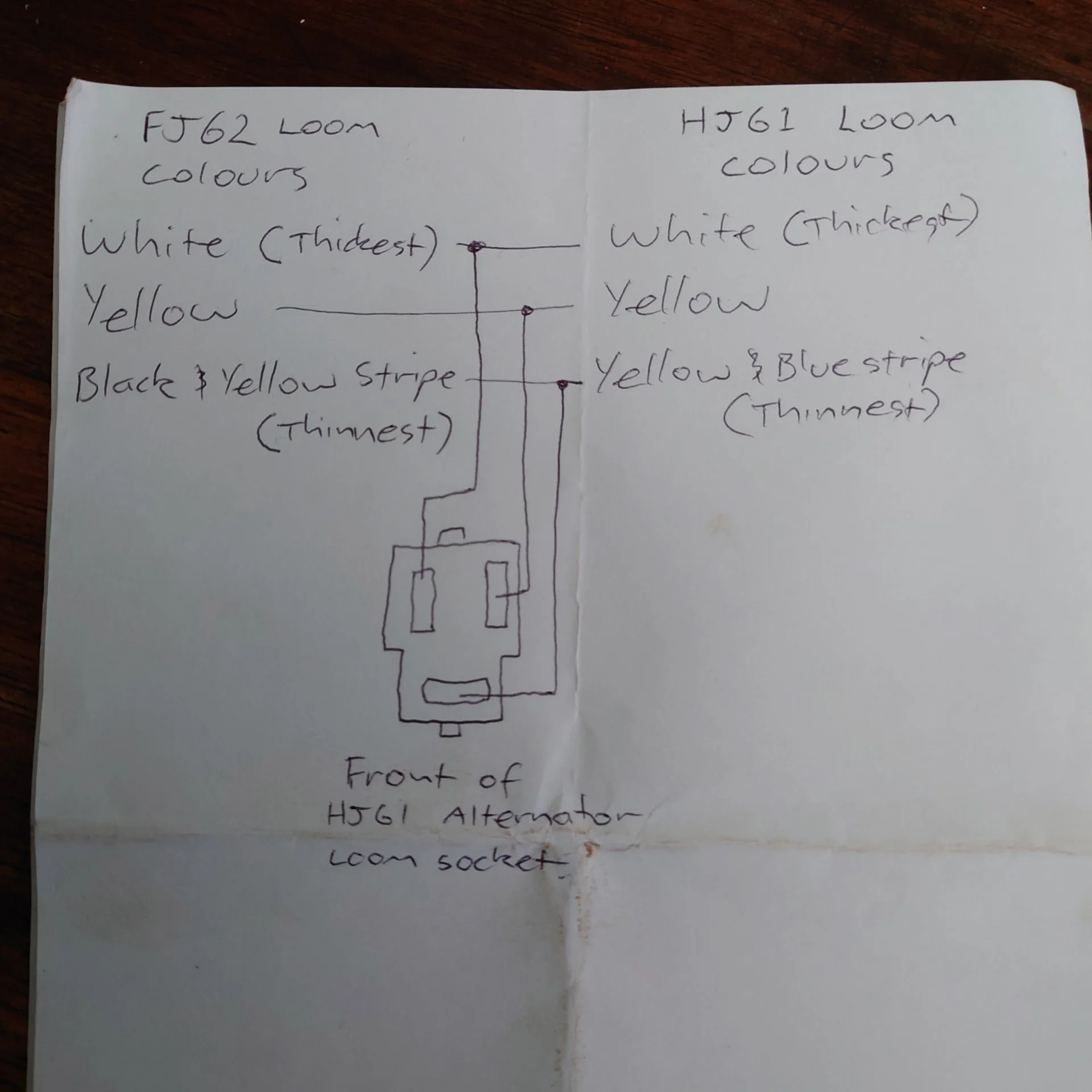

So I've snapped some pics and drew a Lil diagram, I did check the connections with a multimeter to make sure they went to the right places, it worked out the thickness of the wires matched up too. I hope this helps people. (I touched charge light wire to ground and blew a fuse lol)
Cheers, Mick

Thanks, Mick. That is very helpful. Now I have to trace down one additional wire to see where it has been run to. I have an additional thick white wire connected to the alternator and running back into the firewall. Got to figure out what that goes to.
Thank you for posting the pictures and the diagram!
-Sean
I had another smaller white wire in there but I think it was joined to the sense wire from memory, it was joined at the alternator end of the loom. Might have to have another look.

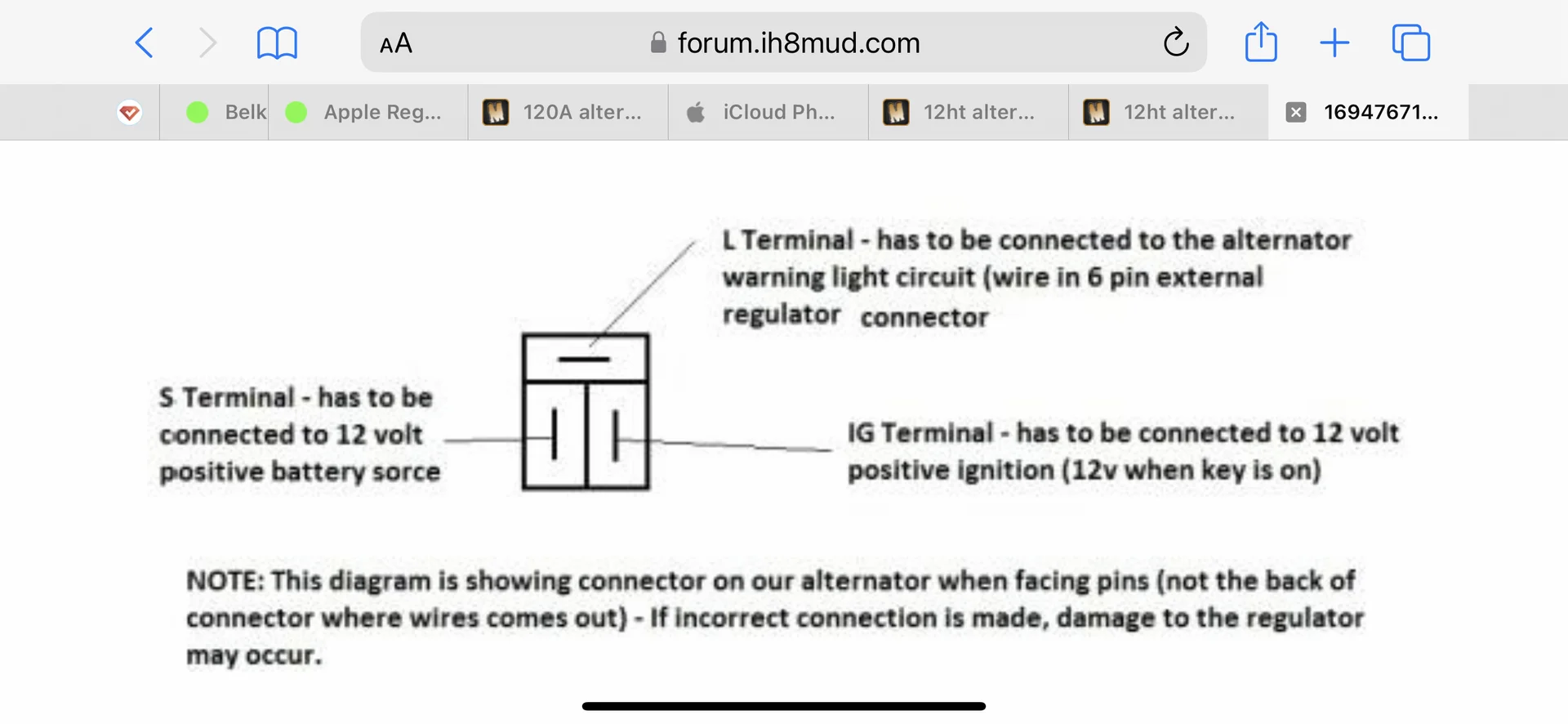

This thread is very helpful for my situation. I am on the road and need to hatch my alternator. On the attached picture, Is the yellow wire attach to the battery positive or the switch positive? Also I will not use the white wire, according to the pictured digram is supposed to to be connected to warning light. Is connecting the white wire necessary to get my alternator charging. Or is there a way to hack this white wire to get the alternator charging? I will not be using my oem harness, this is a direct hack to the alternator. I want to do a temporary hack until I find an auto electrician that is familiar with my alternator. Thank you for your help.
