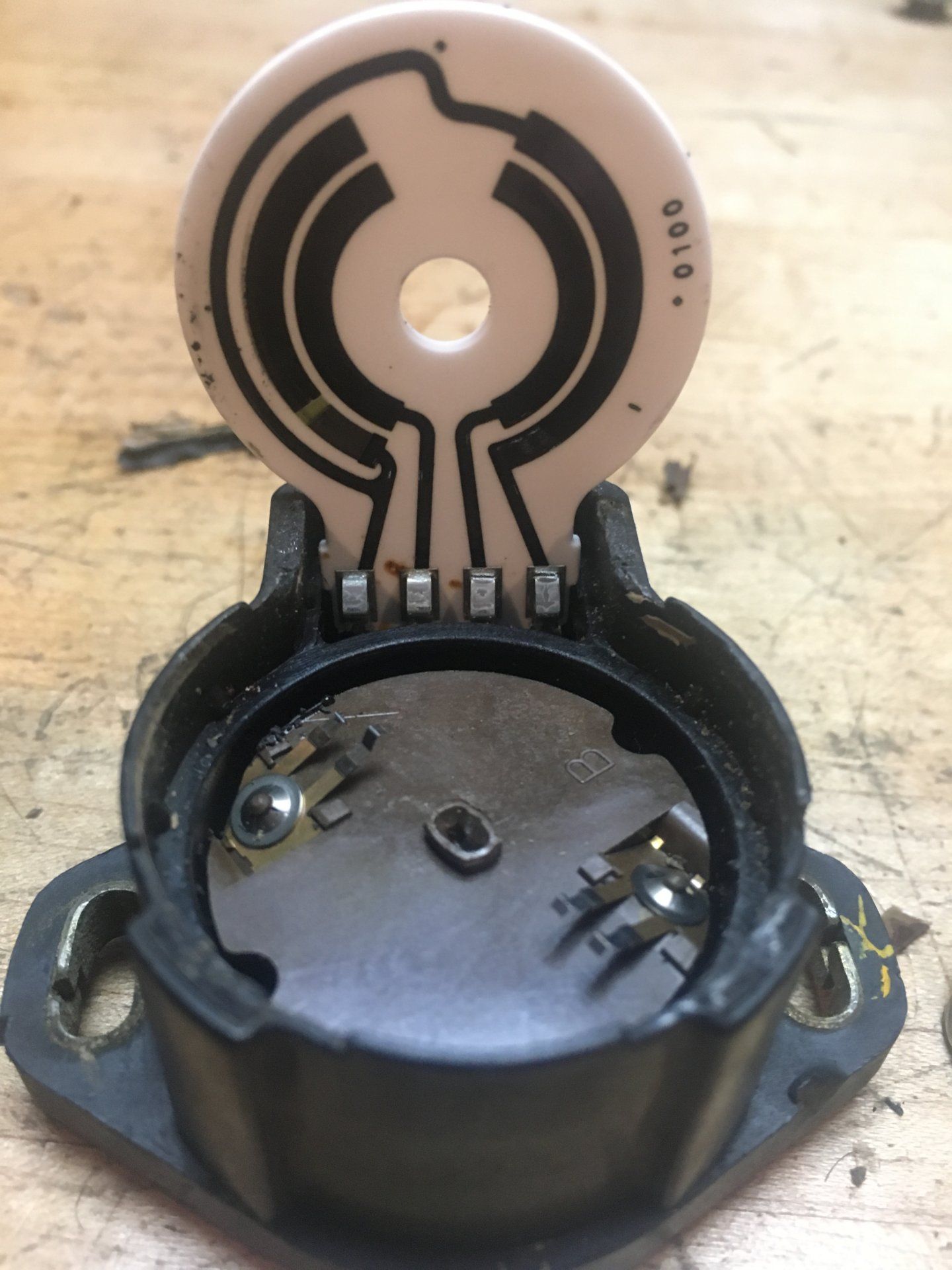

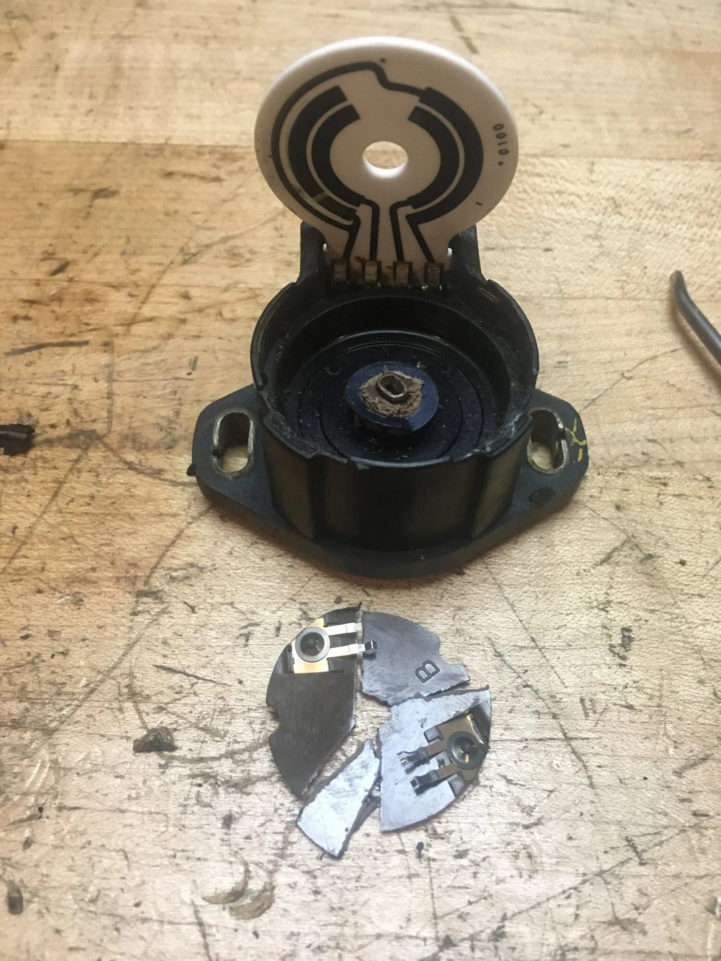

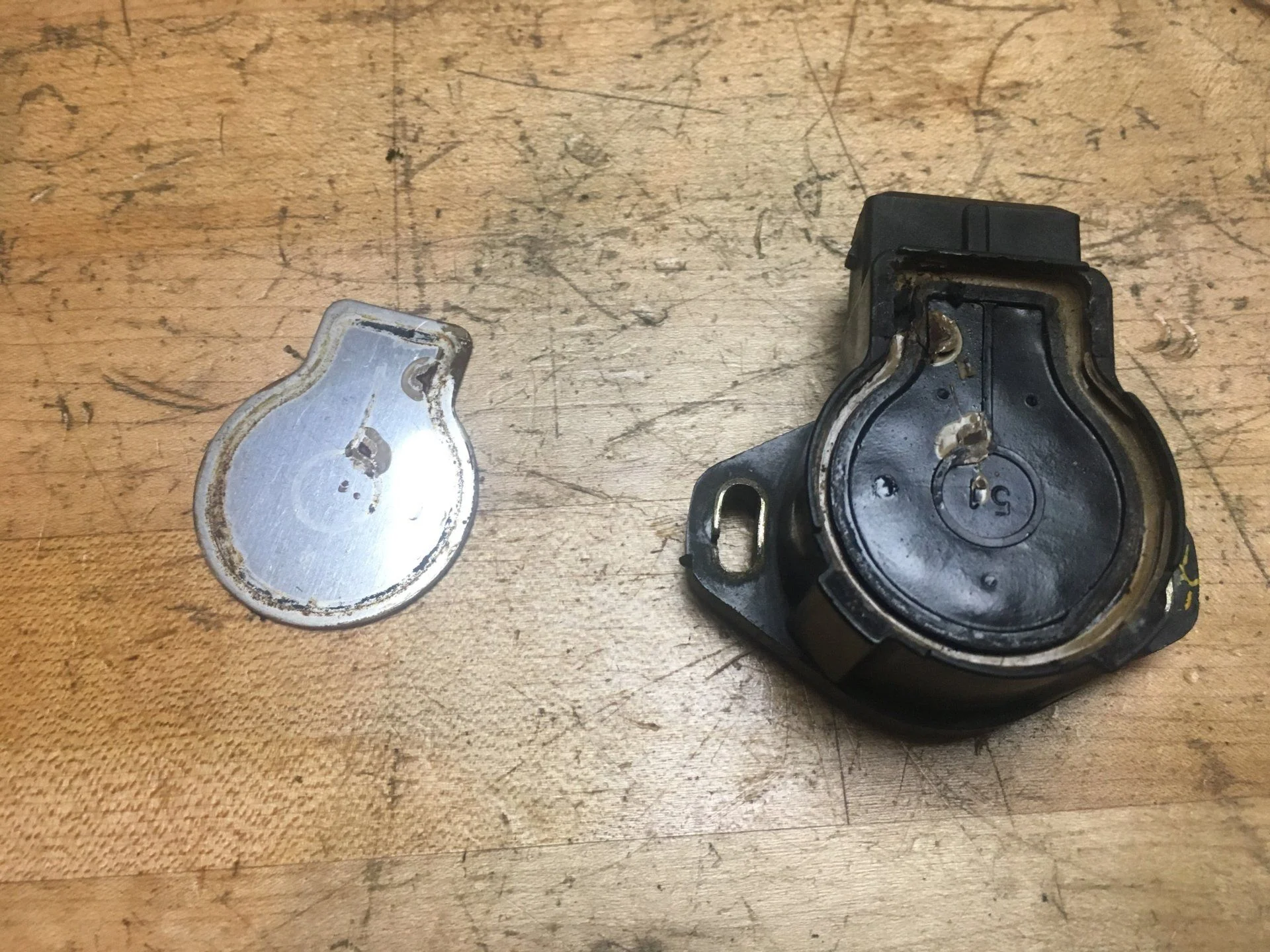

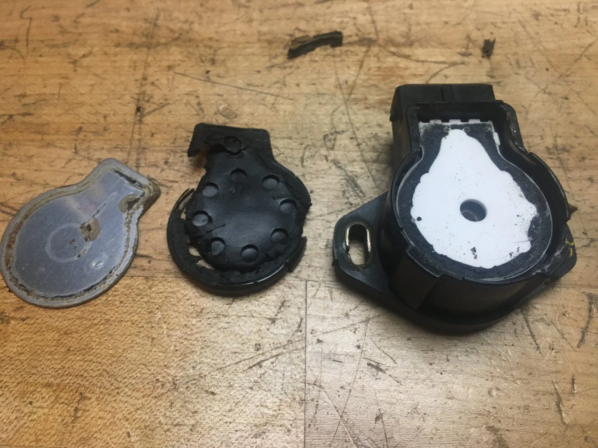

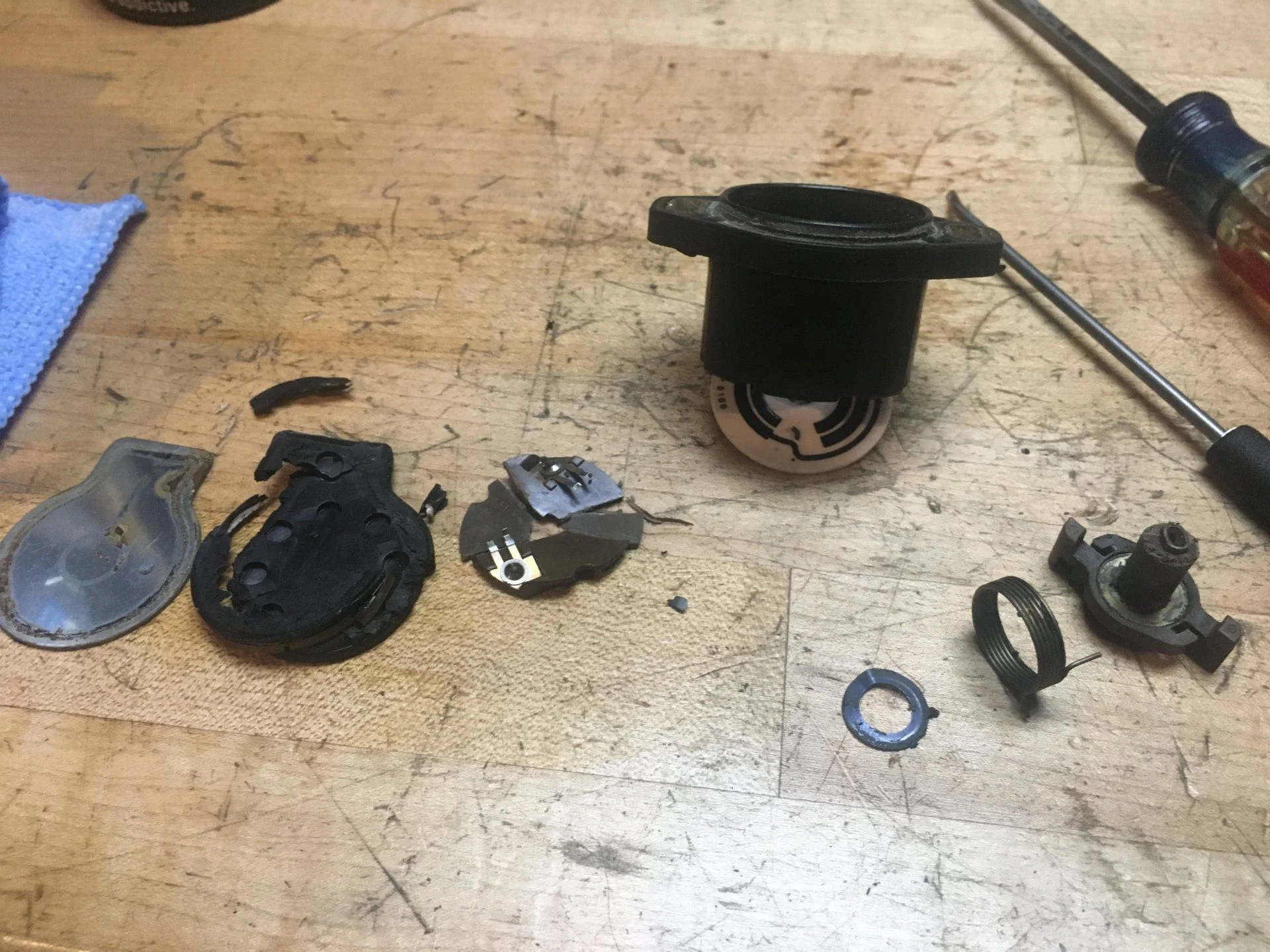

I haven't dissected my old TPS, but I'm pretty sure it's what would be called a rotary potentiometer. The basic idea is there are internally 3 terminals: input, output, and the resistor. As the throttle is opened, the throttle body rotates a spring loaded mechanism within the TPS that causes a wiper to move across the resistor. The voltage that flows through the output terminal is limited to the extent that the wiper is in contact with the resistor.
Ultimately, it's a clever way to convert mechanical rotary position into an electrically detectable signal, but it requires a clean contact between the wiper and resistor and precise calibration of the default rotational position of the potentiometer.
BTW, the probes that came with my multimeter were useless for this job and I had to solder some small alligator clips onto them.
TPS dissected
That's very educational. Is it just me, or does it look like a bunch of material has been worn off from the end of left most wiper in your 3rd photo?

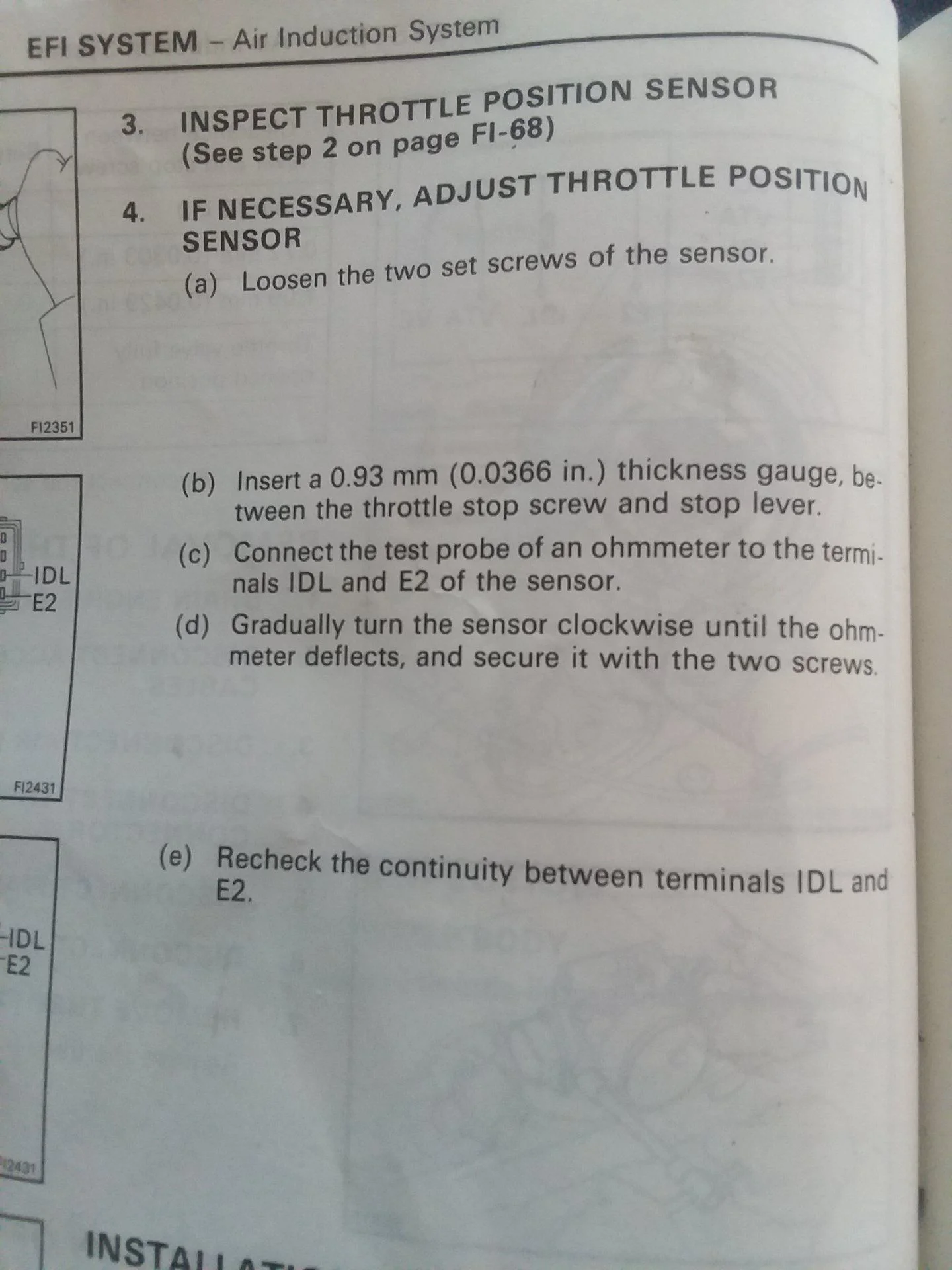

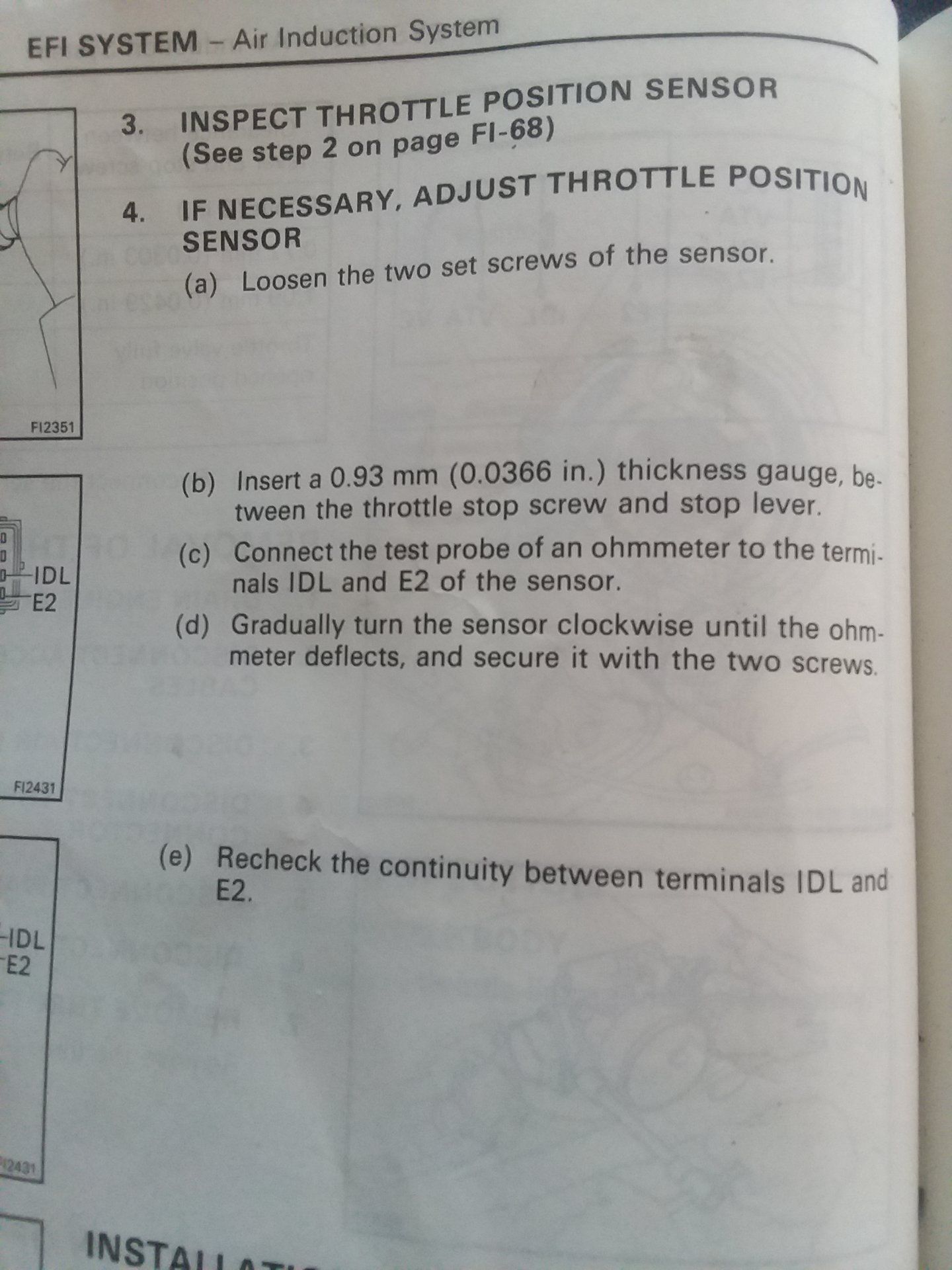

Please correct me if im wrong but my FSM calls for .93mm gauge to be used (.036"). Wondering where your .043" came from...im trying to tackle my Throttle Position Sensor issues right now..maybe my manual is wrong and thats part of my issue.. or maybe it makes no difference it just sounds like this little bugger is fussy about its exact location/rotation. Howd you make out in the end? My idle is stuck up around 1000/900rpm and i have tracked it to the TPS so far..
Here's my FSM info:
