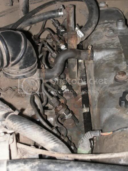

and i got lots of black smoke so i thought id try reman'd injectors
brake lights stoped working, blew a headlight...
so new:
waterpump
thermostat
injectors

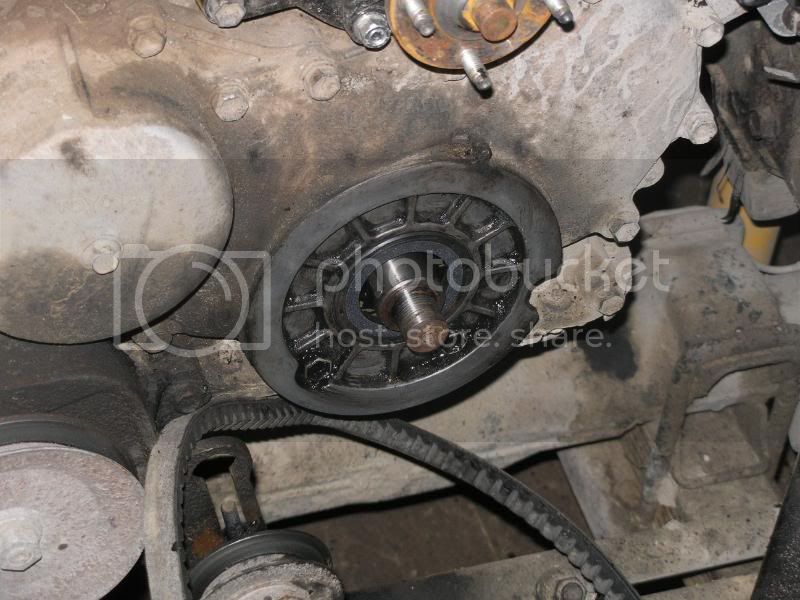

and tomorow i gots to replace the front main seal, woot
seksi
yeah, but toyota didnt call it crankshaft seal either, nor main seal, it was like timing gear cover oil seal, part|# 90311-50006
i didnt actually get to it today...was working...
front main

well, after replacing my 'front main' i left for a 5000km journey for my vacation travelling around the extented regions of the ottawa valley.

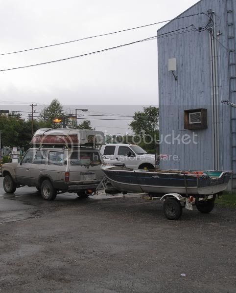

talk about loaded: 2boats 2motors 5coolers 3 guys+gear for 10days

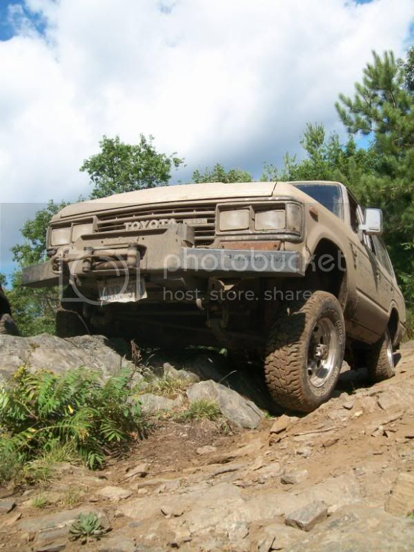

so over 25000km since the swap,
i put on some 32s m/ts and the mileage has gone way down
