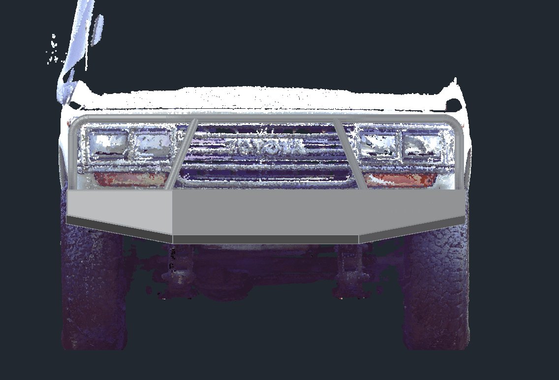

I haven't been able to find a bumper that I like completely so I've decided to design and build my own (just designed at the moment).
I've pulled many ideas from many bumpers that I like partially and here it is.
What I'm wanting is input on things that I may not have thought of. The things I did want and couldn't find anywhere else in one bumper were:
- A non-winch plate bumper.
- Something that looks like it is integrated into the truck not just an add on to the front end.

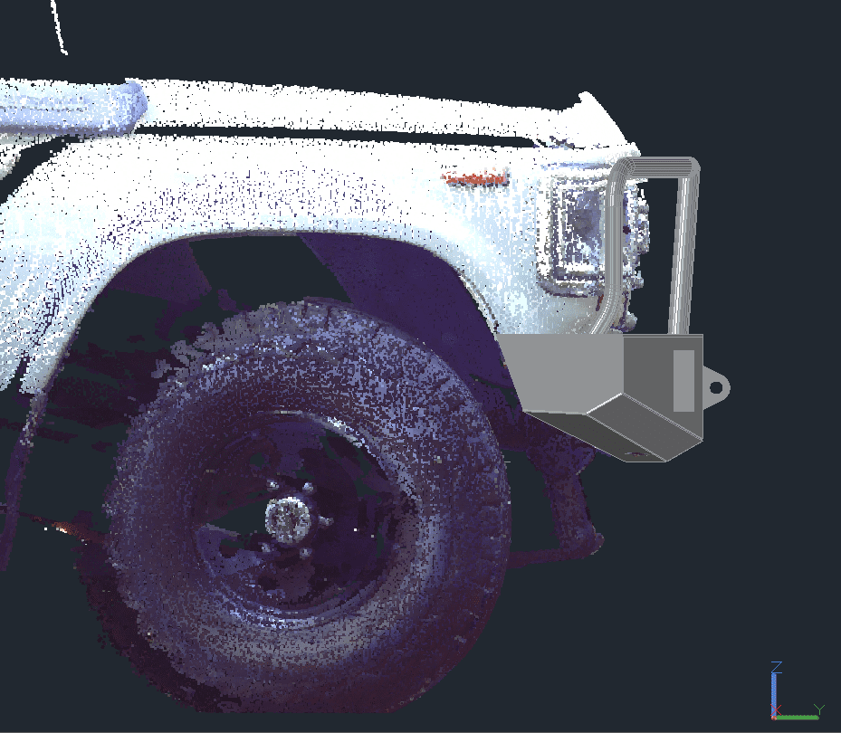

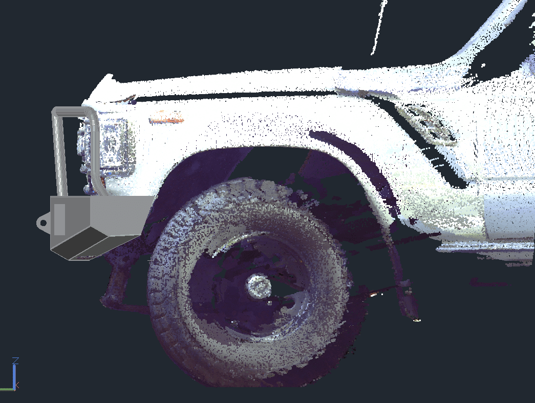

- Something that wrapped around the sides of the front fenders and followed the wheel well lines.
- Something as tight as possible to the front end without impeding any functionality.
The only thing I have left to add are the lights that will be mounted in it. Probably 4x4 LED pod type lights in the right and left wings.
Anyway, let me know your constructive thoughts.
I like the goal and the initial exercise. From a design standpoint -
Consider adding integrated recovery points or shackle mounts in line with the frame rails, possibly a dimple or pocket where you could securely use a hi-lift jack.
Side profile looks clean and has the fender corner protection.
If you have the ability to curve the plate material at all you can mitigate the 4 corners where the bumper projects from the body the most.
It looks like the top of the bumper sits higher than the frame rails or stock bumper, so you'd cope it around the fascia panel correct?

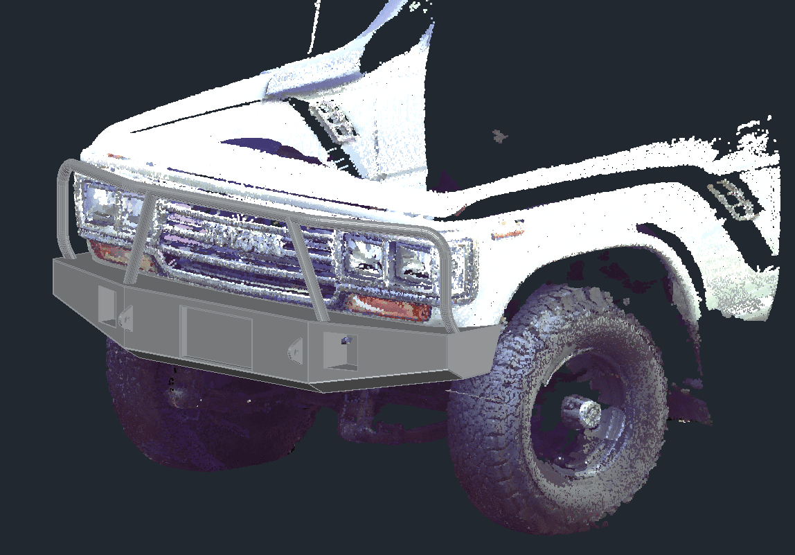

Updated design. Added:
- Light buckets
- Recovery points inline with frame rails (thanks @cheeese)
- License plate recess (gotta have front license plate in Oregon)
- Holes on the top of the bull bar to weld a nut into later for cable tie point.
Ive been playing around with my own designs for a bumper, and i have had the though of making sloped. This way if you were to hit a stump or rock it would direct the force upward rather than the frame taking the full impact. With that being said my design would incorporate a sid-plate that would help protect the steering components. Ive sorta based my design on how the build train bumpers to reduce head on collisions. That is just my 2-cents i haven't had the facilities or time to have a proof of concept.
