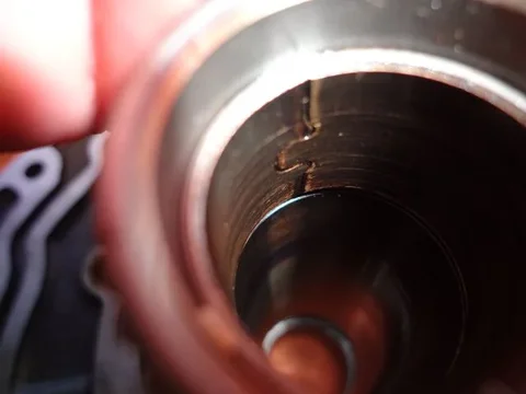

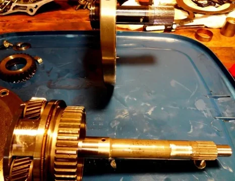

He explained that there are bushing in the oil pump that should be checked or replaced. For an understanding, these bushing are like 2F cam bearing but act differently. One of the purposes of the bushing is to limit the fluid pressure by keeping it in the TC and applying pressure to the lockup. Or in other words, fluid pressure goes to this location and lubricates, allowed to leak it drains back into the hydraulic system. Showing the bushing from a Highlander he was working on, the tech said that this is a common design for Toyota. At lockup speed the fluid is restricted and pressure is applied to the lockup. If the bushing is worn then fluid pressure leaks which causes the lockup to slip and starts to heat up.

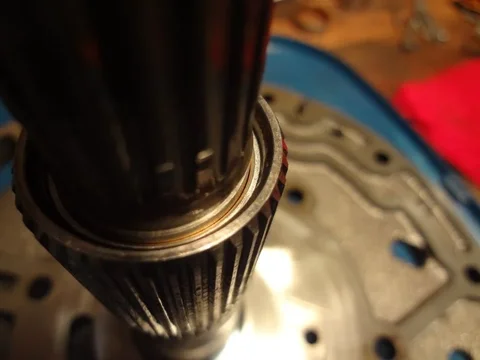

Getting back to my 80 trans that I still have, I moved the Overdrive Planetary Gear inside the Oil Pump and there was a lot movement. See the pic for illustration.
With this 62 trans there's no movement but I'm going to replace the bushings in the pump as a precaution anyways.
The manual does stated that you should measure the inside diameter of the bushings on the pump, if out of spec replace the pump. These parts are really expensive so I having the bushing replaced.
Now the question becomes did I measure the pump's bushings on the 80. I can't remember, I've slept since then and had a lot of really great beer.
OD gear and pump. Bushing in between these on the inside.

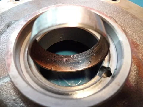

Stator pump side.
Stator bushing. (1 of 2: There is one on the other end also.)

Stator pump side.

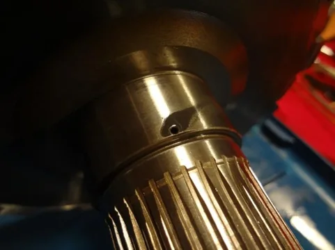

I got the replacement output shaft in from dallen341 and it's in superior condition. The packaging of the shaft was a work of art, there was no damage that was going to happen as a result of him efforts to package. Thanks Dallen. :cheers:

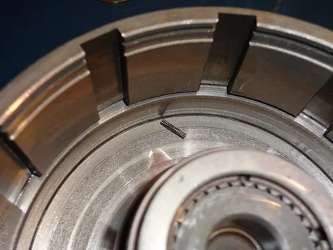

This OS had some residual clutch material from it's tranny so a multiple wash in the parts washer was needed. The manual calls for using ATF or Kerosene to wash the parts with, I've got Kerosene.
The second pic is a piece of debris from the machining process. However this debris was pressed in place from a locking ring inside the housing. After 330K I don't think it was going anywhere. It was good that I found it after is became dislodged.

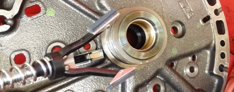

The bushings finally came in from the vendor. I ran the pump over to the tranny shop where the guys that have been so helpful pressed the old bushings out and put the new bushings in. There was one new bushing that needed to be honed down because it was over spec, the O/D shaft would not fit. I took the bore hone to it and got it in spec. There are only a couple of these bushings that call for measurements in the entire transmission. These are pretty critical since they help to keep fluid in the TC while in lockup. The sun gear drive bushing does not call for a measures so I assume it's just used as a guide.

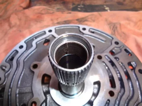

The pump has three bushings total. 1 on the body side and 2 on the stator side (cover side.)
Here's pictural progress thus far.
This bushing in pressed into the pump housing. This is the bushing that will ride against the torque converter input shaft.
New bushing.
Honing of the new bushing cover side.

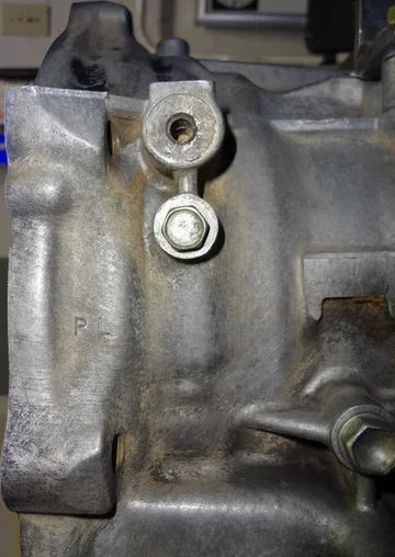

There is a port on the outside of the housing assemble, along with many others. The manuals only show procedures for checking the condition of the trans to diagnose problems. It does not show what port you are specifically checking.
I'll post up a thought about this tomorrow after I deduce (the best I can) which port is going to be effected by your request.
astr,
This one of two ports that the manual refers to a line pressure test is on the drivers side front of the trans. (The other port is to test governor pressure and in the back of the trans, drivers side.)
This port goes directly into the oil pump. It's buttoned up so I'd have to crack it back open to probe more. I suspect it's just pump pressure.
The FSM states to test this port for a line test. The pressure should read between 158~193 psi at stall speed of 1950 ±150 rpms. Idle reading is 53~61 psi.
The other possibility would be the oil cooler circuit.
After tracing the TC circuit during lockup I found that this capped off angled threaded port goes to the delivery of the oil cooler. At least I'm pretty sure it's deliver and not return. But I don't see 150+ psi running through the cooler circuit.
