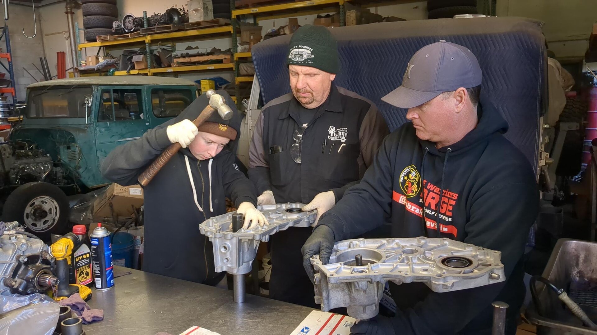

Yes that Tcase will work with the H55F but you’ll need to make sure since 83 was the first year for the oiler.
The 34mm cases can be machined/clearanced for the low gear sets but typically you end up punching thru the case in 2 or 3 spots. Those can we tig welded shut by adding material to the outside.
The 38mm cases lend themselves to the lower gear sets much better.
Hope that helps.
Georg @ Valley Hybrids @ Cruiser Brothers
Great example why it would be best bought as a unit if I'm ever going that direction....!
When doing the gears we punched through mine. I thought maybe I had identified the case wrong. Not sure I feel better but good to know that I didnt screw up.
