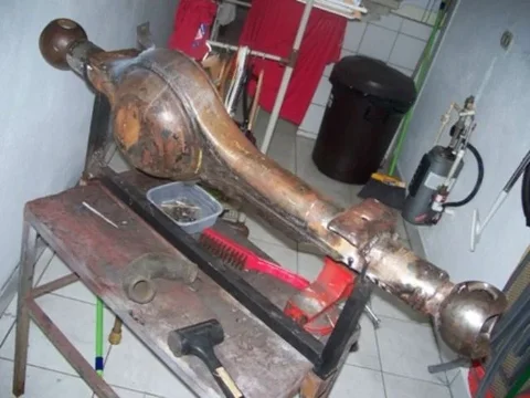

like in this axle the short inner fj60 axle works, after a little test and fail,the issue is with the long side I just shortted the lenght of the axle to fit on my fj55
