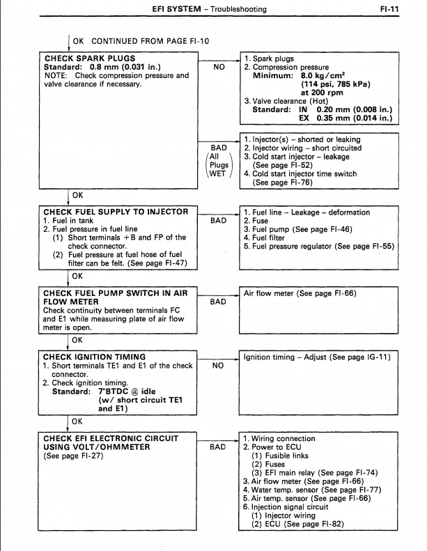

Have you verified that the cold start injector is spraying?
From FJ62 FSM
From FJ62 FSM
How do I check if it is spraying?
Thanks for the troubleshooting diagram. Going to screen shot these and see if I can zero in on the problem. Great way to break down possible solutions. I spoke with a guy who really knows these older Toyotas and he started off where your diagram ended. Checking the EFI electronic circuit using a volt ohmmeter. All the merrier, much appreciated advice thanks Seth
Easiest way to check spray would be to pull the injector out of the manifold, aim it into a container (wear safety glasses) and have some crank the engine for a couple of seconds and make sure its spraying fuel. If its not spraying there is a switch for it that could be faulty.
