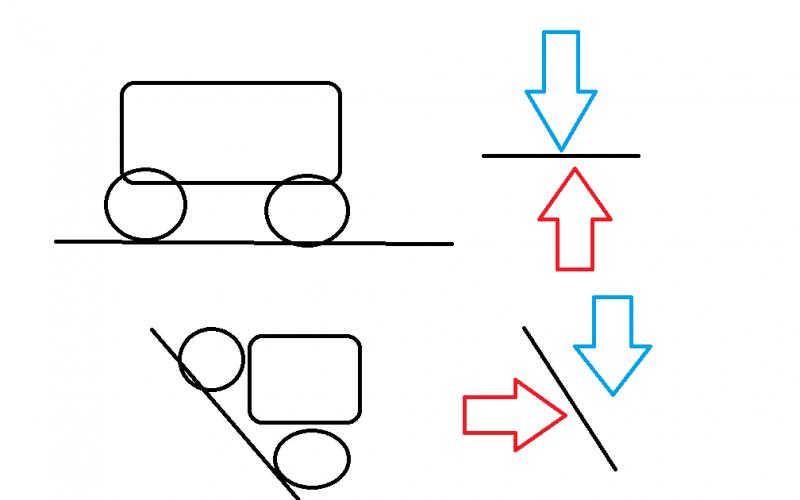

And about loading, I made a quick doodle.
The first picture shows the truck sitting or riding on a flat surface, the blue arrow represents the weight of the truck, whereas the red arrow is the normal force.
The second drawing represents a truck on a hill. You can see how the weight is facing down, while the normal force is related to the angle of the incline. The steeper the angle, the more weight is transferred to the rear axle.

You would have to put chromolys in it for it to have any chance of holding up in real wheeling situations. There is a LOT more weight/torque on the rear axle when climbing hills than there is on the front. If you wheel on flat ground all of the time (who does?), I don't see it being an issue.
I see the drawing on the force going up hill. What about the force in an emergency braking situation on the high way - say we hit the brakes doing 75 on dry asphalt. Are you trying to say there's less weight on the axle than in a vehicle going up hill?- I don't think so - there's just no way to put that much force on the back unless you're backing up and hit the brakes...

In an emergency braking situation you are putting all of the forces on the spindle and knuckle. nothing on the axle shafts to speak of. Going up a hill and possibly bouncing, you are putting all of the stress on the axle shafts. Also, during a panic stop, you cannot exceed the traction limits of your tires. When going up a hill, you have potentially thousands of ft lbs worth of torque trying to spin the rear tires.
Apples to oranges.

The forces on the rear axle during 4wheeling are significantly higher than on a front axle during a high speed braking situation. That is why the trunions fail quickly.
