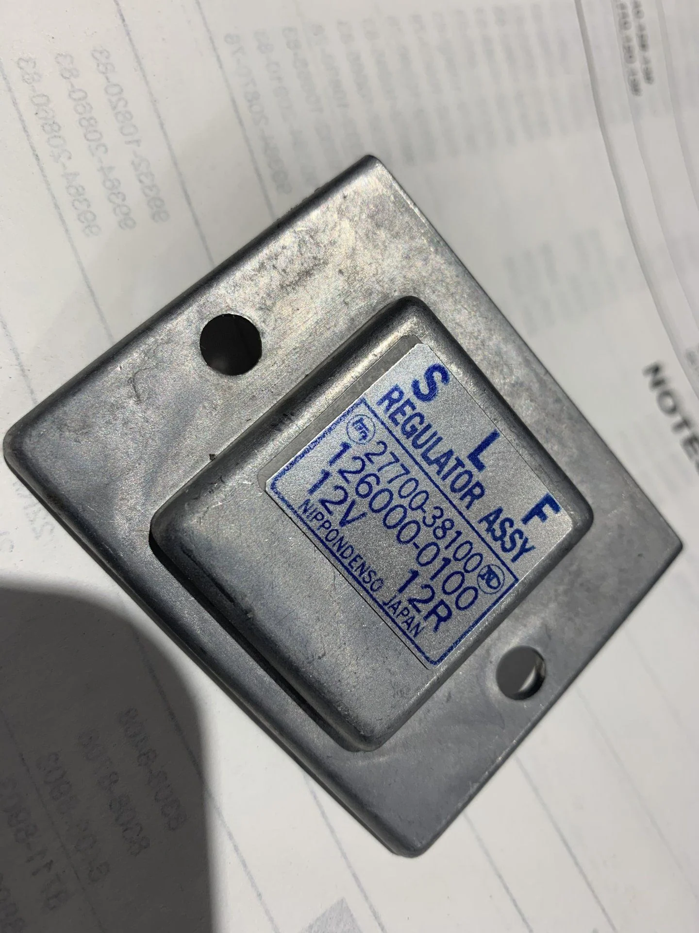

Are you running the stock fj60 unit ?
The one with the voltage regulator saddled to the side a bit size of a. Pack of cigarettes?
This unit here 27060-61071
If so , you should consider doing the field tests on the regulator and see if your main unit is FULL-Fielding
Or simply pumping out 55+Amps 24/7 ?
I don’t know much about a dual
Batteries set up but I can only conclude maybe its too much stress on the system
Grounds
And all connections must be checked
Esoecially the ring terminal at the back of unit it self for a solid clean contact and current flow Accross the board
I have a case. Of NoS regulators like the one picture shows example
Let me know if you have this unit ?
I will include one in your parcel 📦 being shipped out tommorow first thing
