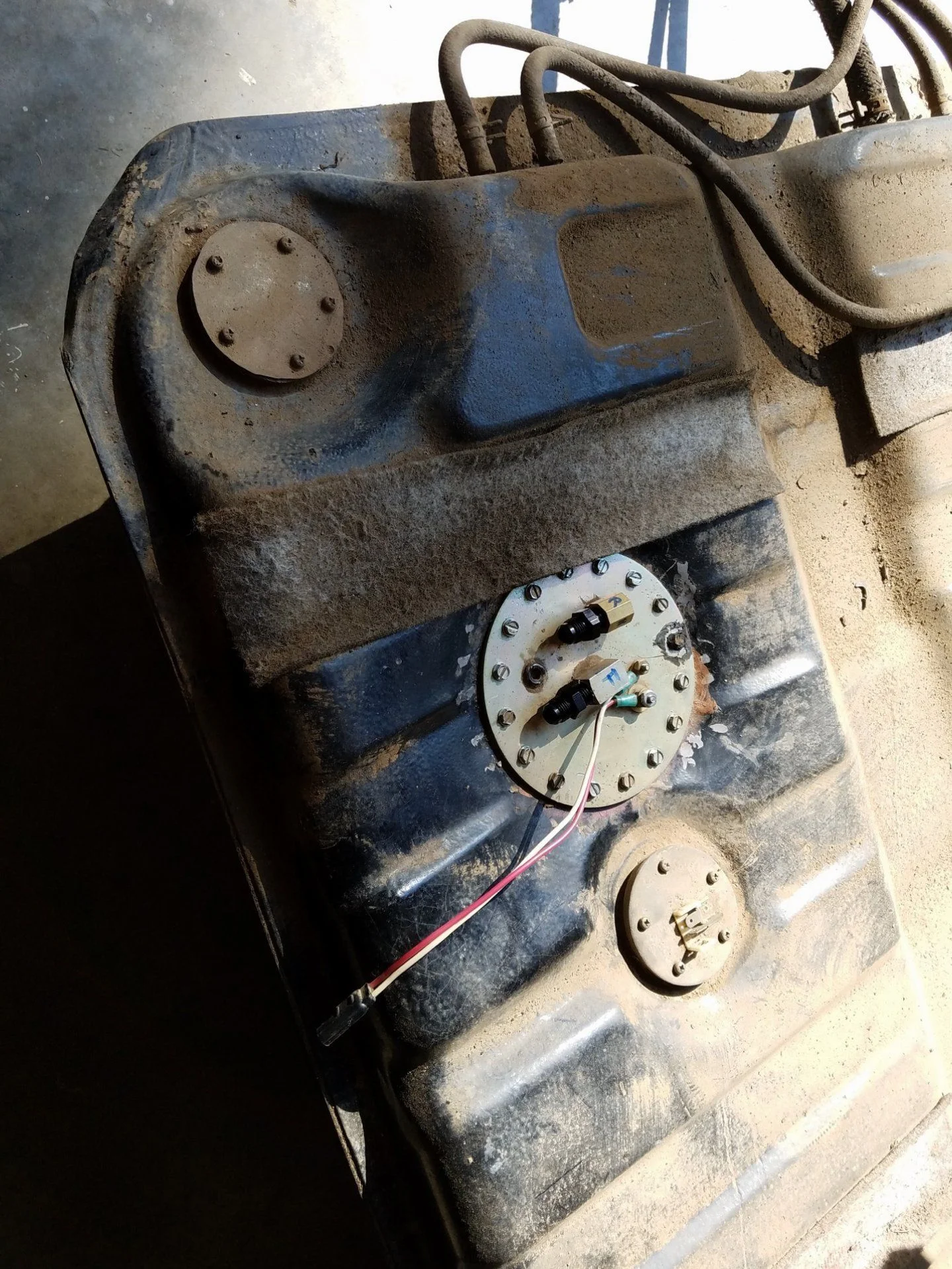

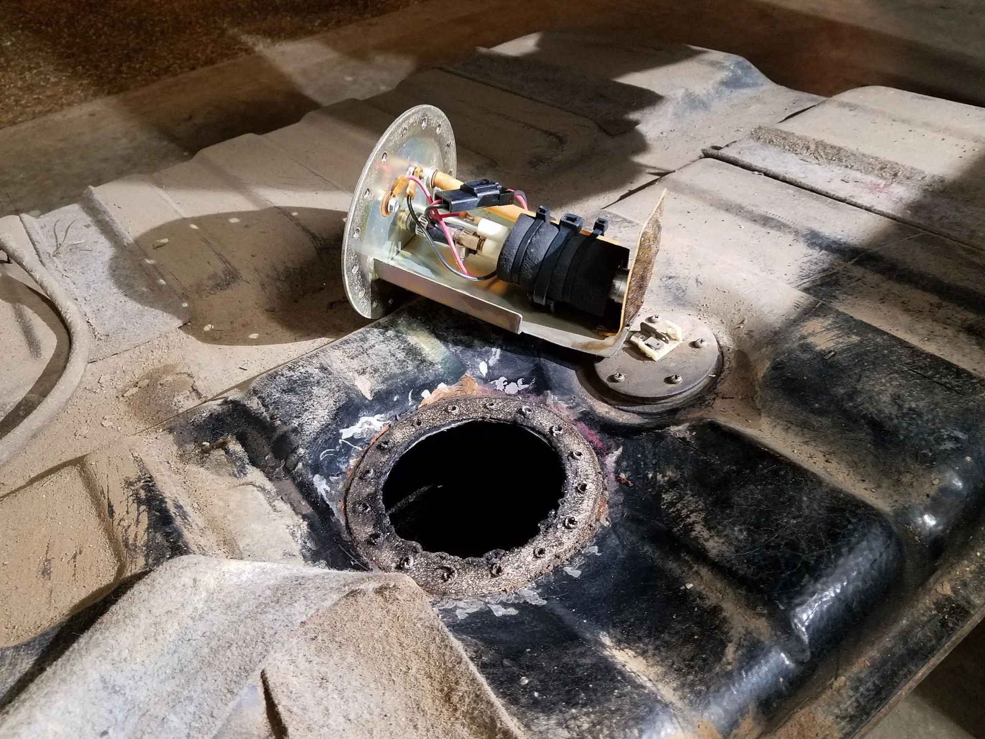

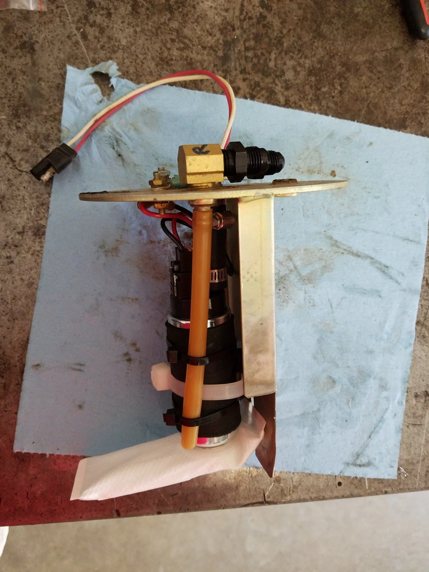

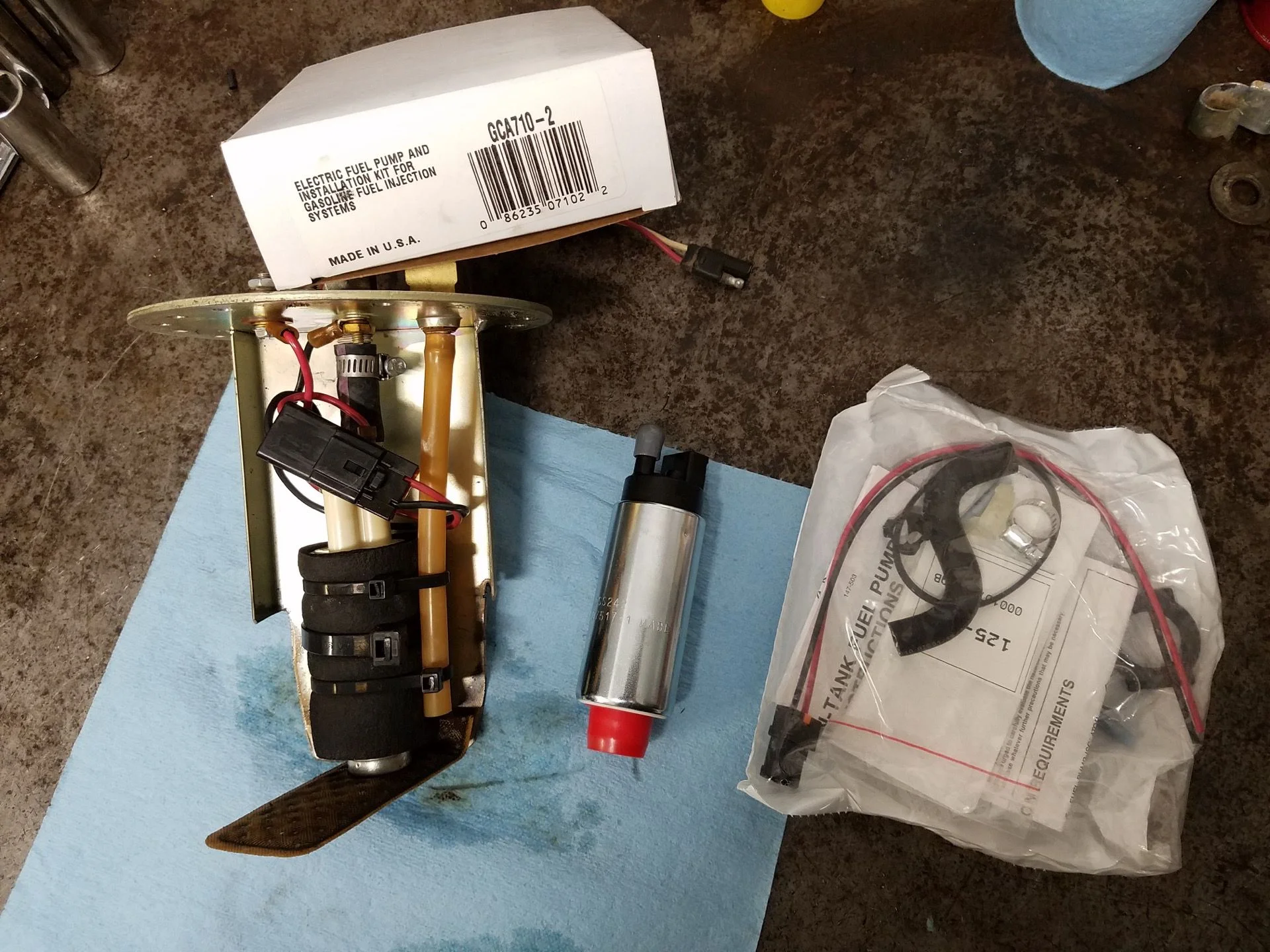

For my fuel system, I'm reusing a Tanks Inc in tank fuel pump kit that I installed a few years back for the TBI. I am firmly in the "no external fuel pumps for EFI" camp.
What I ended up doing was replacing the pump with a proper one, and converting the whole system to -6 AN. No more hard lines or hose clamps on the feed or return lines.
Out with the old...
full
full
In with the new...
full
full

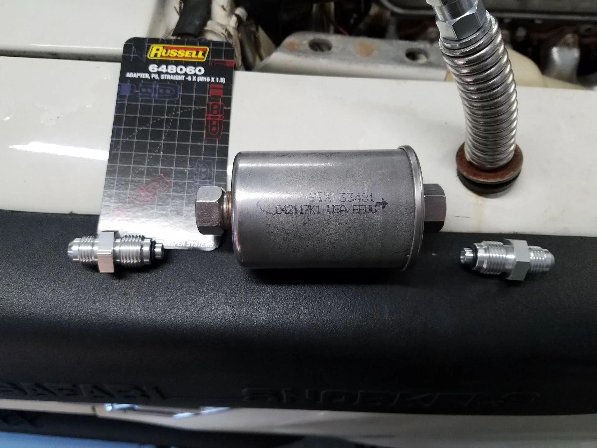

For filtering, I'm using a 2002 Tahoe filter from a non E85 Flexfuel version. Adapted to -6 with some Russell adapters. These same adapters thread into the back of the GM power steering pumps for converting those to -6 AN as well.

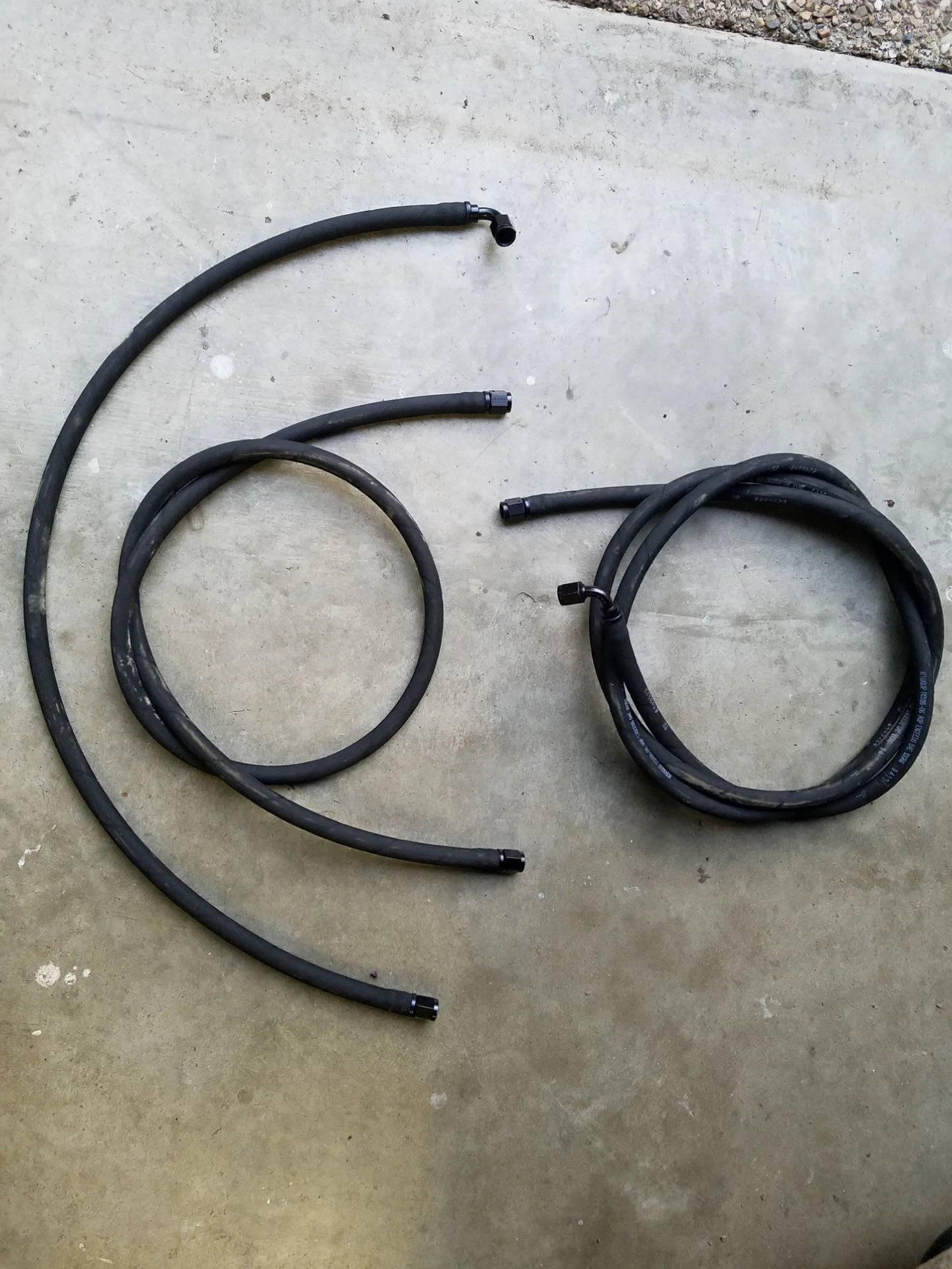

Made up some lines using Aeroquip Socketless hose and ends. A lot easier than traditional AN fittings. Dipping the hose in boiling water for a few minutes and lubing up the barbs with vaseline helped get them together.

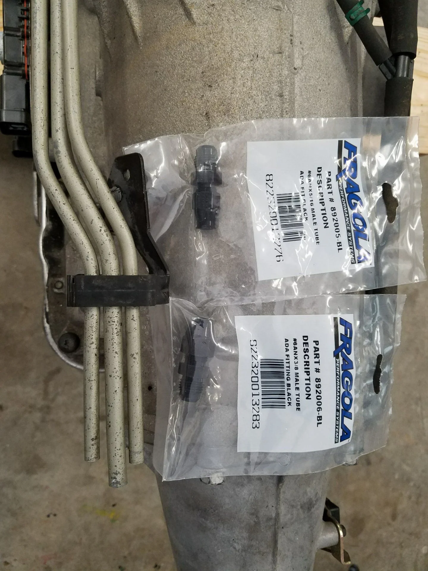

And getting the lines connected to the motor is a set of hard line to AN adapters. One for 5/16 and one for 3/8. I wanted to use as much of the hard line on the LS as possible as it has nice brackets and follows the transmission nicely and stays out of the way.
full
full

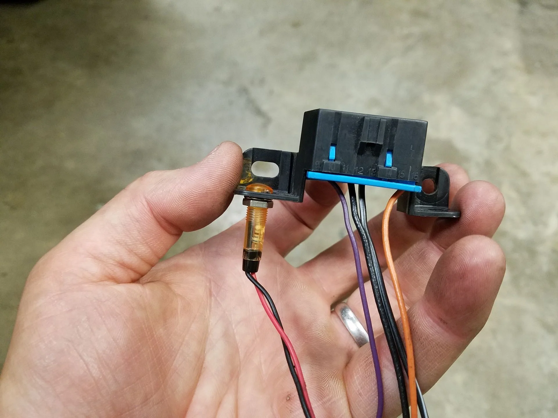

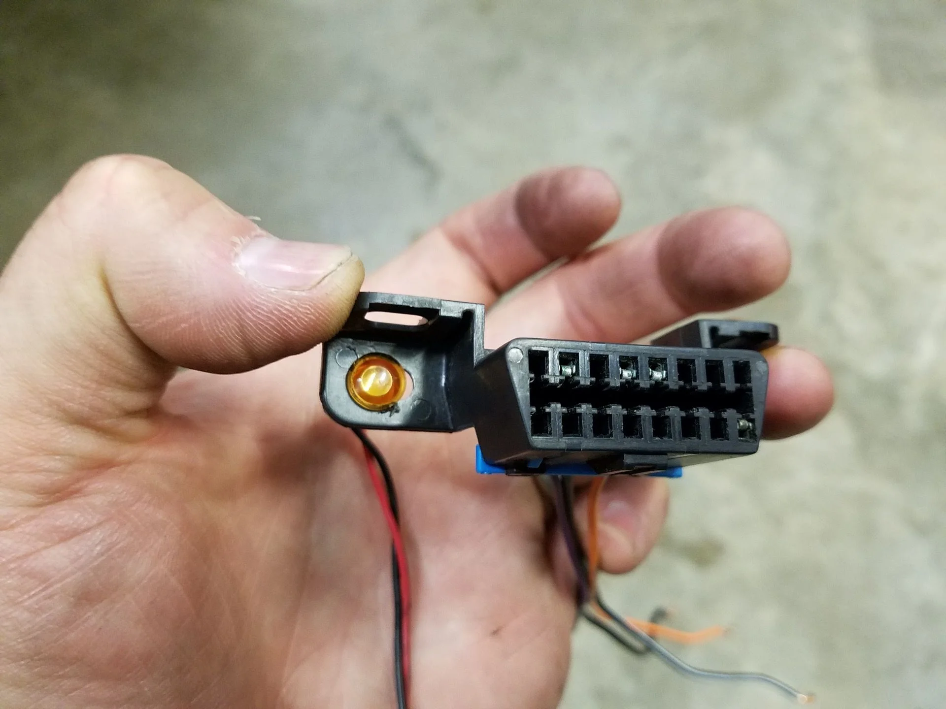

Next it was time to run some wires into the cab for the ALDL connector, check engine light, and brake switch for the transmission TCC unlock signal. This is how I do my check engine lights:

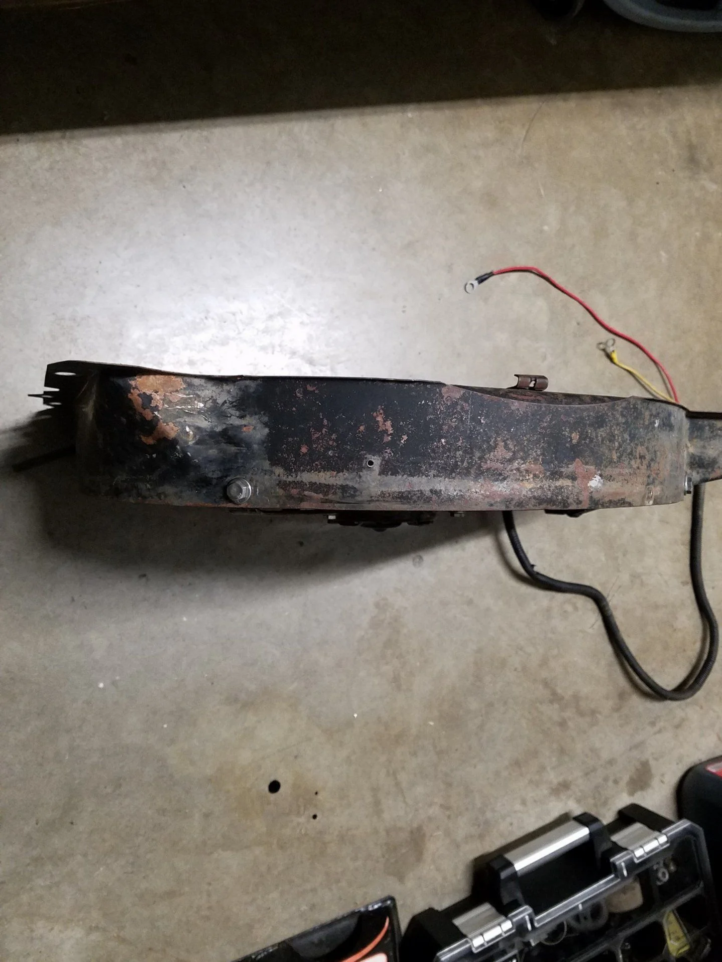

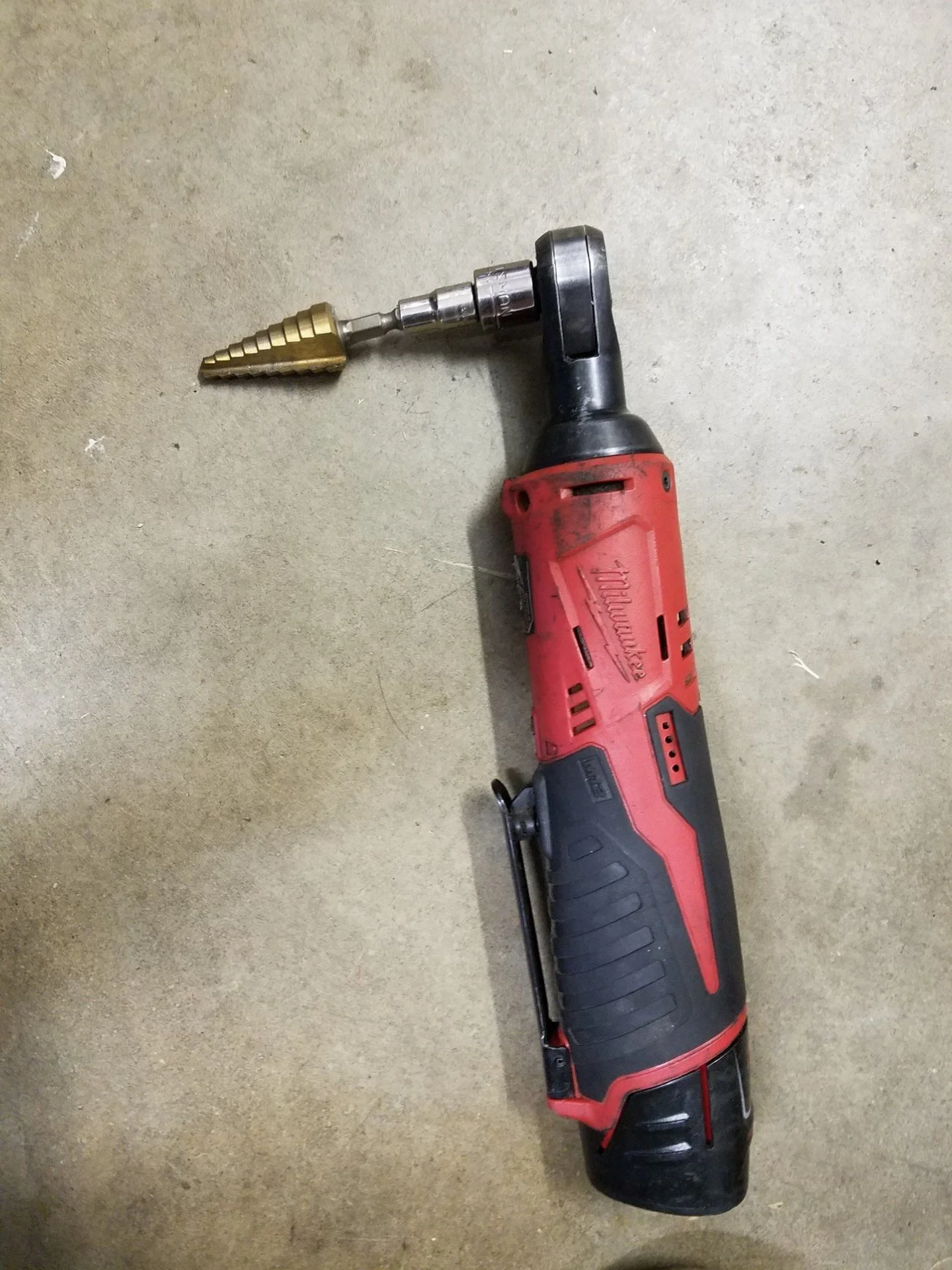

Here's the new brake light switch with NO and NC terminals. I had to enlarge the hole under the dash so it would fit. Got it done with my "rigged" right angle "drill".
full
full

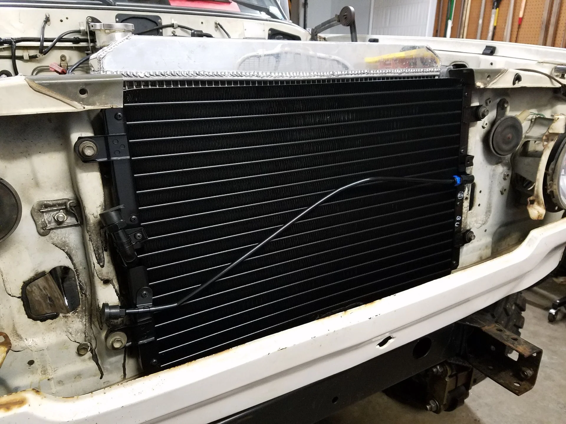

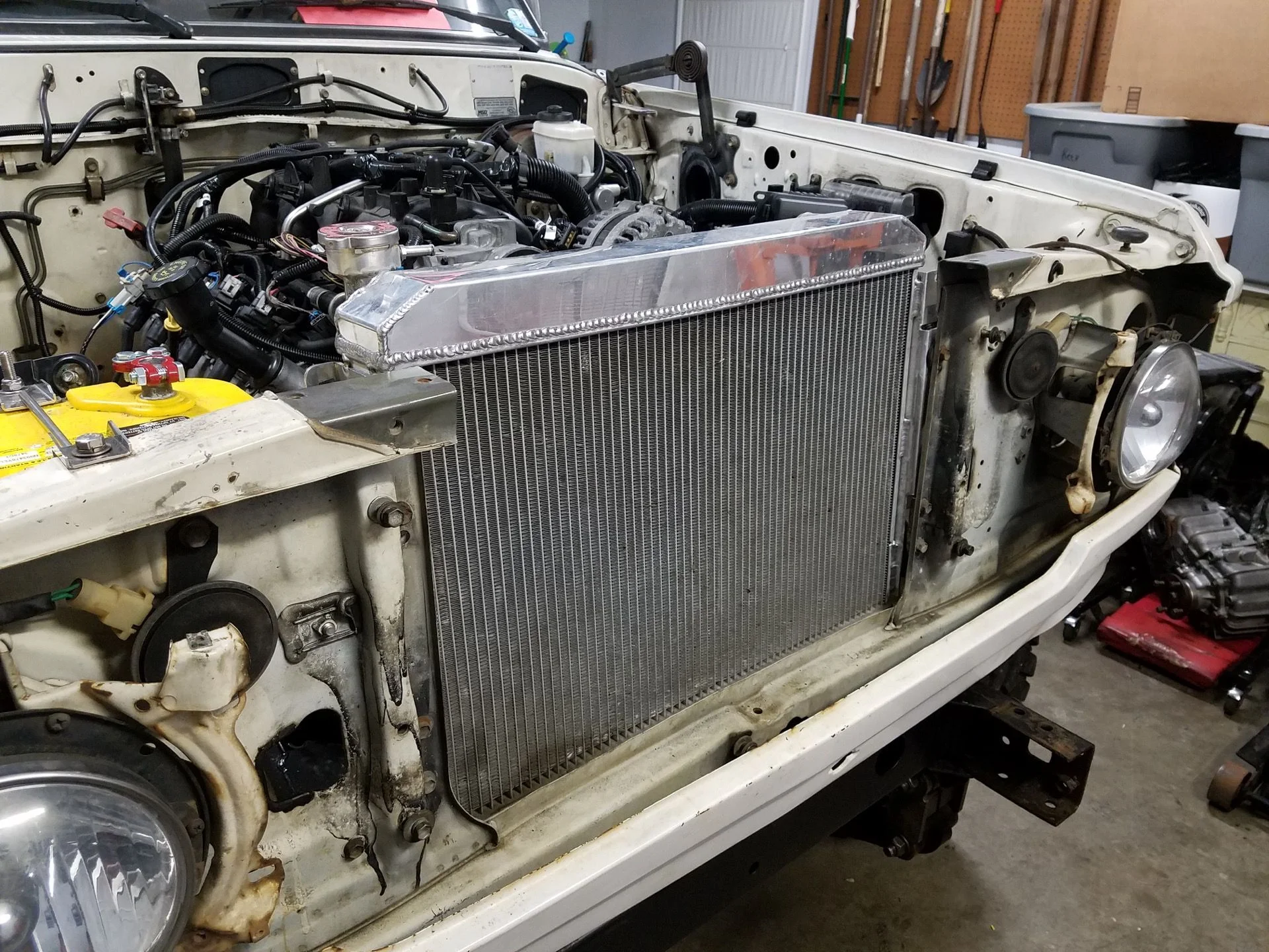

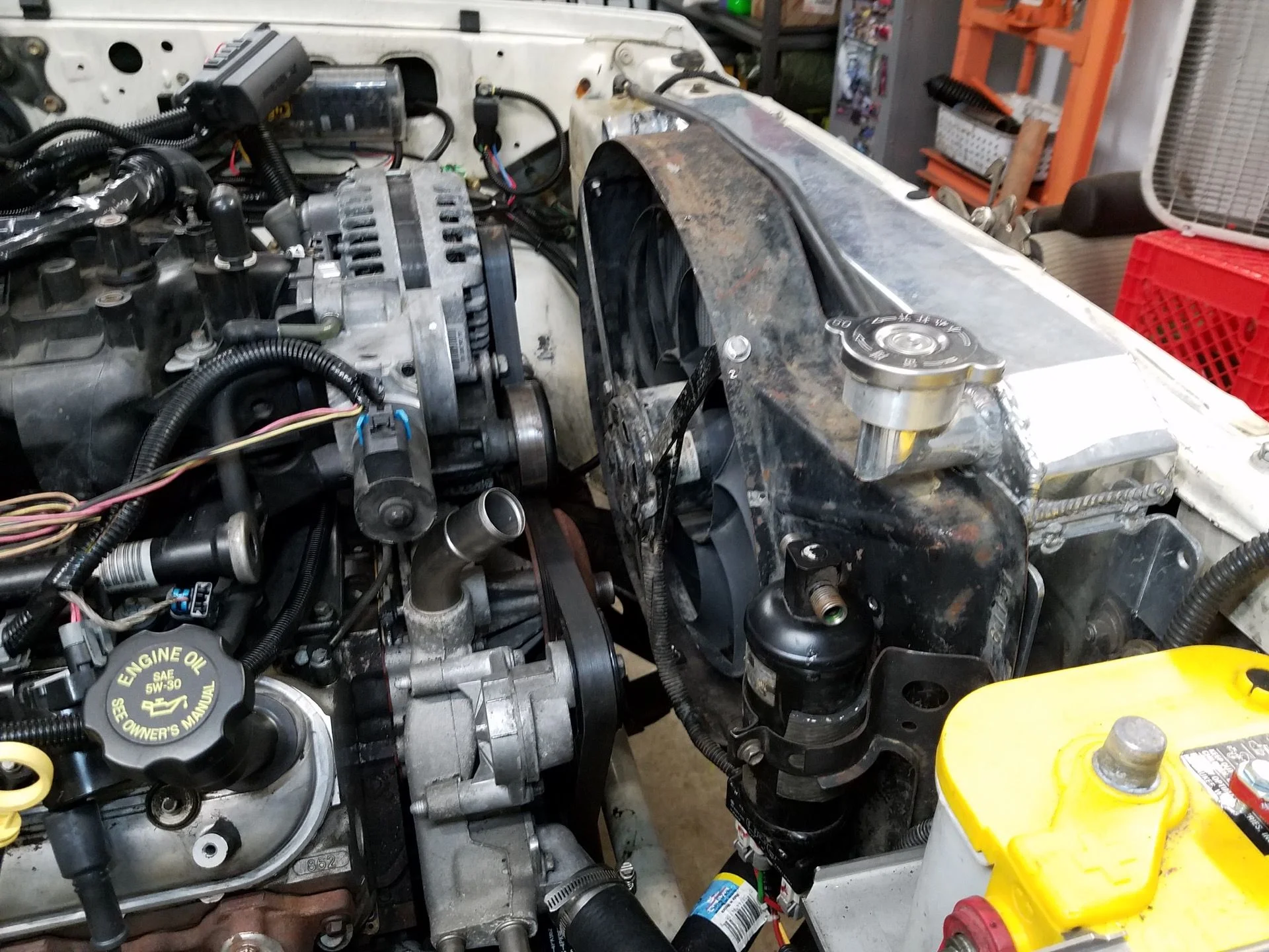

Reusing my Champion radiator, and decided to replace the condenser while it was easy to do.
full
full

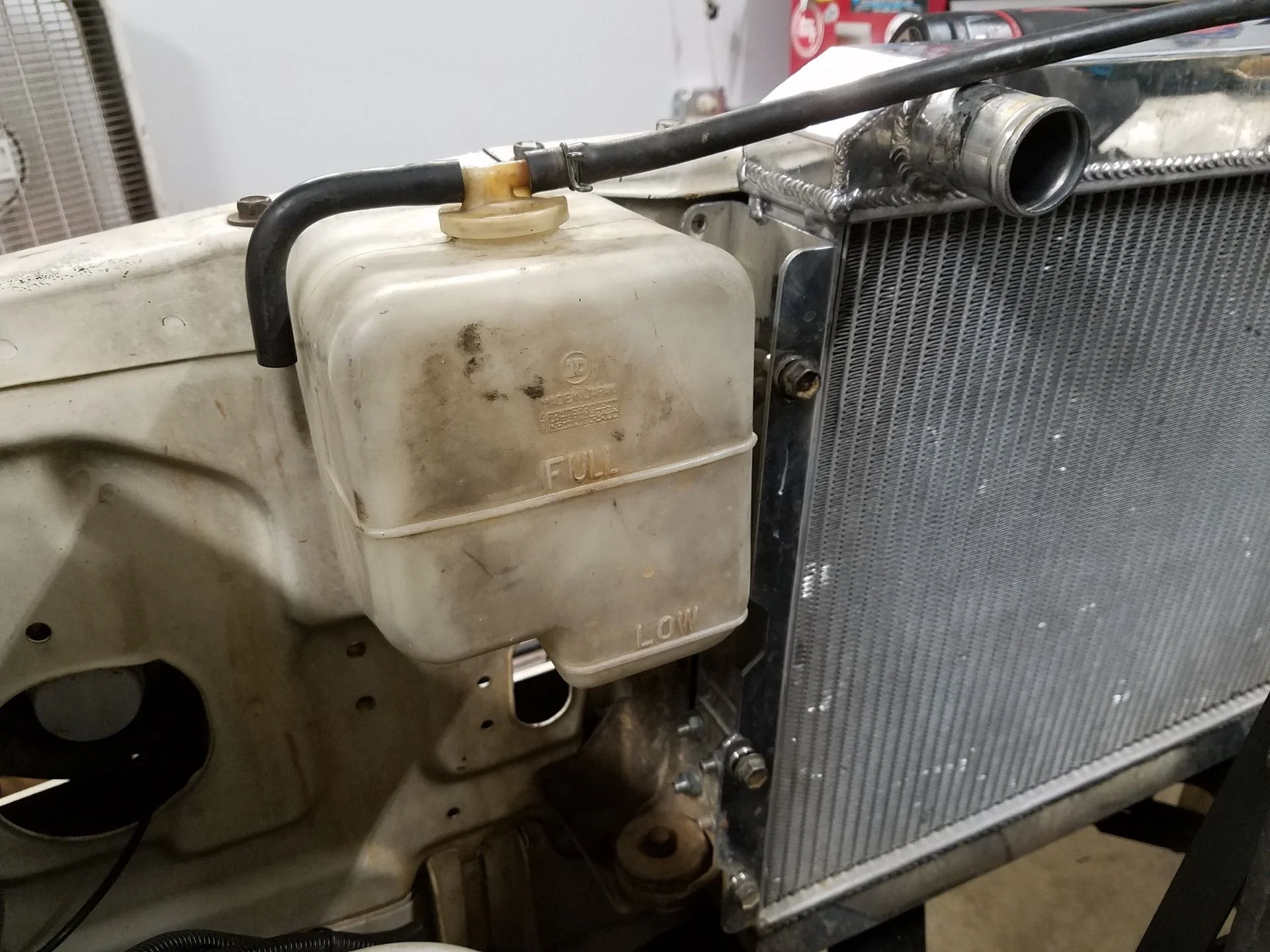

Sometimes it's the little things that make you smile. The previous owner used a universal Autozone overflow bottle, which was crap, but I was able to get an original from the classifieds. It bolted right on just like it should. :)
full

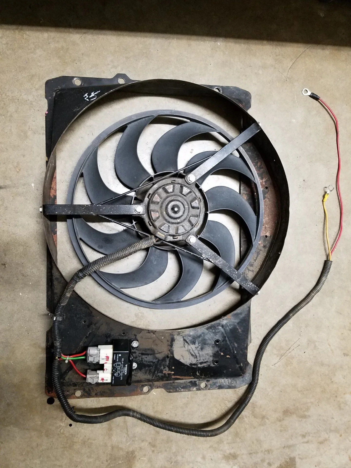

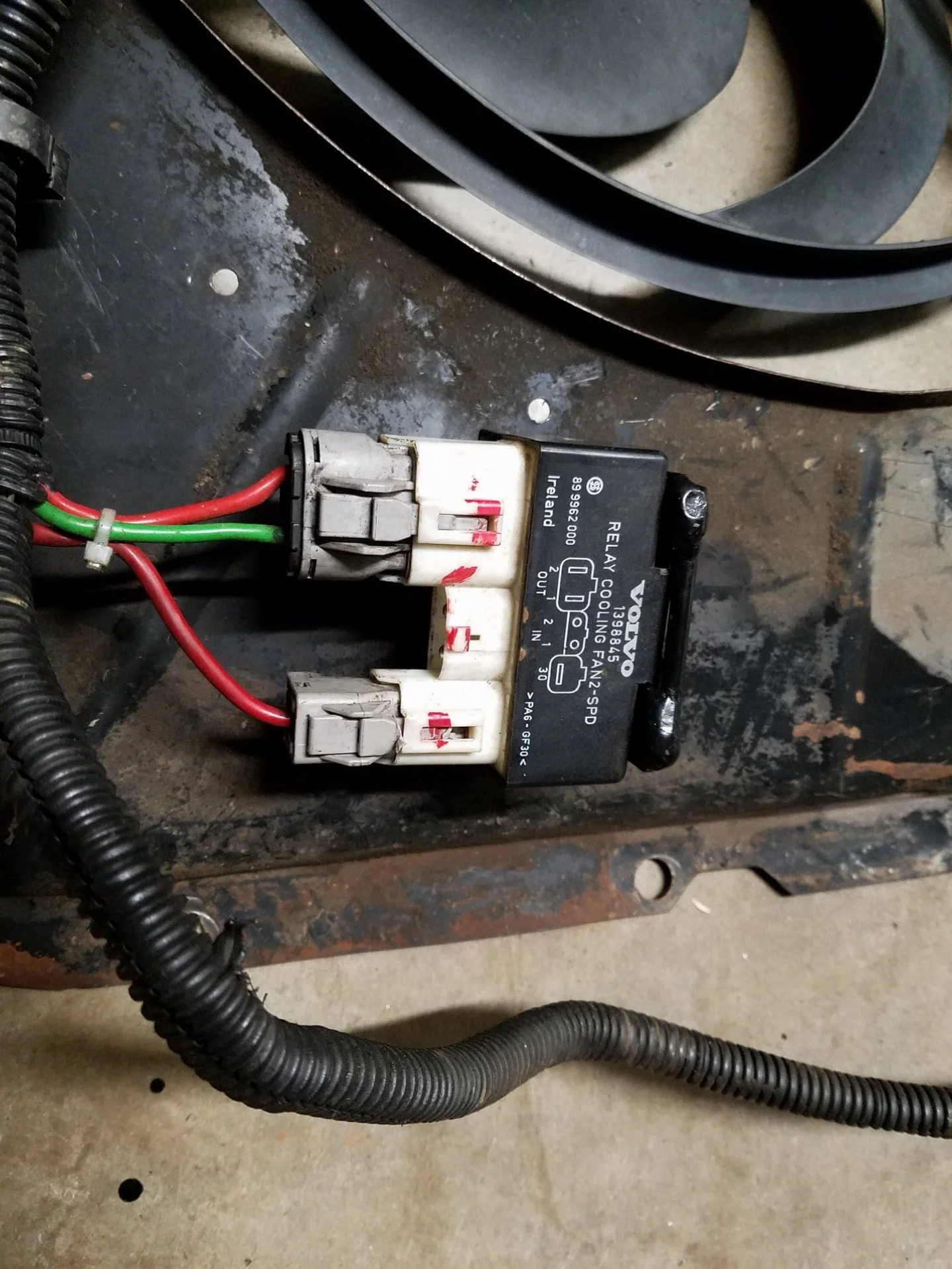

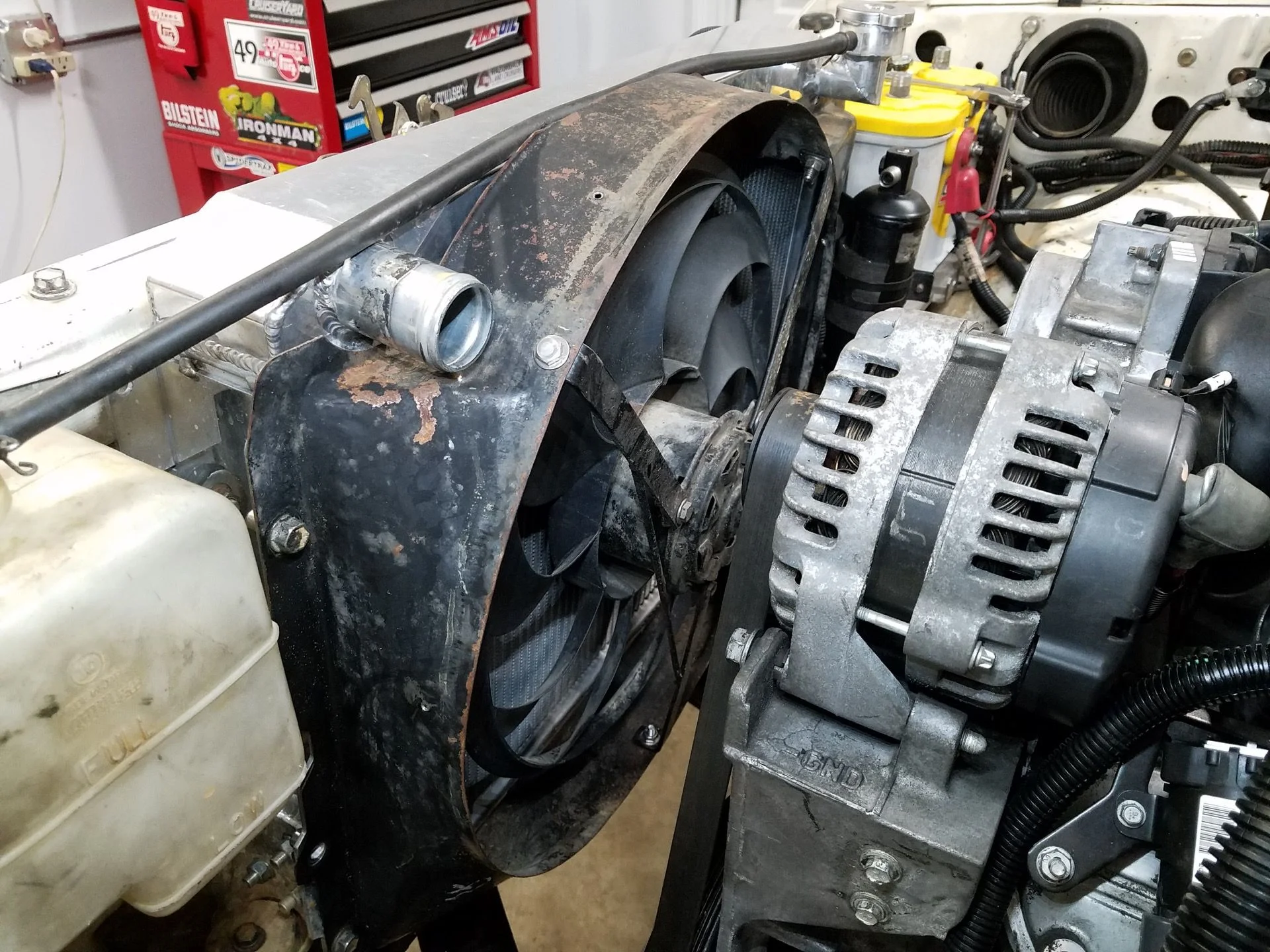

For cooling, I'm reusing my old setup which consisted of a Taurus 2 speed fan, an original FJ60 fan shroud, and a Volvo 2 speed cooling fan relay. Been doing this for a year or so now and it works awesome.
The plastic shroud the Taurus fan was mounted in didn't cover the radiator well, so I removed the fan motor, fabbed up a bracket to make it bolt into the FJ60 shroud, and called it done.
The relay can be found in the junkyard in certain Volvos (which use the same fan motor as the Taurus fan). You ground the 1 (Lo) or 2 (Hi) wire to engage the relay and run the fan. The LS ECM turns fans on the same way - by grounding the relay signal. So, I could use the ECM to control the fan, but I'm sticking to my switch in the cab for now. BTW, grounding the Hi wire overrides the Lo wire, so they can be grounded at the same time.
full
full
full

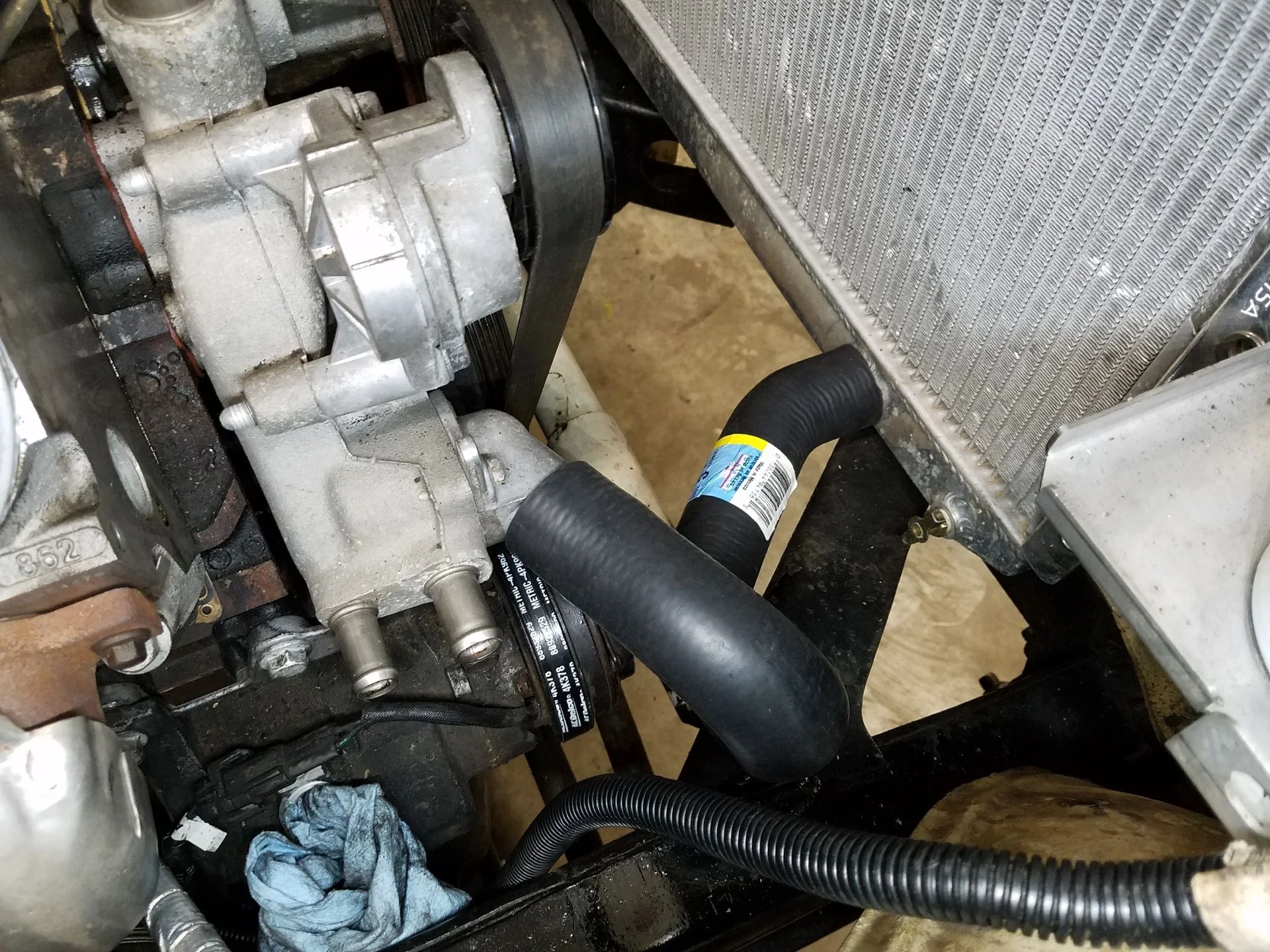

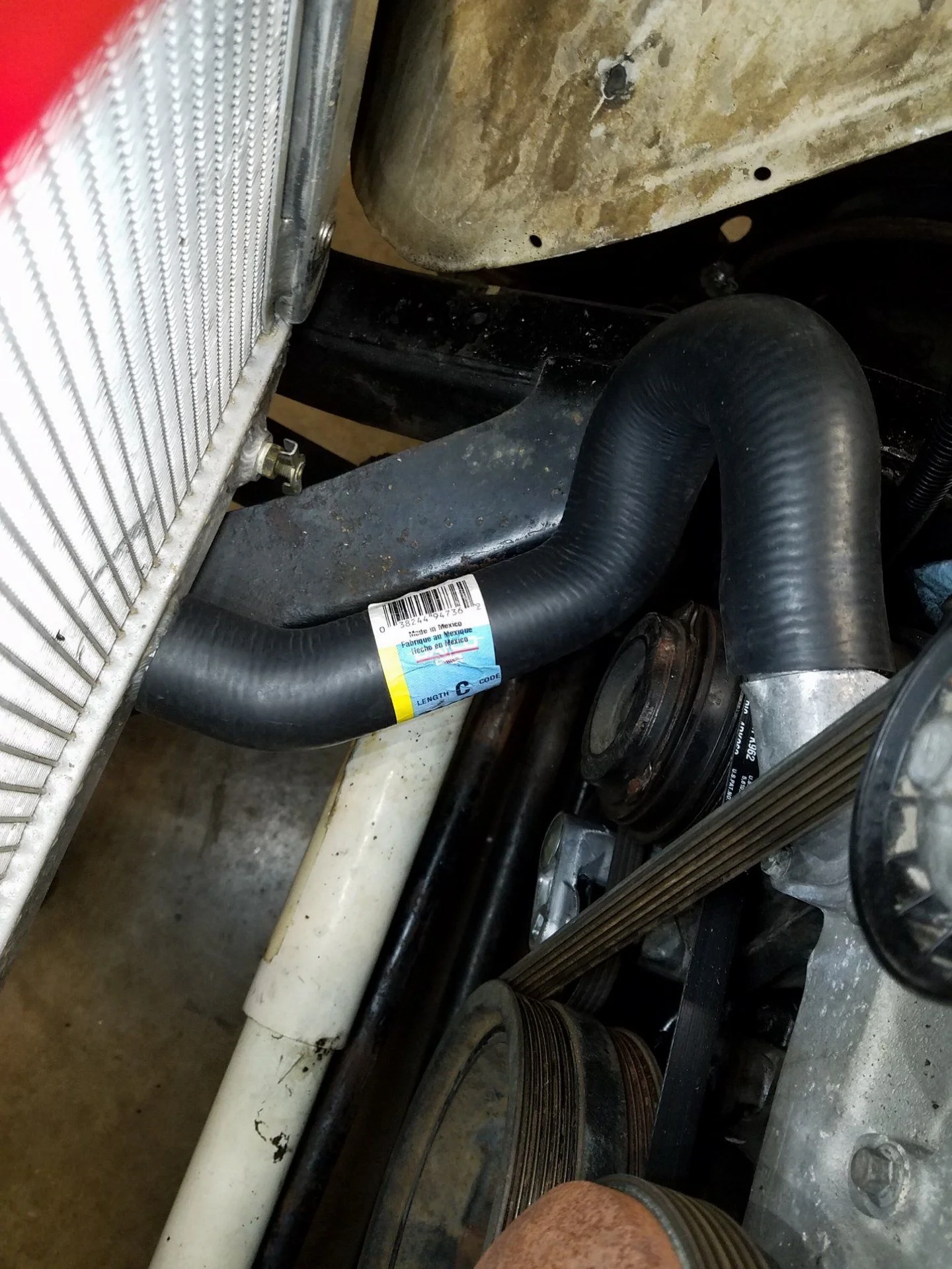

Lower radiator hose is from a 2000 Ford Explorer 5.0L. It's the Explorers upper hose. Common part numbers are GATES 22310 and DAYCO 71903. Have to trim some of the radiator side off, but other than that, it's a near perfect fit.
full
full

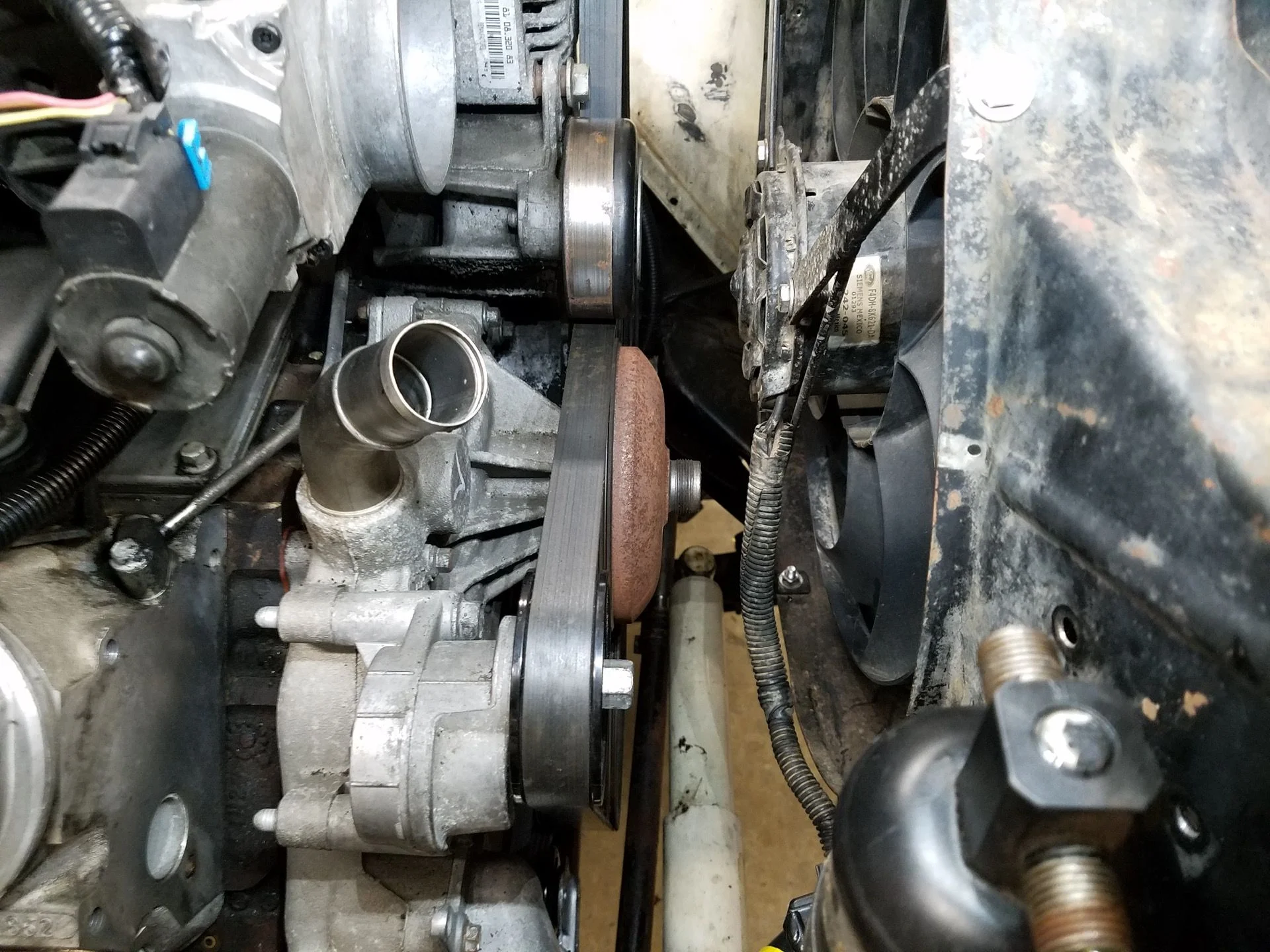

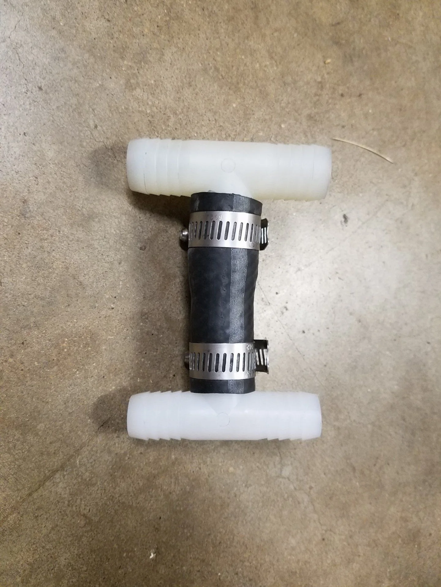

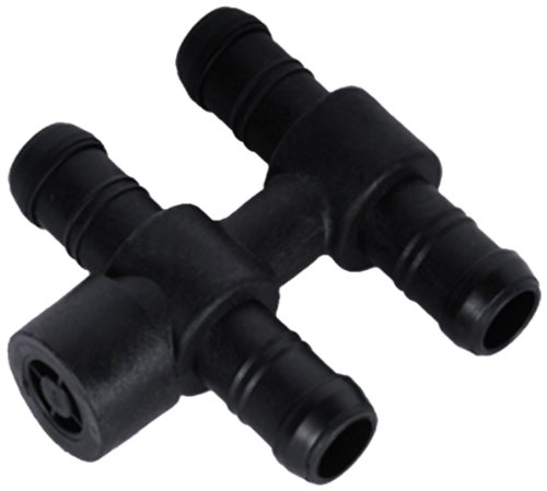

So, I've seen quite a few LS swaps on this forum and other places, and everyone seems to complain about it running hot with stock radiators and different cooling fans. Be sure that your heater ports on the water pump complete a loop, even with the heater off. Why? The thermostat won't operate correctly without the loop, and the water will cavitate in your pump and not move the water like it should.
Solution? Use an "H" pipe. I build mine from plumbing parts (proof of concept), but there are OEM parts you can get that do the same thing. You can make it out in the picture above, down by the water pump ports. Your heater core will still get hot in the winter using an H pipe.
full
Eventually I will replace it with an OEM GM part. ACDelco 15-5675 "Heater valve". It's out of a 2000-2002 Chevy Cavalier.

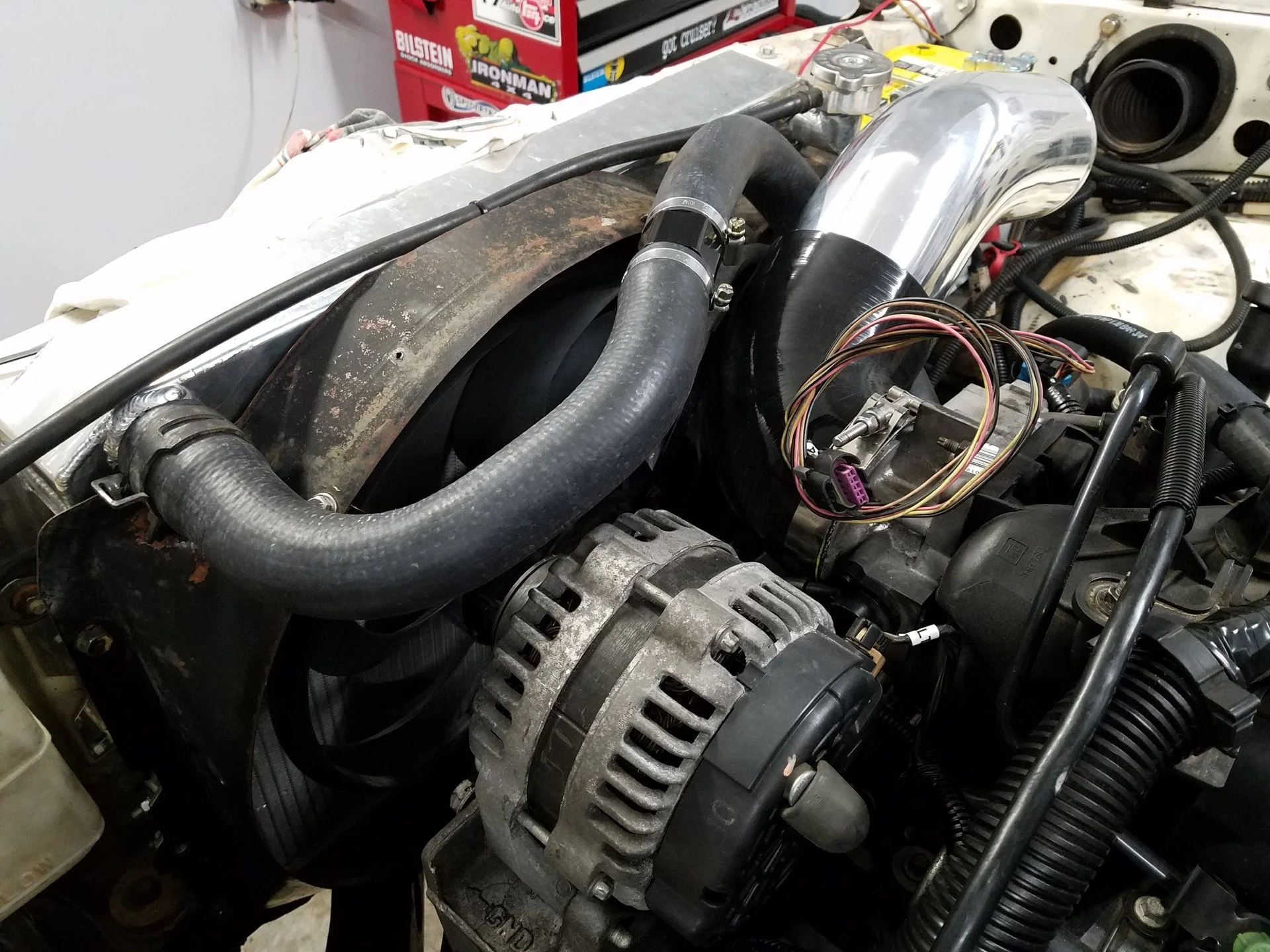

Upper radiator hose. My motor came with the original hose from the junkyard, so I used it to mockup how I want it route, then I went and bought a new one from a 2002 Tahoe. The radiator end is the same radiator end as the Tahoe hose, but I had to stretch it a bit over the radiator. The water pump end is the same as the water pump end of the Tahoe hose.I removed a foot or so in the middle.
The connector in the middle is a Mishimoto Water Temperature Sensor Adapter (34mm). There's an 1/4 barb on the bottom, and the steam port hose is connected to that.
full
full

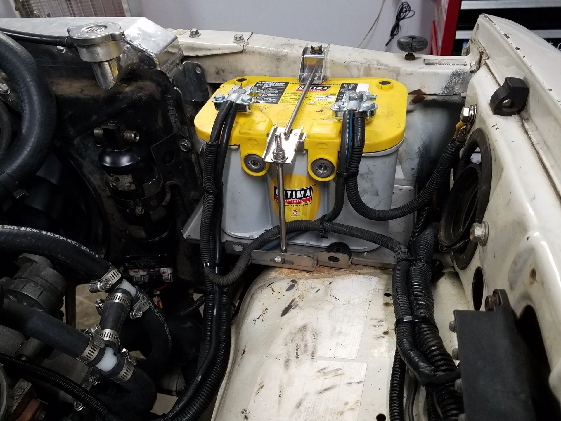

I wired up the battery connections and grounds. Didn't have to buy any wires, as I made sure the junkyard kept them all attached to the motor when they pulled it. Had more than enough. :)

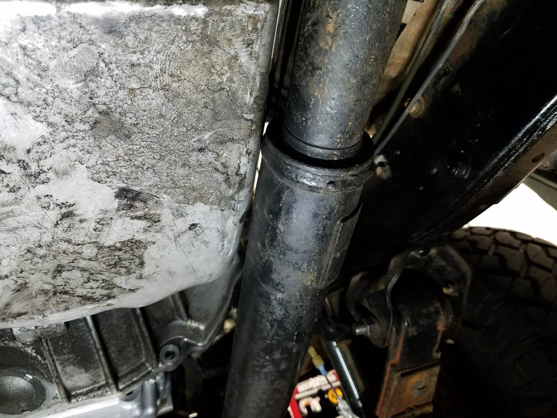

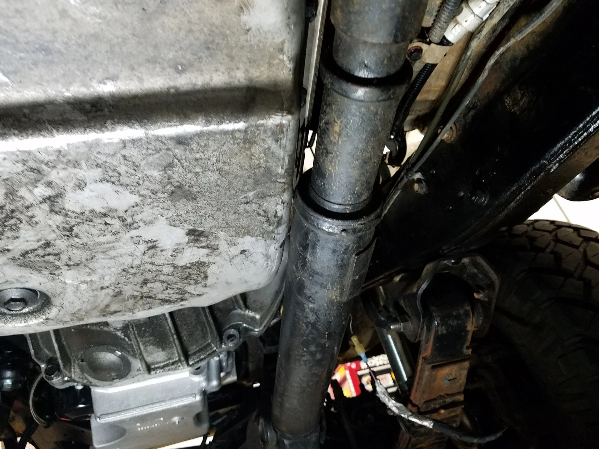

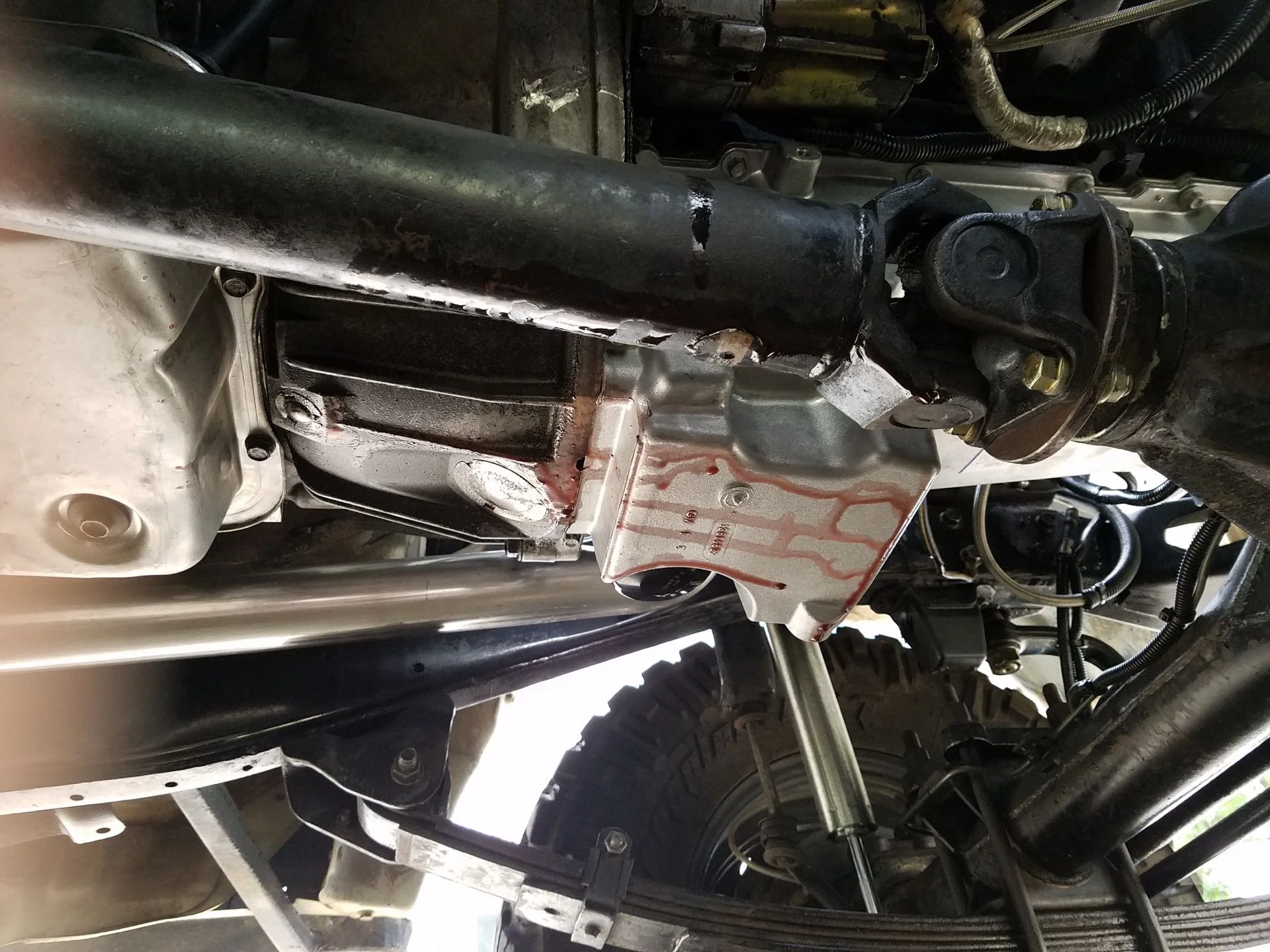

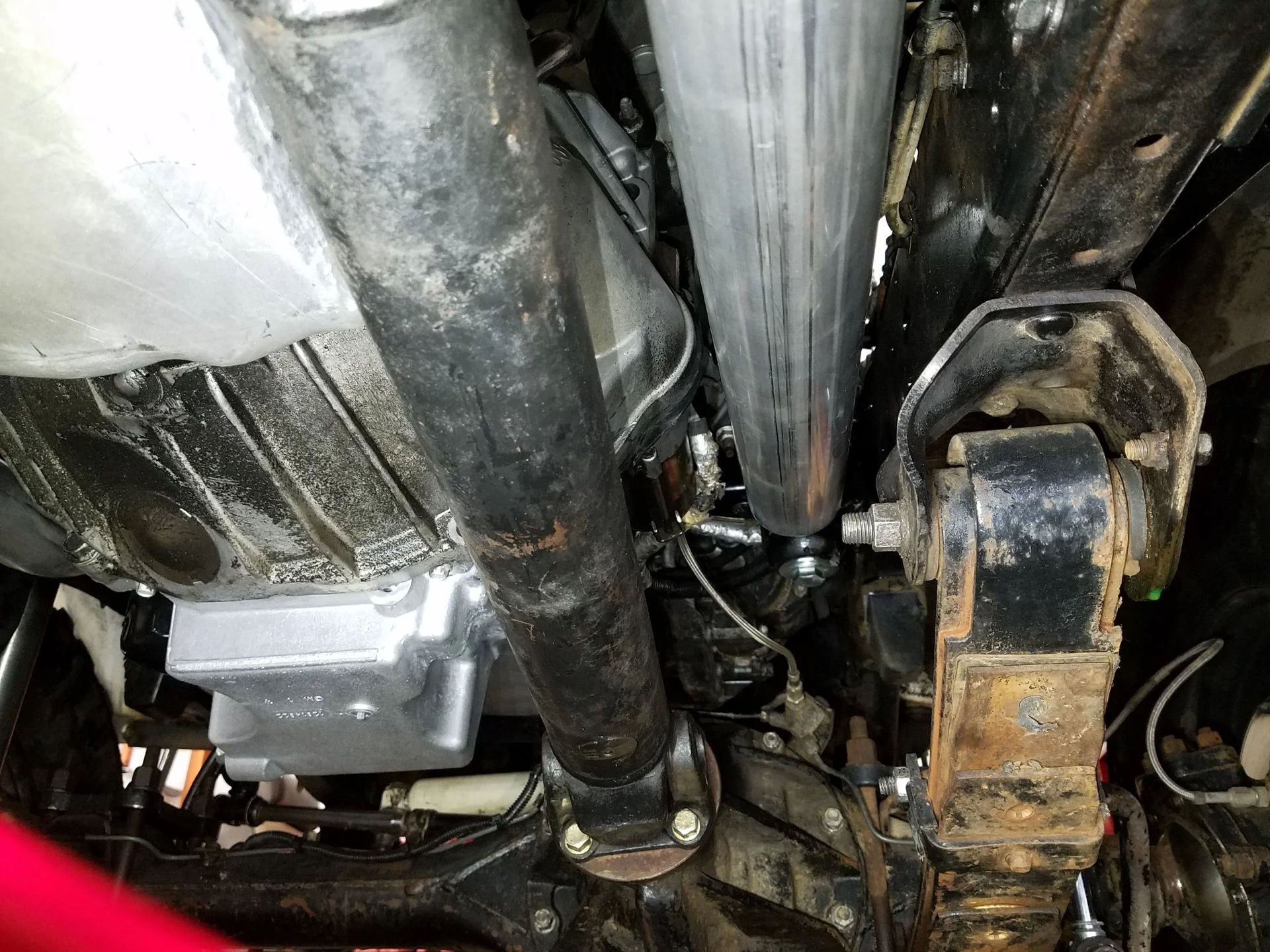

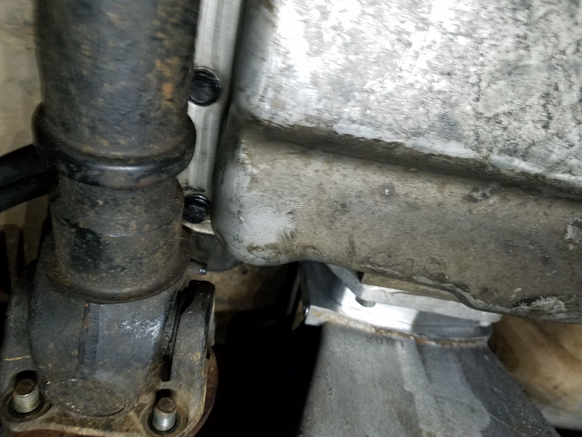

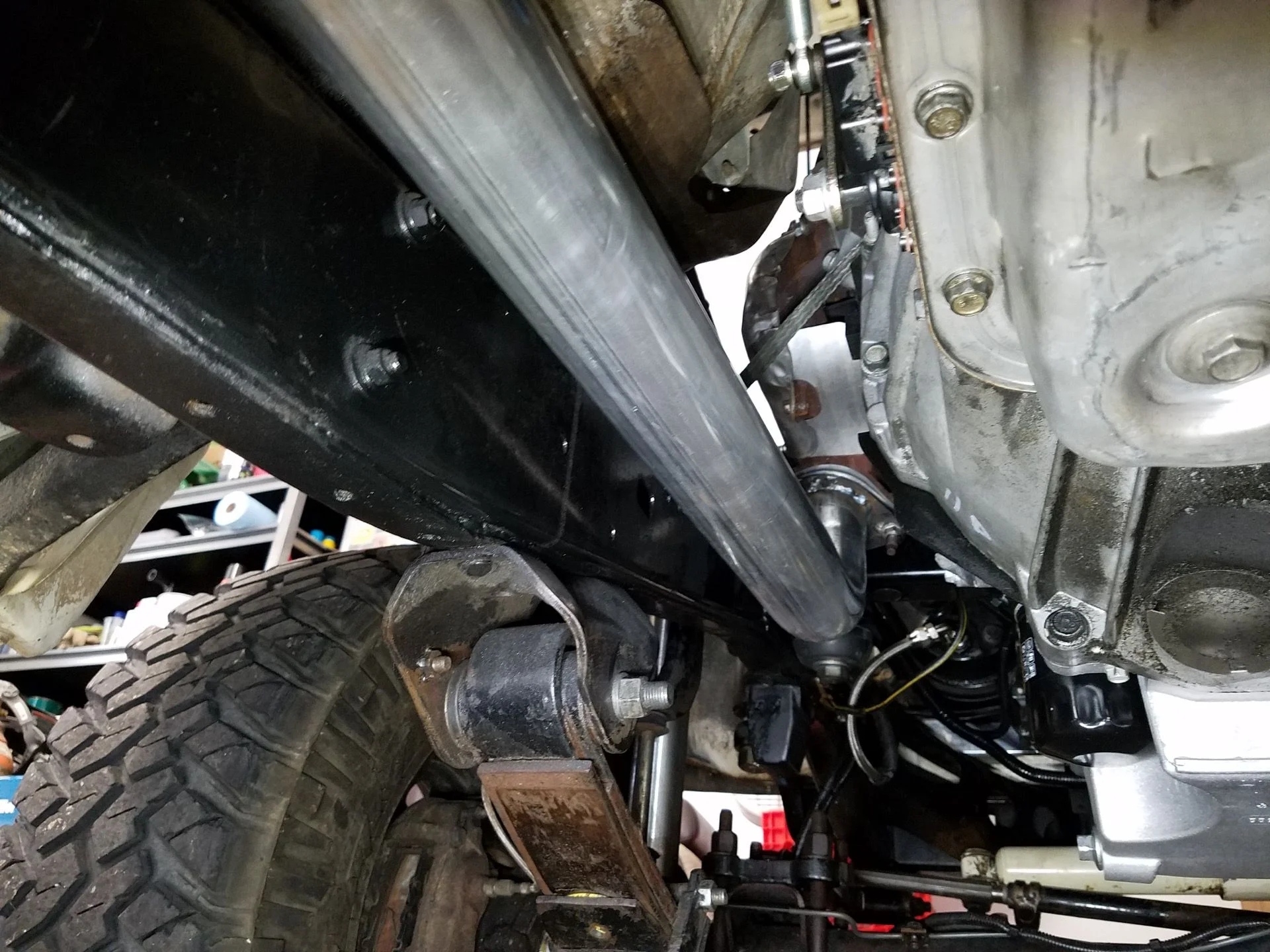

Then it was time to figure out how bad the front driveshaft clearance was going to be. It was closer that I expected, but I still needed to modify the pan. I chose the "beat it until it fits" method first. :) Later I may cut and weld it with more angle in it, but it starts getting into the filter area. More than likely I will need to get another driveshaft made with smaller tubing. My current shaft is a stock one that has been made longer for my older swap.
full
full
full
It's tight around the corner of the pan at the tcase output, but it should be fine as long as the ujoint doesn't grenade (doubtful with the way I wheel).

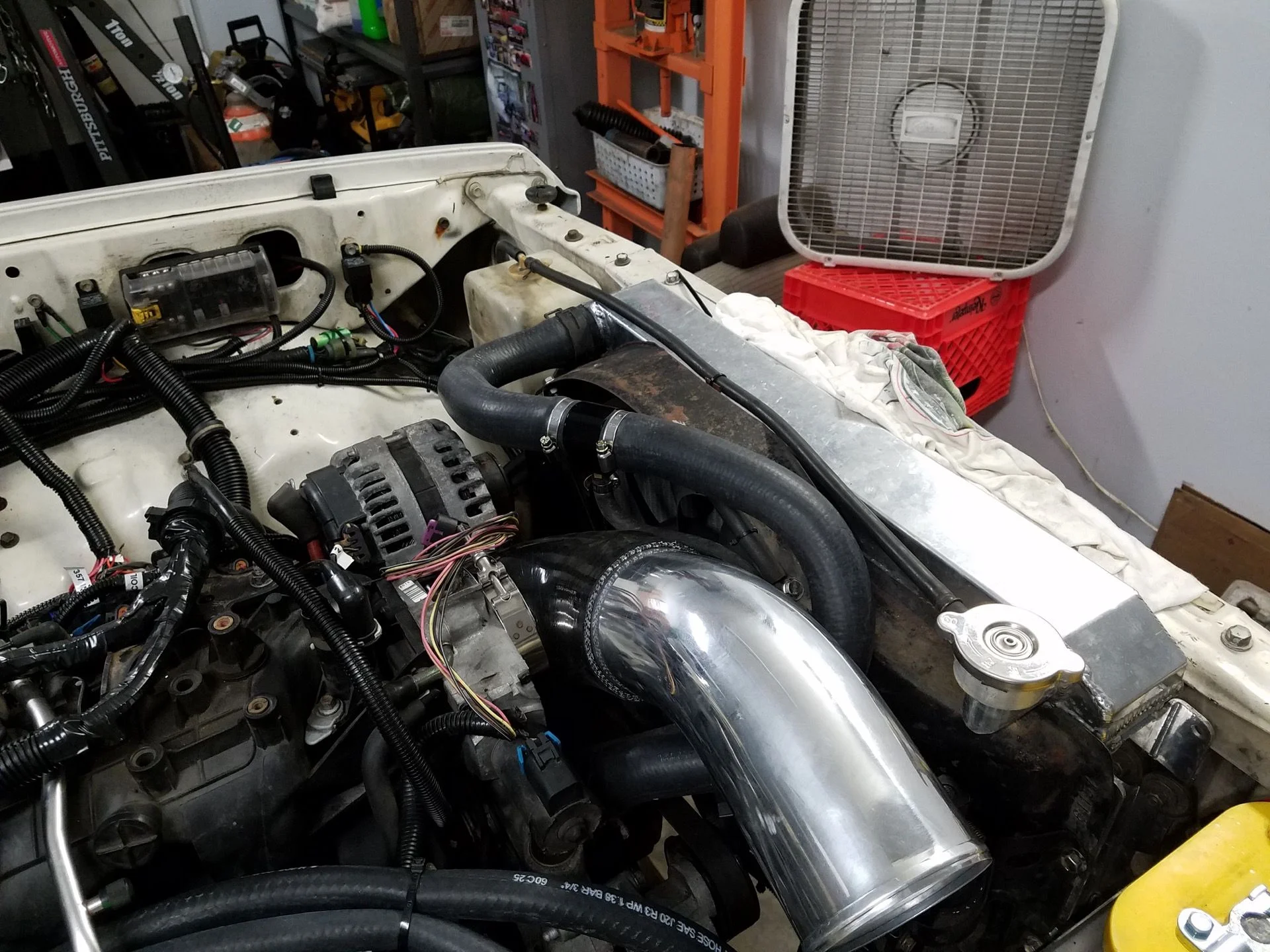

For the intake hose, it was mandatory that the snorkel be connected. Why have it if it's not functional? When I bought the cruiser, the PO didn't have the flexible hose that goes inside the fender, so it was purely a "poser snorkel" for a long time.
I got a box of silicone couplers and T clamps from siliconeintakes.com. Gives it that racecar tuner look. :)
Starting at the throttle body, it's a 4" 90 degree elbow.
Then a 4" aluminum tube with a 45 degree bend in it. This was to clear the radiator hose.
Next is a 4" to 3.5" reducer to the MAF sensor. The 3.5" side has to be compressed a bit since it's a loose fit.
From the other side of the MAF it's a 4" to 3" reducer.
And finally the air cleaner. It's an inline, sealed, conical unit made by Spectre. It has 3" in and out, which matches the snorkel hose, which is attached on the other end.
full
full
Later I would like to use a FJ62 air cleaner assembly with a modified lid for the MAF. I'm not a fan of the inline air cleaner, but it works for now. And by "for now", I mean street driving duty.

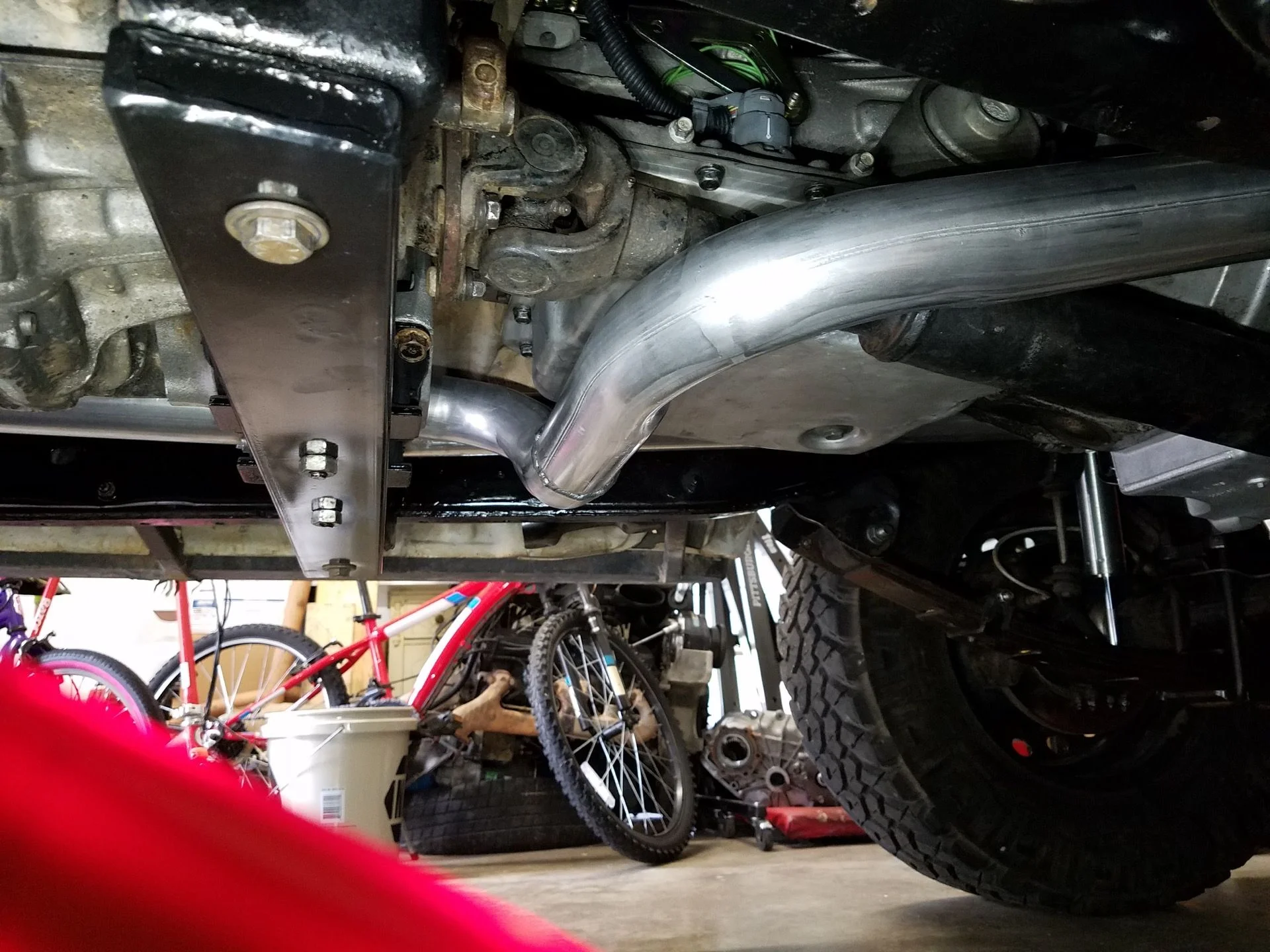

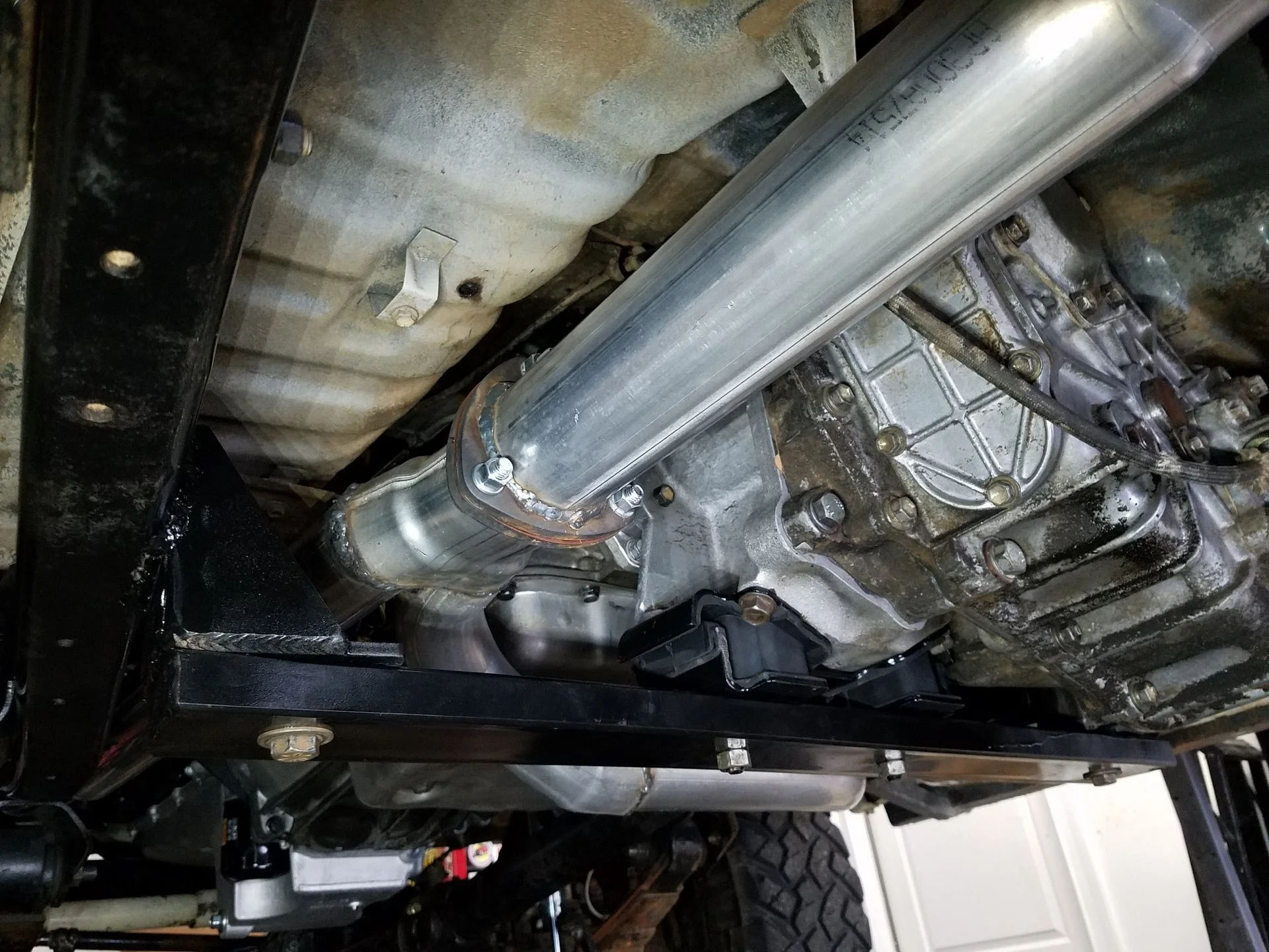

Before I could do any test drives, I had to get the exhaust done. There's a great shop near us that is owned by a Land Cruiser guy called Arkansas Performance Exhaust or APE for short. I dropped it off on a Wednesday morning and Jason had it done by Friday afternoon.
Went with 2.5" from the manifolds back to a Y pipe. Then it went to 3" into a 24" Magnaflow, and then 3" out the back. All the piping from the previous motor was 2.25", so this was a big improvement. I never realized how choked up the other motor was.
full

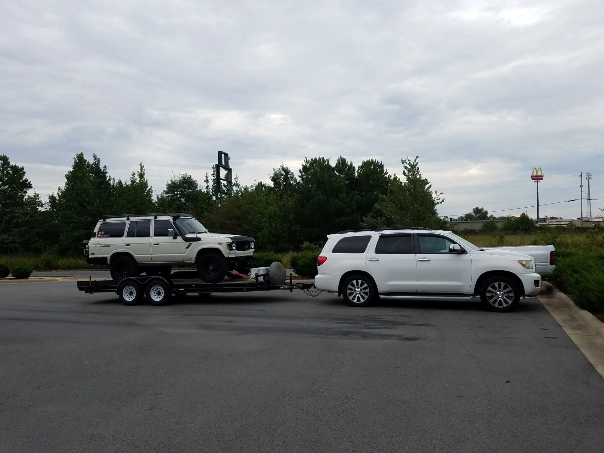

First time towing this heavy of a load with my Sequoia. It handled it pretty well. I wouldn't want to tow this heavy all the time with it. I worry about the IRS rearend and towing.
full
full
full
full
I chose to drop under the trans right in front of the tcase to join to the driver side. I've studied most of the swaps on here, and I wasn't a fan of going higher above the tcase due to heat concerns. This crossover clears the driveshaft no problem, lets me remove it if needed, and doesn't hang any lower than the tcase or the crossmember. The downside is that it blocks the transmission and I can't get the pan off easily. I had APE put in a junction just after the Y pipe so I could drop the pipes down for servicing.

- Front driveshaft still hits the trans pan, just barely. Need to price a new, skinny shaft.

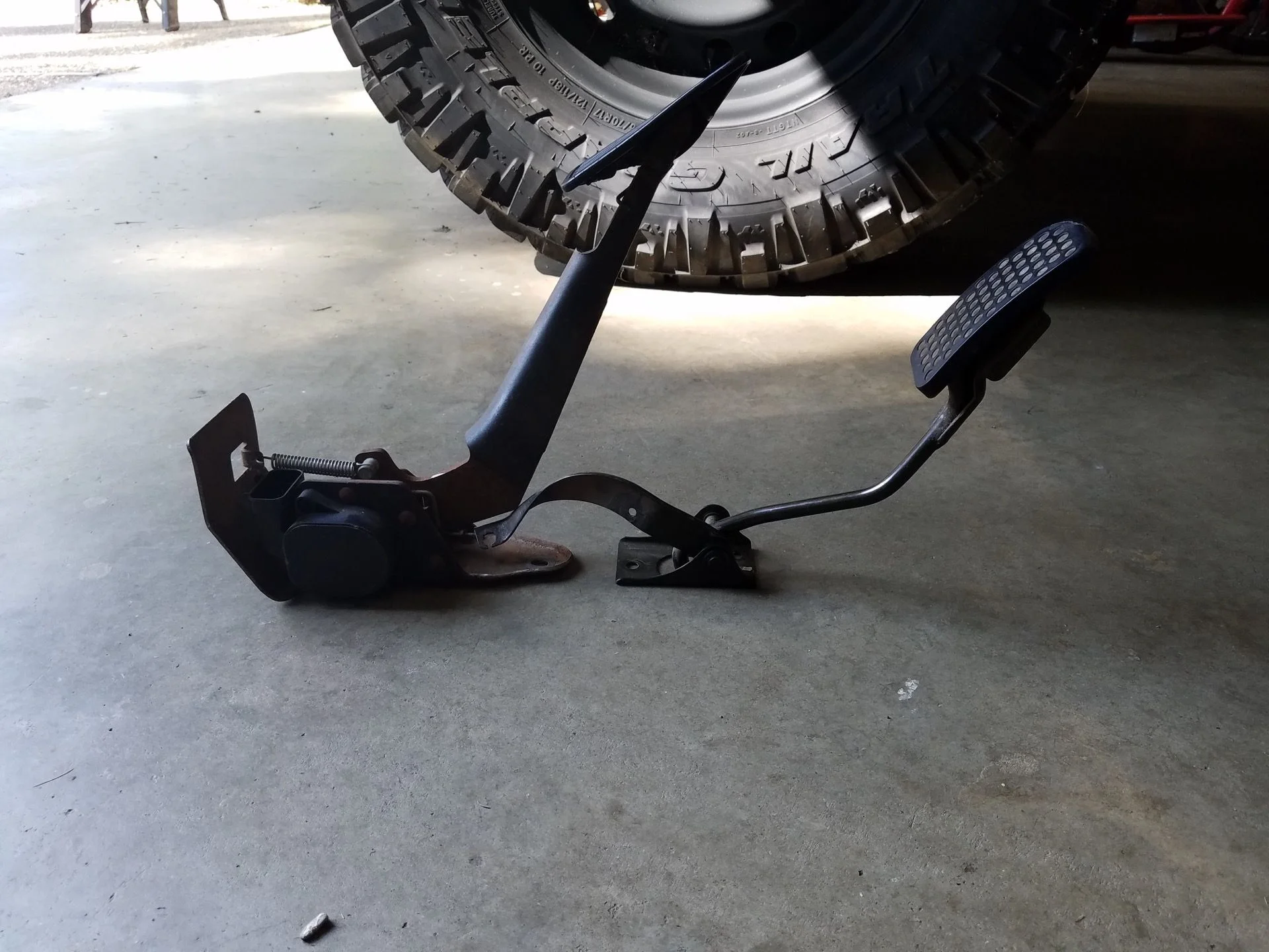

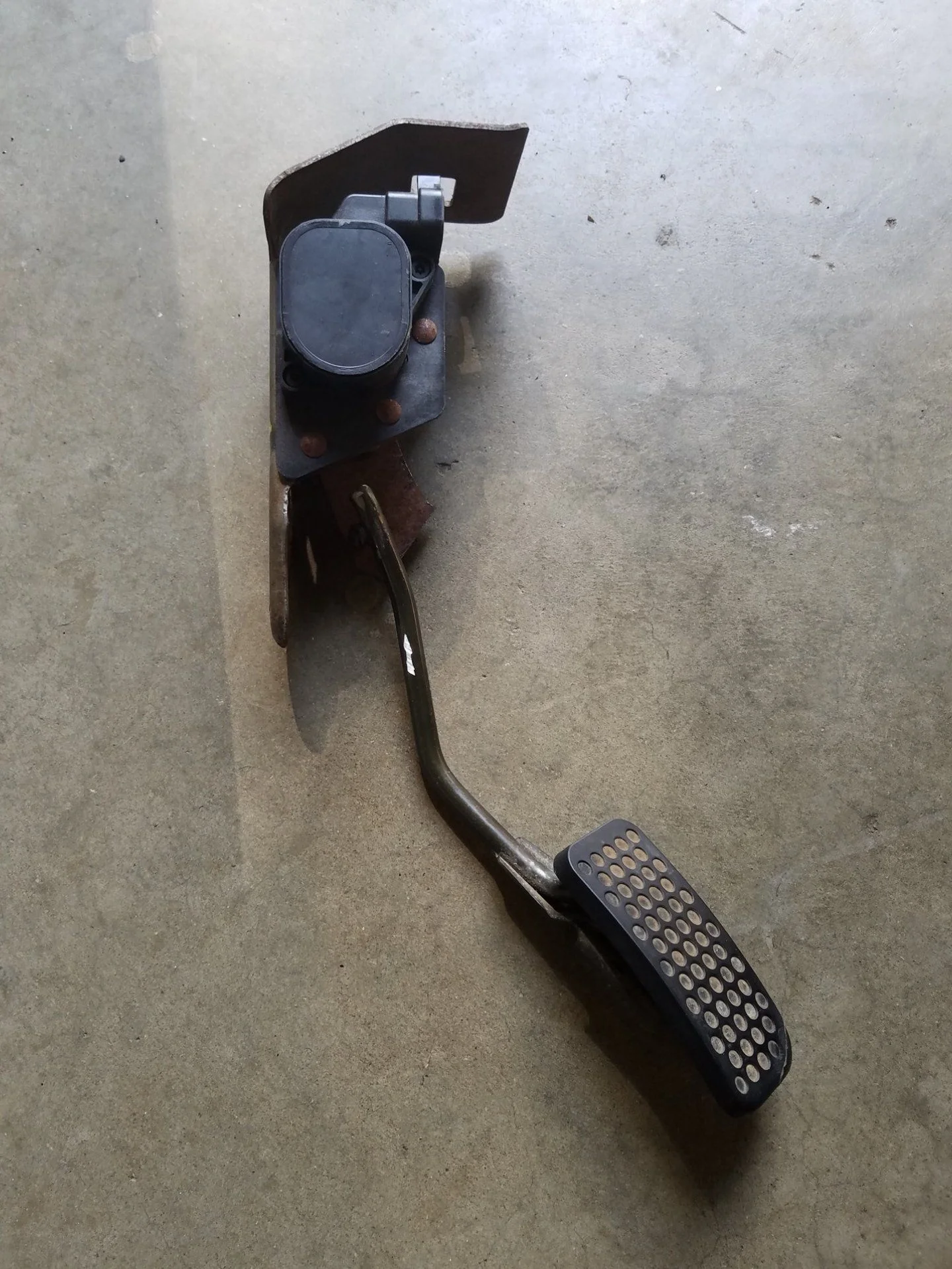

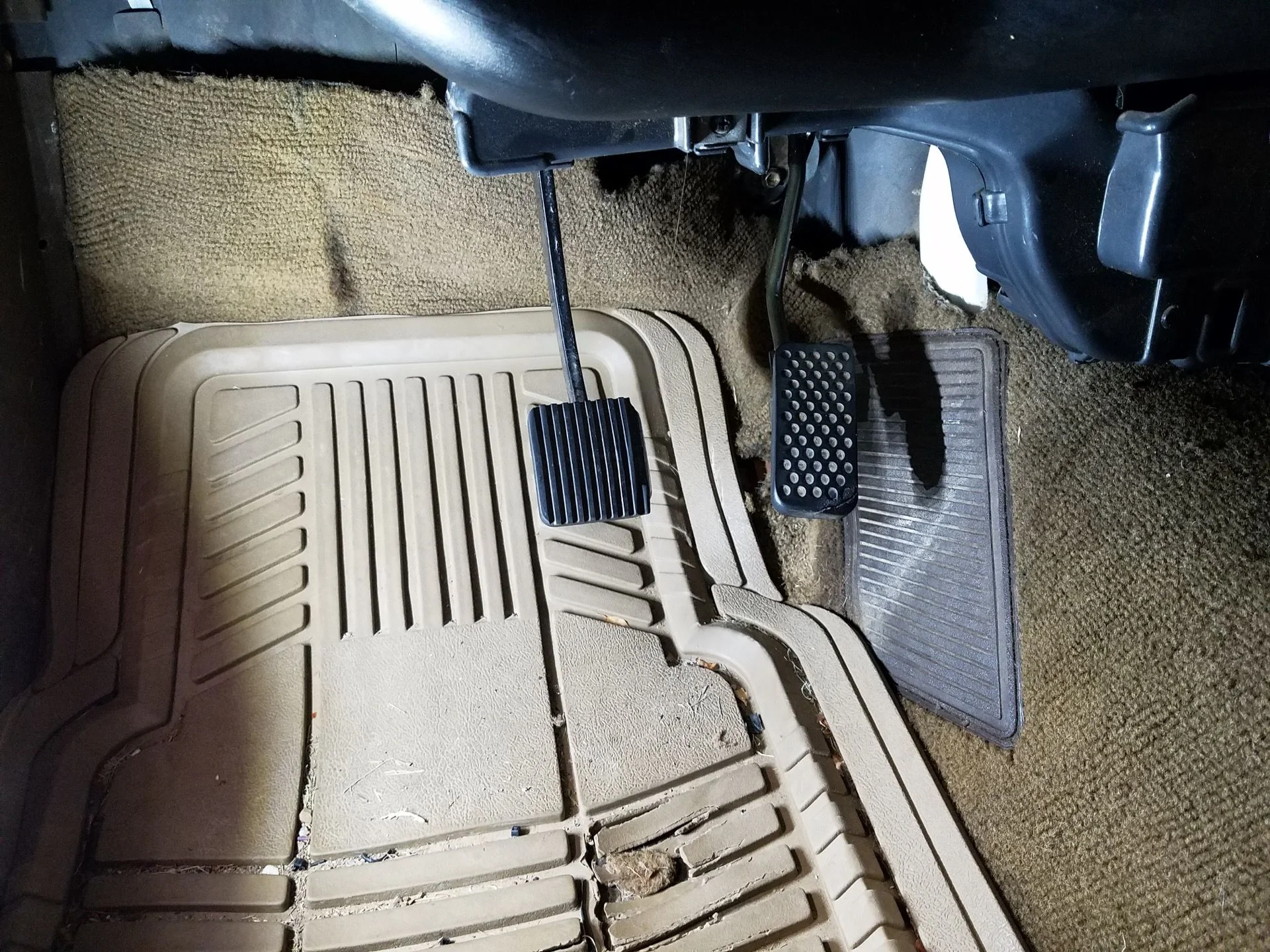

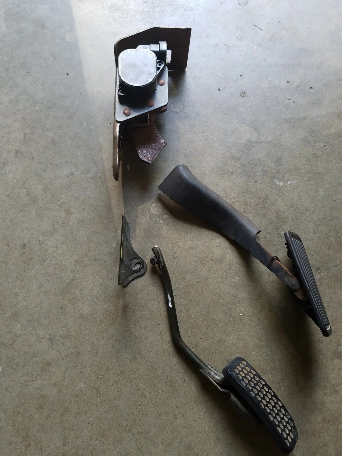

The gas pedal solution was brilliant. I lowered mine and it's still too high. I'm going to do what you did.
