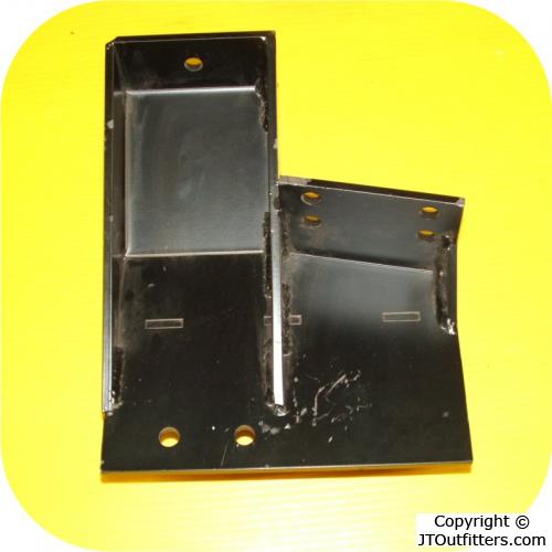

You can do a mini truck, FJ60 or FJ80 box and stay Toyota, the other good option on a 55 is the Scout Saginaw. There is a factory 55 PS box, but its a golden unicorn since it was only an option on '78-'79s and you'll pay too much if you find one. The issue you'll run into with the first four I mentioned is the shock tower is in the way, there used to be a shock mount that incorporated the mini truck mount if you can find one or most people go with modded Ford towers or hoops with the other three.

The part number for this Ford tower is E5TZ-18183-A, lots of good info for you here:
https://forum.ih8mud.com/fj55-iron-pig-preservation-society/129643-fj60-power-steering-pigs.html
