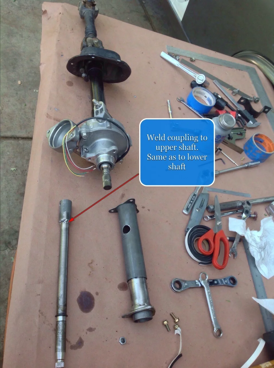

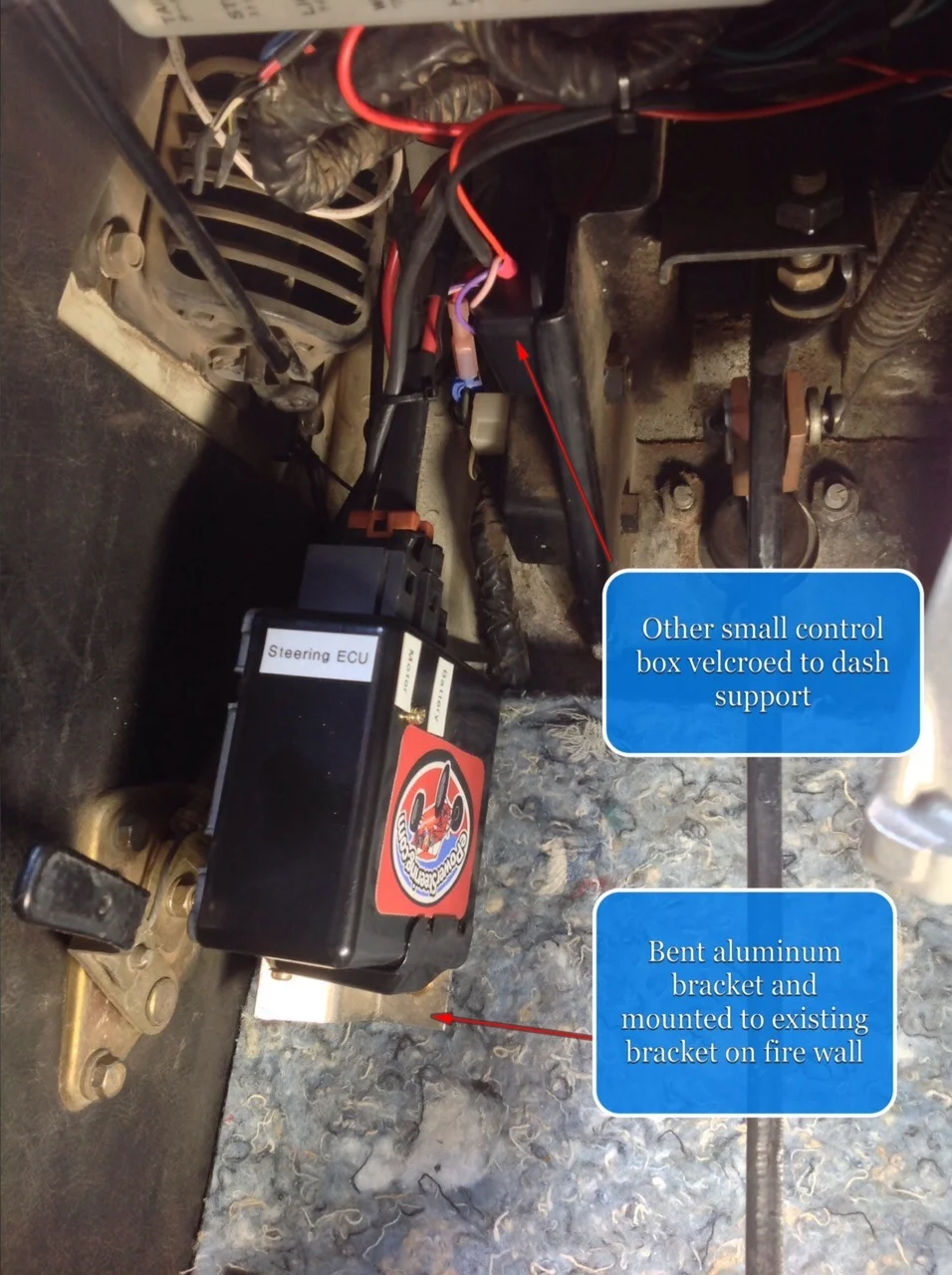

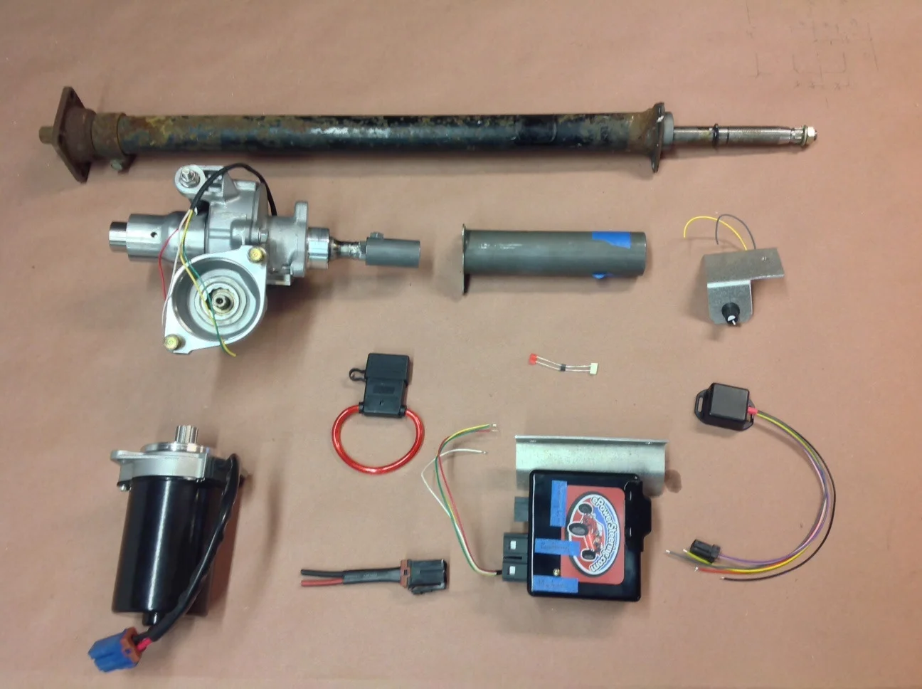

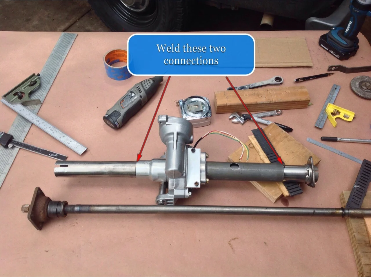

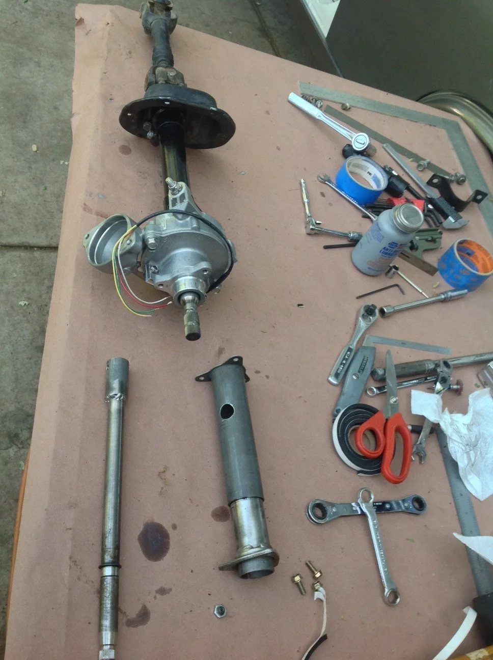

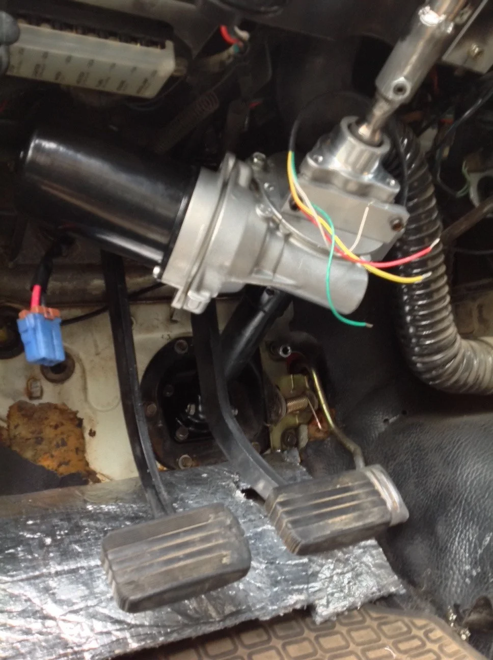

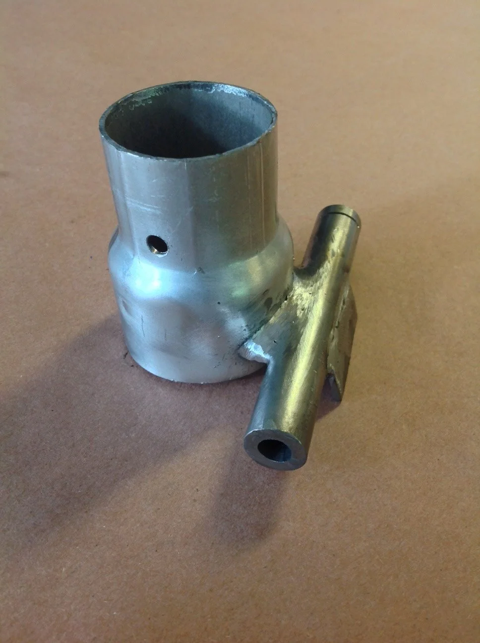

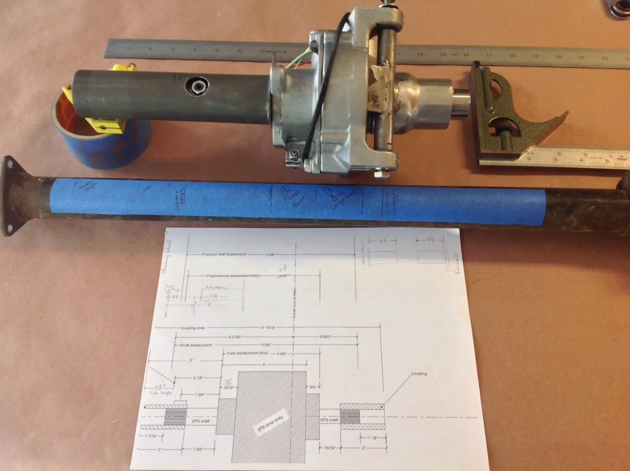

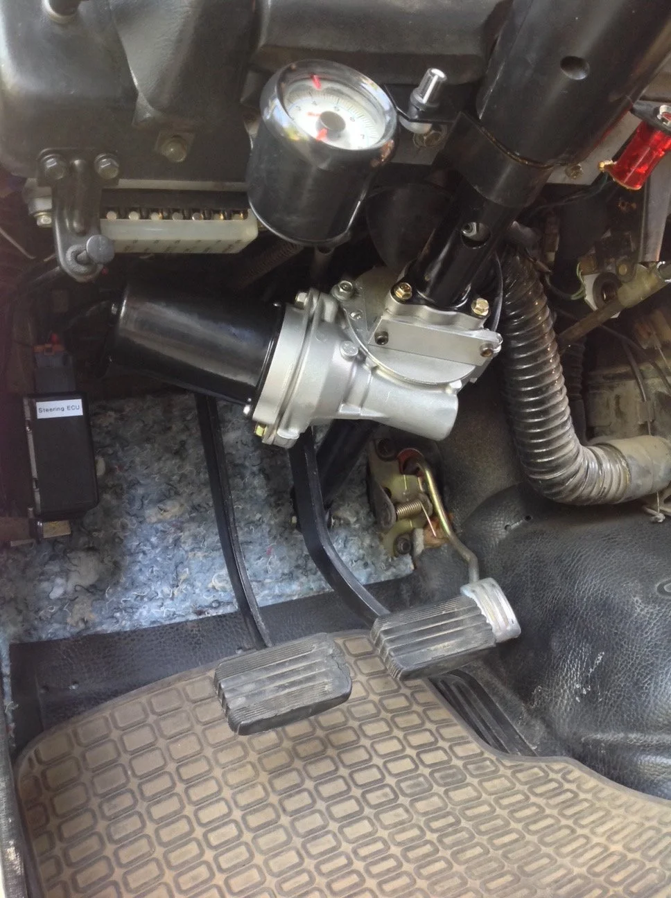

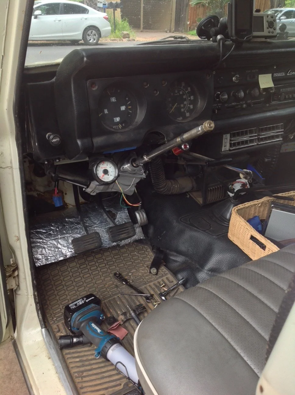

I purchased my E power steering kit from ”epowersteering” (not trying to sell this supplier over any other) for around $550 about 4 or 5 years ago. I am not a professional welder put have a small mig unit for my car hobbies. I spent about 4 hours plotting out the install and started working on it Saturday morning and Sunday evening I had power steering functioning in my pig.
It was by far the best mod to my swine ever.. I was blown away...
It’s a dream off road in tight situations and takes a beating no problem.
More pics
Again not trying to sell anyone on any particular brand

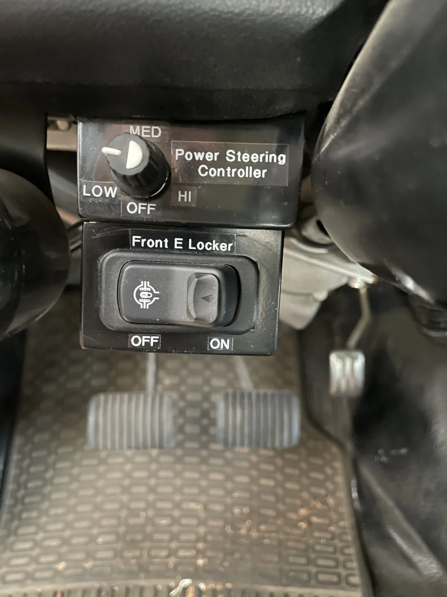

I have the electric PS on my BJ45 and love it. Until recently it has worked flawlessly and the wife can drive the troopy without any difficulty. We liked it so much I purchased the same unit from City Racer for our 40 project. They tuck away nicely and you can adjust the gain dependent upon you driving trails or highway.

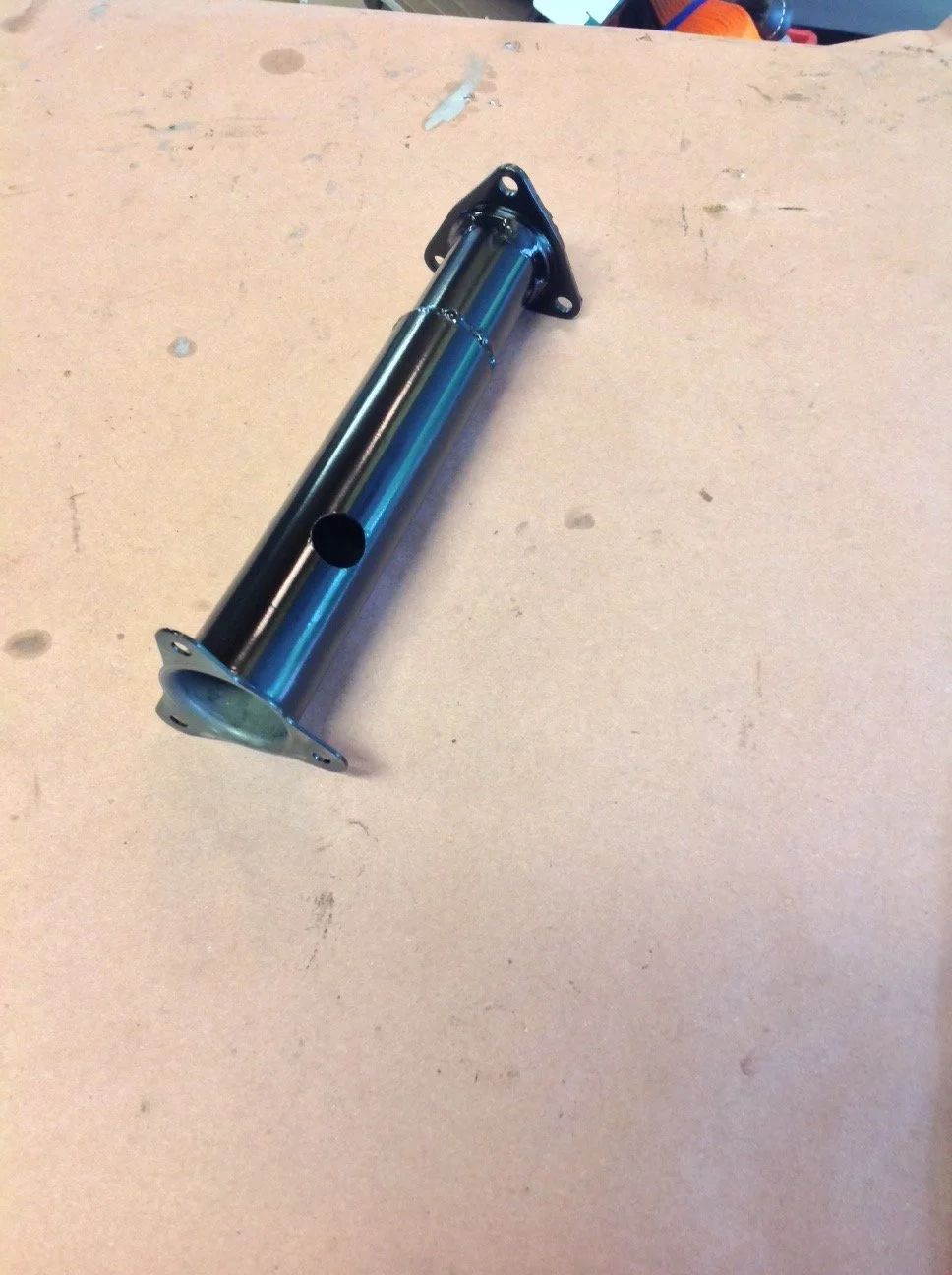

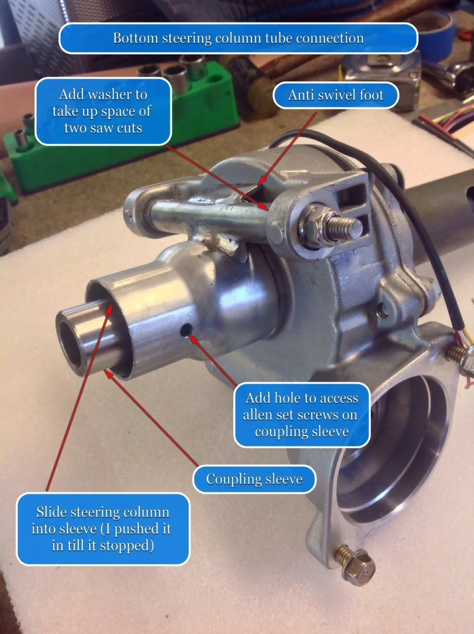

Only actual modification is to the steering column
Only problem I had was due to a cheep fuse holder that came with the setup. I had good support in that Wayne sent new motor and control until I found the the bad fuse holder. Still working perfectly
