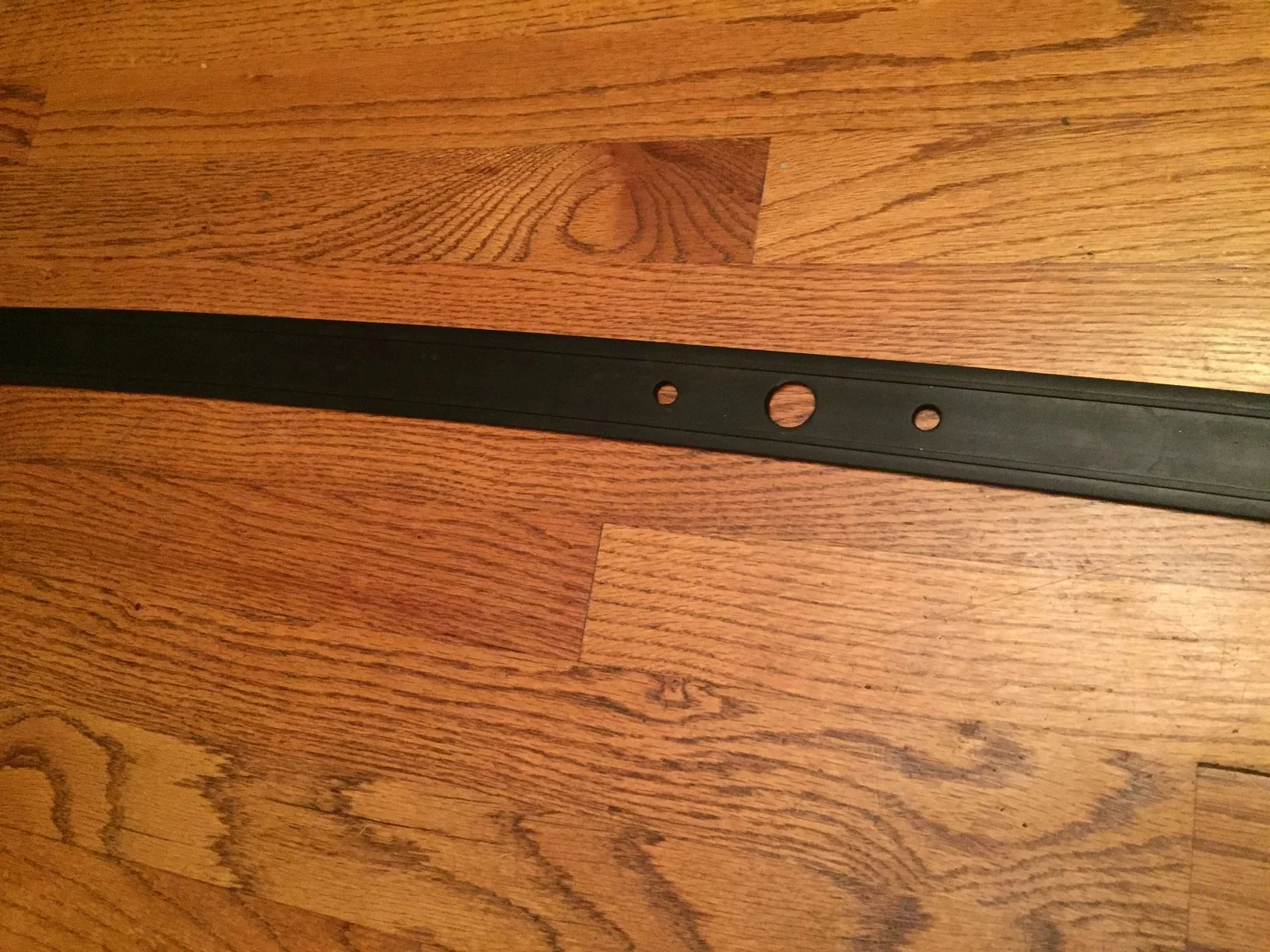

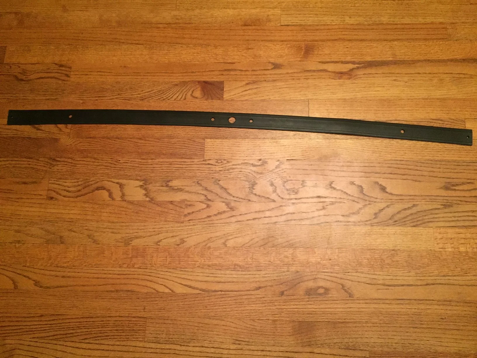

Last year I obtained a rear center cab seal from a club member, @76 FJ40 . As you may be aware, this piece is no longer available from Toyota, even though the side pieces are still available. In any event, I used the piece I got as a template and made a reproduction of it. Just thought I check to see if anyone has their truck in a disassembled state such that you can quickly try out this reproduction piece for fit? Your vehicle must be '76 or later, as the earlier trucks have a 3 piece set with slightly different dimensions.
If it fits, it's yours to keep. Otherwise, I would like feedback on what needs to be modified. Here are some photos of what I've got:

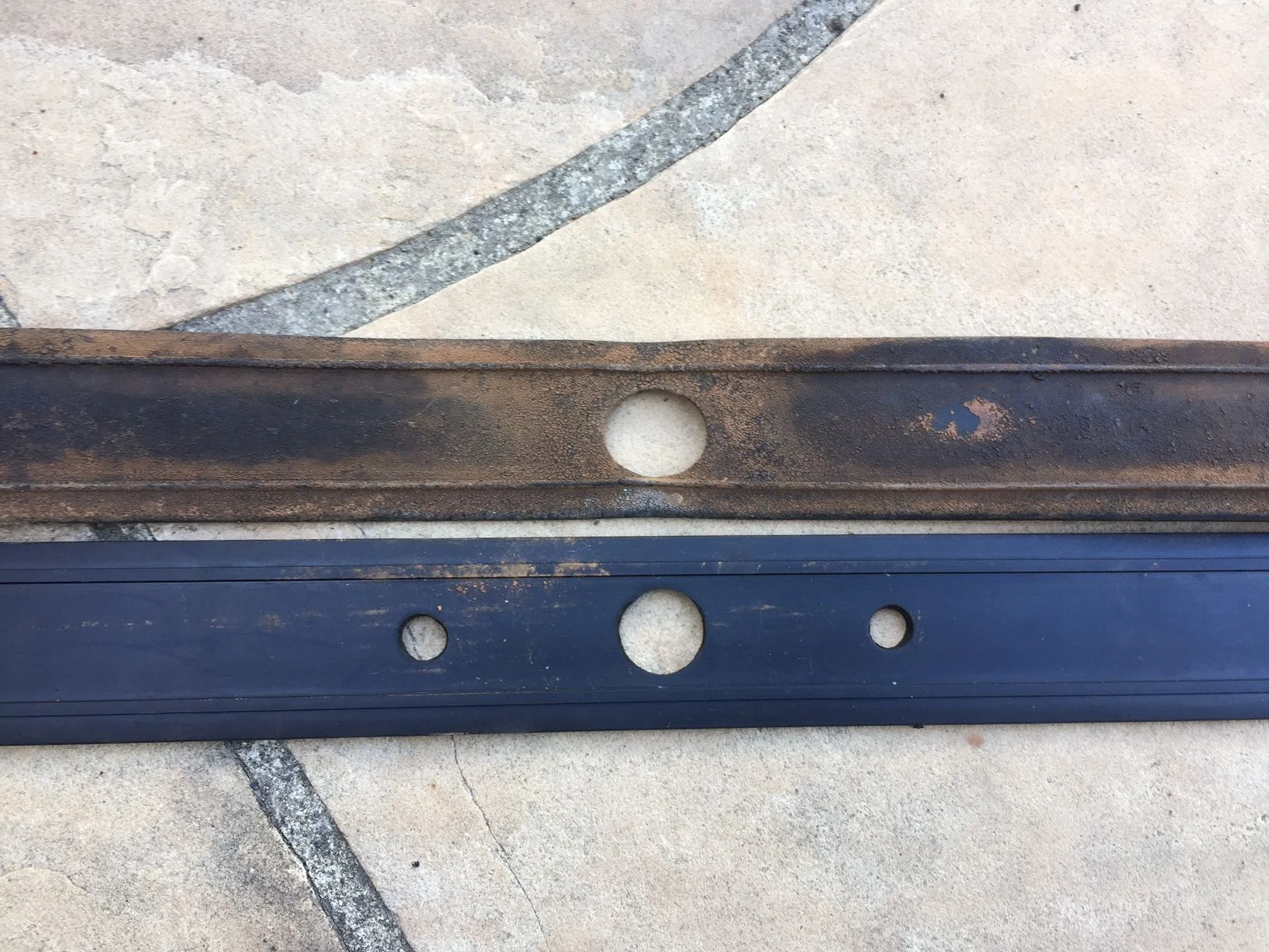

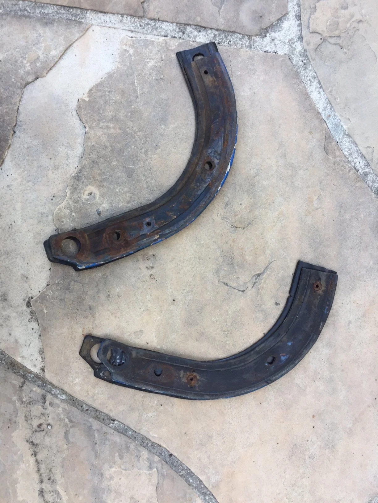

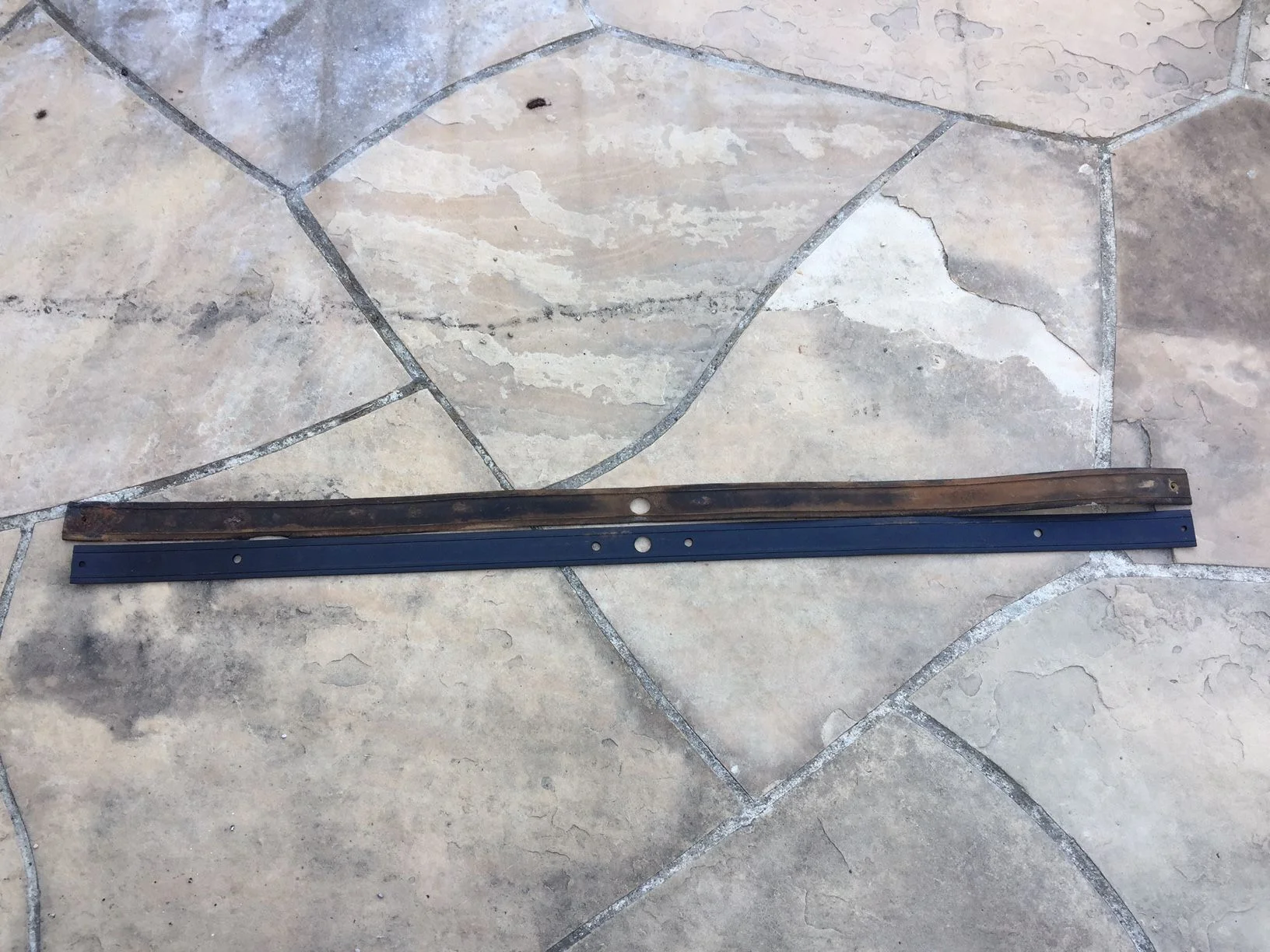

There are differences in length as well as as the number of holes. The newer style one is shorter (by 3mm), but it's matched with side pieces that are slightly longer. Here are some comparison photos of the repro based on the later seal, next to a sample of the older style seal. The last photo shows older style side pieces overlayed on top of the newer style side pieces. Notice how the older one is smaller.

This is something I learned recently after someone sent me a much older sample. Checking the EPC, there are two part numbers:
64833-90300 - 5/75 to 7/80
64833-90332 - 3/69 to 5/75
