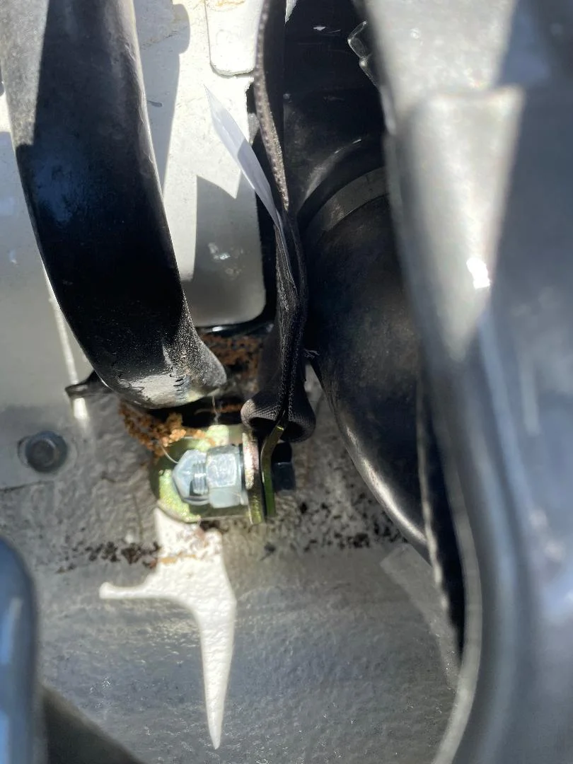

Could someone please post pictures of a passenger side shoulder restraint and how it attaches around the fuel tank. I am having trouble figuring out how to install shoulder restraint. Lap belts would be easy, I would like to have a shoulder restraint, I cannot find a third anchor point.
WyattEarle,
I drilled out the back seat bolt to 7/16" and used a 90* Bracket that came with my seatbelt kit. It is the only place I found that doesn't interfere with the covers on the evap canister.

I drilled out the back seat bolt to 7/16" and used a 90* Bracket that came with my seatbelt kit. It is the only place I found that doesn't interfere with the covers on the evap canister. View attachment 2680207

Thank You for the picture. I have been racking my brain trying to figure that one!

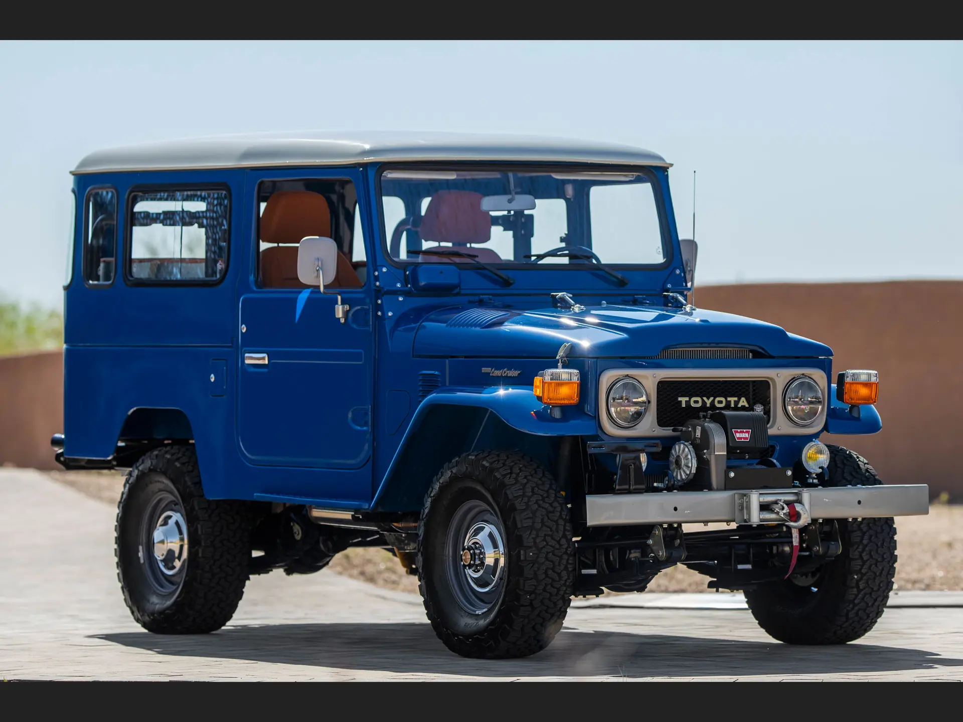

Not a good one handy, but this will give you an idea (the first is mine, the second from the web). The factory soft top doesn't have the door striker: it's got a hole for the latch to slide into. It's also simply a 90° corner rather than notched for the weather strip.
The lower corner on the tub is also radiased rather than a sharp 90° corner like on pre-'79 NAS 40 series. The '79-'84 NAS 40s all have the radiased corners like the hard top 43. I don't know that Toyota offered the factory hard top on the 43 prior to '79, so I can't say what, if any, differences there were on those years.

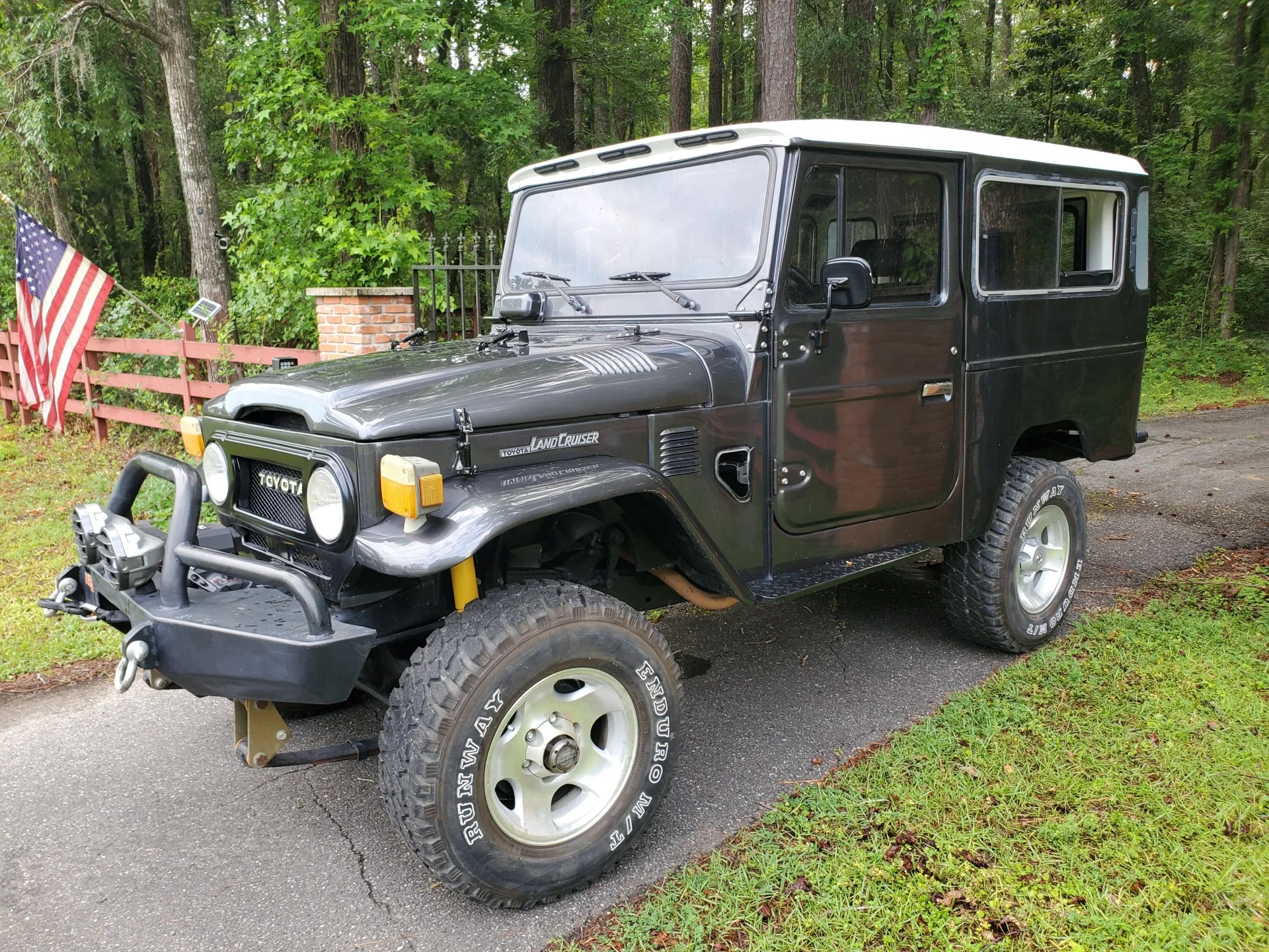

Here is my 82 43, but I’m 99% sure it’s a Colombian replacement rear bed.

See how your door is square, but the corner is radiused? I THINK that's different from stock: I think the corner was square originally on yours to match the half door.... But yours has no notch there for the weather stripping, which is how the soft top version was made.
Yours looks really well done. Mine is anything but well done unfortunately. I'll get it there eventually..... but it was 'restored' by the Pakistani troop of the Budweiser Brigade.
