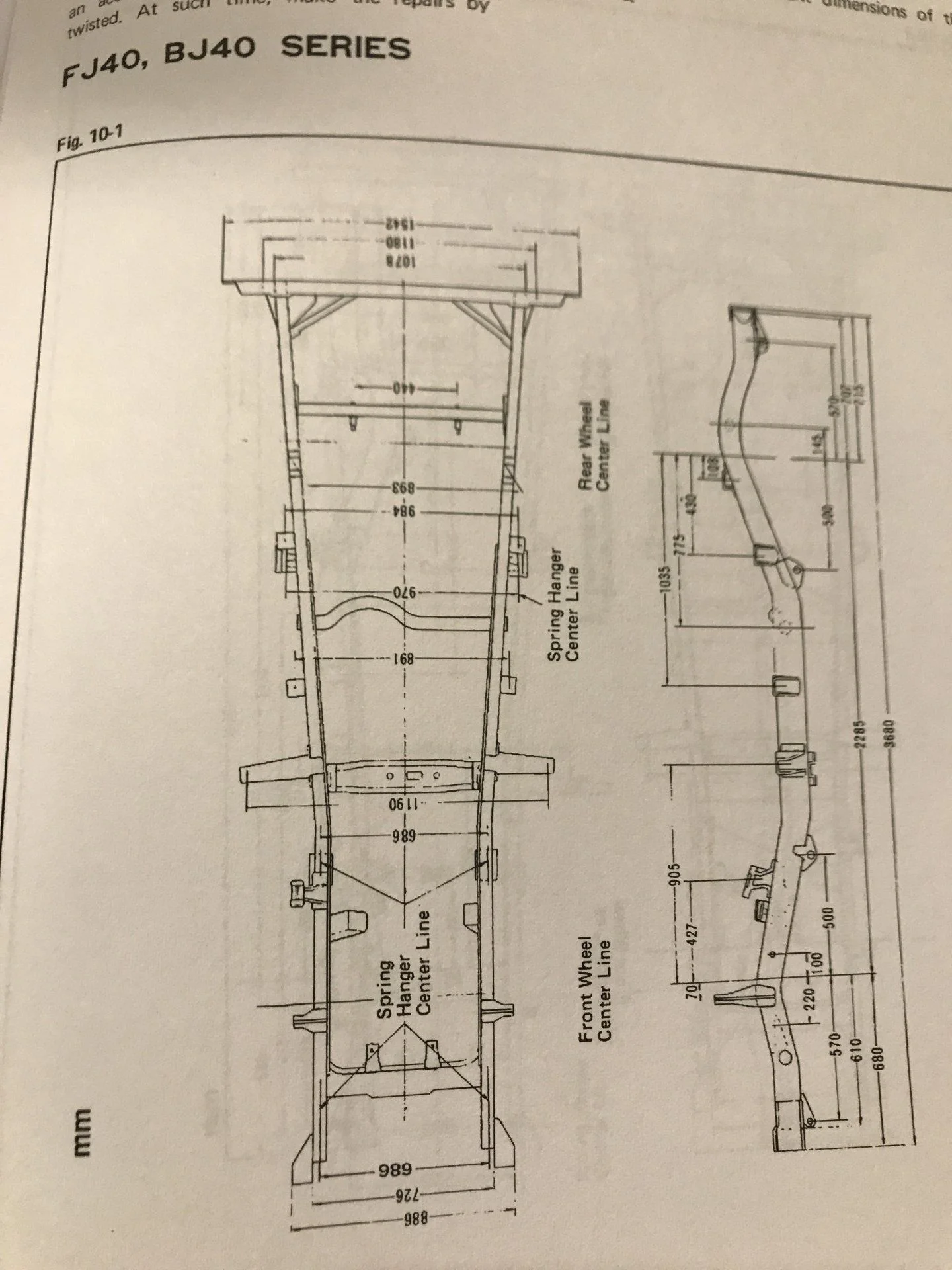

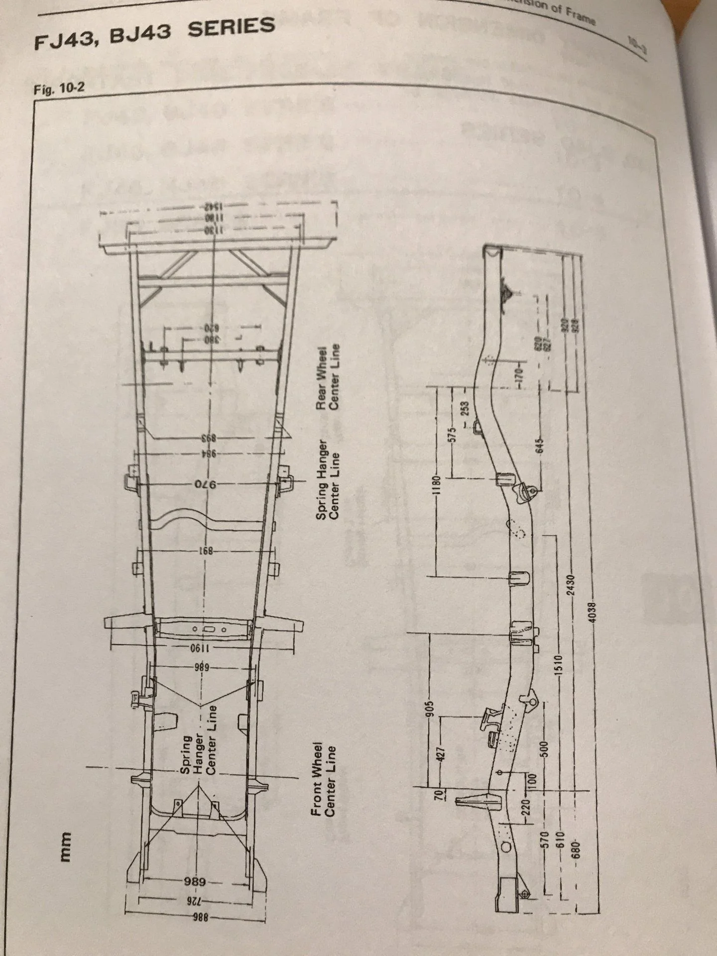

You nailed the main differences. The rear springs are different from a 40 (longer), but same as swb 45 pickup; 43s have rear sway bar like 45s; rear barn doors and hinges are different; rear tub isn’t notched for amby doors.
As 43s don’t have all the pollution control crap as US 40s they have different carb, dizzy, water pump, fan (no clutch) t-stat housing and air cleaner housing.

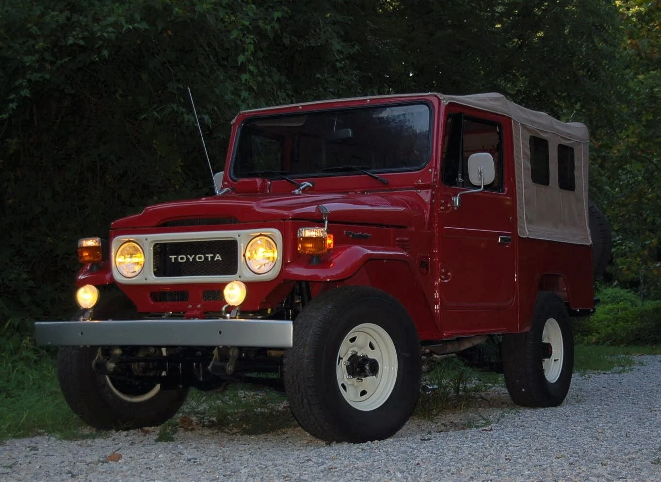

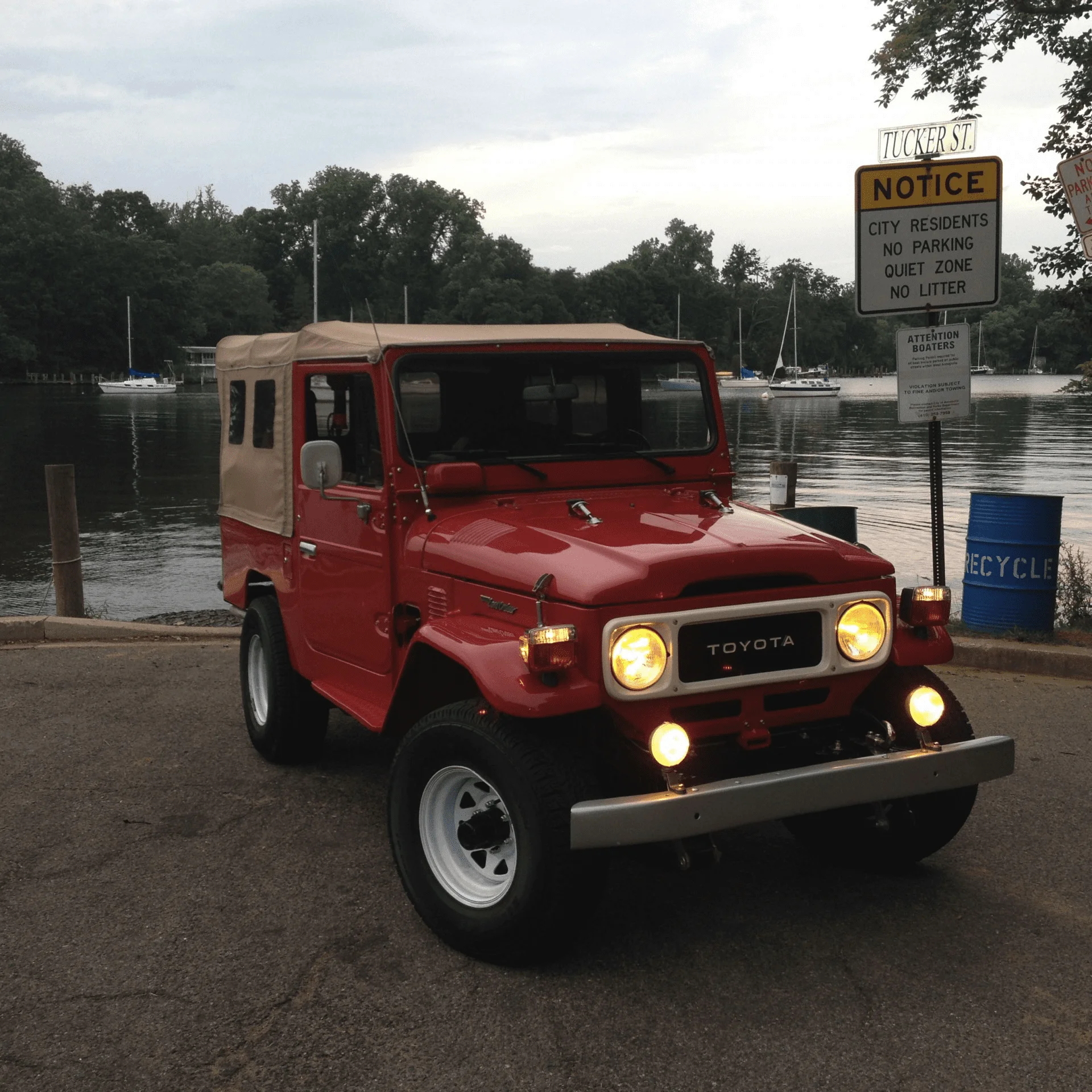

To clarify, my FJ-43 did not have an OEM rear sway bar but I had the builder add a custom one. There are aftermarket bolt ons available but they would not work with my rear mounted fuel tank.

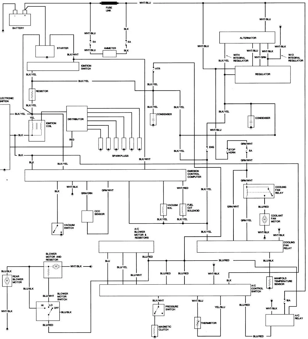

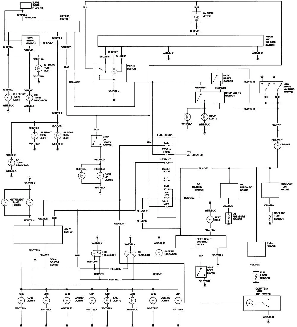

Hi guys, sorry for taking so long to get back to everyone, great info! So glad I started this thread. Ive found the main issue with my 43 is the wiring. Does anyone have some sort of wiring diagram specific or appropriate to a 43?
This the one my builder did for mine. Note that it was a restored with a 1FZFE and Dakota Digital Dash so it will differ from the OEM. I also have the Toyota Land Cruiser FJ40, 43,45, 55 & 60, '68'82 (Haynes Repair Manuals) 1st Edition which includes all the wiring drawings. Its available on Amazon for $21.

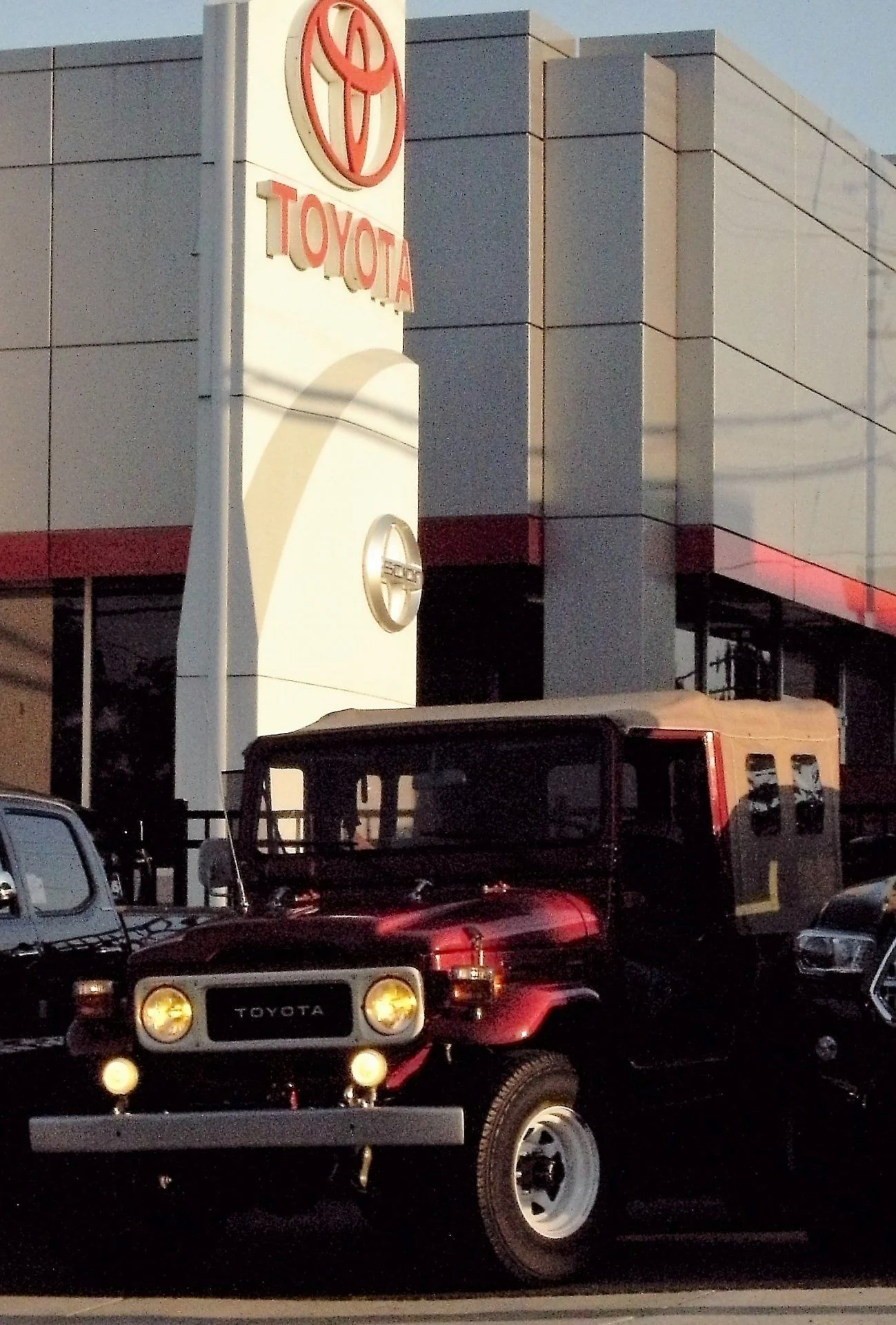

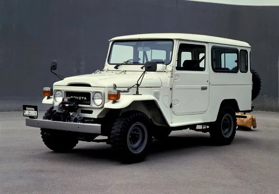

...and the JDM version (1979) of the BJ43
As we can notice, no Free Wheeling Hubs...

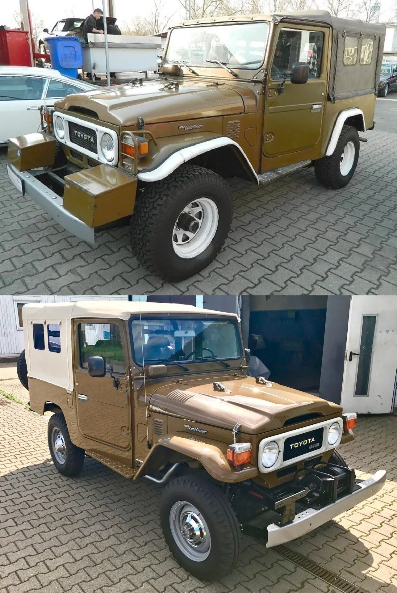

1984 BJ42, frame-off restored, 4E9 Toyo beige
1983 BJ45, resto projecτ
