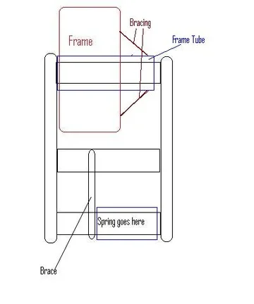

Assuming a SR, how are you going to deal with the shackles at the rear of the front springs? One side of the shackle is square in the middle of the frame rail.
I've got the idea to build a custom pair of shackles that are wider than usual, pass through the frame like I want, but the outboard side of the frame shackle tube sticks out 7/8" further with appropriate bracing and the shackle would look like this (Pat. Pend.). There is a bit of torque, but not so much I'm worried about it. It's well less than the torque in the normal flex of the springs under articulation. As long as the shackles are overbuilt as I intend, I believe it will work. Going down the road one end of one spring is only supporting about 500 lbs; maybe double that in a hard corner.
What do you think?
What do you think?
What do you think?

The problem I see with that shackle setup is when the spring flattens out, you will probably hit the center brace on the bottom of the frame. My shackle setup is offset some since my D60 front has a 27.5" spring spacing. I had to make a spacer for the leaf spring end. I will see if I have a pic somewhere and post it later.
If you are doing a SR with that shackle setup, you will be sitting a mile high if you keep that shackle that long and that vertical.
The center brace is going to be the limit on that end of the travel for sure. It's not going to be a mile high even if I have to give up on SOA and do a 2.5" OME SUA.
The picture as I drew it quickly has the center brace in the center. In reality it will be as close to the spring as I can get it. It's possible to do this without the center brace too, but I want it in there to deal with the torque and to keep it stable at higher speeds. I want to be able to drive to the trailhead.
I've got more geometry calculations to do before I fire up a welder.
