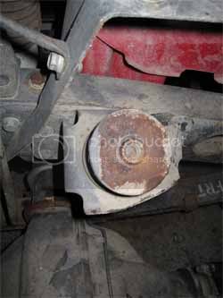

colin, for now just drill a hole thru the whole thing, put a grade 8 fine thread bolt and nut in there and we'll find you a mount later. it'l take me a while to find them in the ship and i really need to get some other stuff done to prep for coloado trip.
No worries Erik, I'm not going to be putting it back in this weekend anyway. I just finally got the tranny/tranfer mated back up with the engine this morning. Name a night and I'll bring some beers over and we can dig through your collection if that works for you. I finally just got the pitman arm off after breaking 2 cheapo harbor freight pullers. Hit it with PB blaster, waited 5 min, slid right off. Going to get the P/S gearbox all mounted up, rebuild the center arm and do a few other things underneath while there's no drivetrain in the way.
lemme know what type of motor mount it is.. there are 2 types. one that has a lip and one that's flat. picture would be best. side profile
