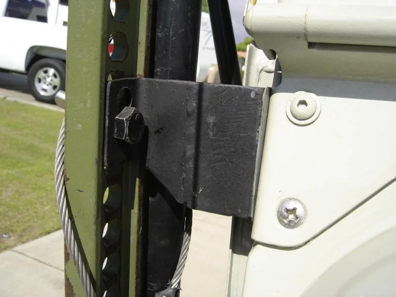

The real beauty of the FJ Mount is that it can be mounted just in front of the door opening and it will not interfere with the door and you can still open the flaps (not sure the correct name but the things that let water in when you forget to close em). Biggest selling point for me was the ability to lock it to the truck. Albiet the jacks aren't all that costly when compared to the other recovery gear i certainly don't want to be replacing them. To keep the grim / mud off the jack when outback i simply wrap a plastic bag around it with a bit of electrical tape. Eventually would like a wet suit material or canvas bag. Pic of contents. All bases are covered in that little box of goddies and really does fit inside the glove box.

I have mine running shotgun style as well on the side of the truck...
more pics of different side truck mounts here...this is a link....click it>>>https://forum.ih8mud.com/40-55-series-tech/358045-high-lift-jack-mount-side-fj40.html

I'm another vote for "shot gun" mount. I made my bracket from a scrap piece of angle iron, cut a rubber gasket that goes between jack and mount and also bottom of jack and running board. absolutely rattle free. Total cost about $.79 for the rubber.

Actually, the Hi-Lift sits pretty flush with the fender and step; so, if you you are going to hit something, it will hit first the fender and then the Hi-Lift. Besides, due that the jack mount is attached to the windshield hinge point, it makes it a pretty good bush guard.
