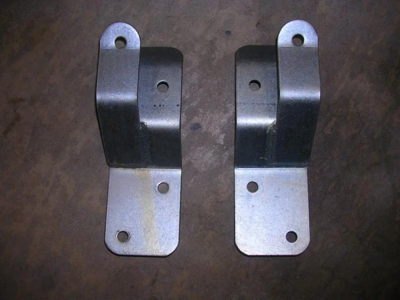

pic:
attachment.php
There was an old style set of hi-lift mounts in the classifieds section last night.
Cheap too
Here's mine. Pics are not that great, but I think you can blow them up. I have several more eye bolts that will fit into the frame holes(they are not stainless), but I have the stainless bolts, nuts, flat washers, and lock washers to mount them. The eye-bolt holes fit with the holes in a High Lift Jack.
