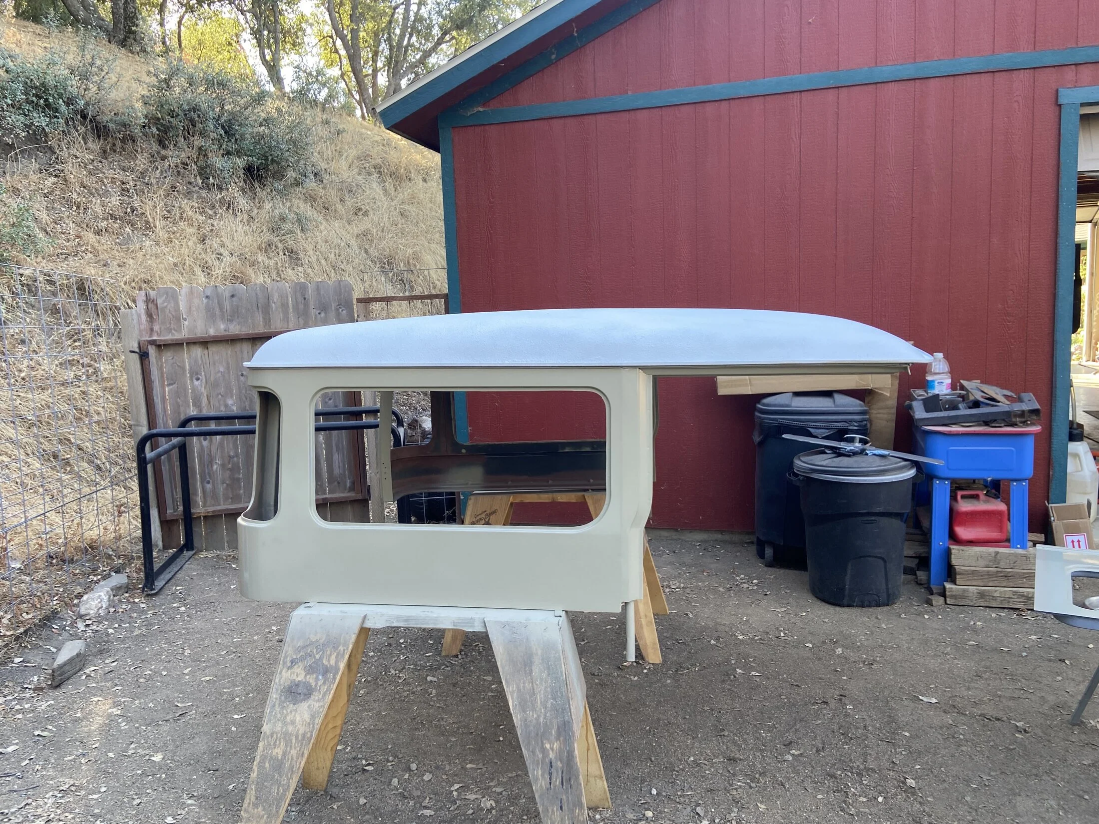

I recently bought a hardtop for my ‘74 FJ40, that’s in decent shape, and my plan is to completely have it restored. I’ll be outsourcing most of that, but in the meantime I’ve taken it apart and I’m considering a winter project. I was kicking around the idea of removing the glass and using one of those pressure washer sandblasting kits to remove all the paint and rust from the metal. My thinking was, again, to have a project, and to also maybe save a bit on the cost of prep work.
My questions are if this sounds like a good idea and any suggestions on the right way to do this. And any suggestions on if I’m nuts for doing this!

Well...definitely take it apart. Remove the glass. Look closely for body filler and rust areas that need remediation (new metal).
Spend time on getting bolts out that manage to twist off. Decide exactly how you want paint stripped. If you are sending it off
to one shop (and won't get it back) till done you may want to get some "interior frame rail" paint coating and slowly coat the inside through
any holes available in the panels. Look closely at the fiberglass roof. It may be cracked and allowing water in. I would strip
the roof by light sanding and then remediate any weak fiberglass areas....getting the thing perfectly smooth for just an eventual
epoxy coat by a pro.
