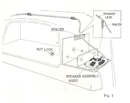

Done a few searches, but can't seem to find anything. The FJ40 had a factory radio option, so obviously they had the optional factory speakers somewhere. Anyone know where those were mounted/located from the factory? The wiring diagram I saw showed two speakers. I have seen a billion threads about aftermarket kits, etc...., just curious where they were located as factory options. Bonus points for any pics. Thanks!
Technically mounted on the outside of the glovebox on a shelf to right.

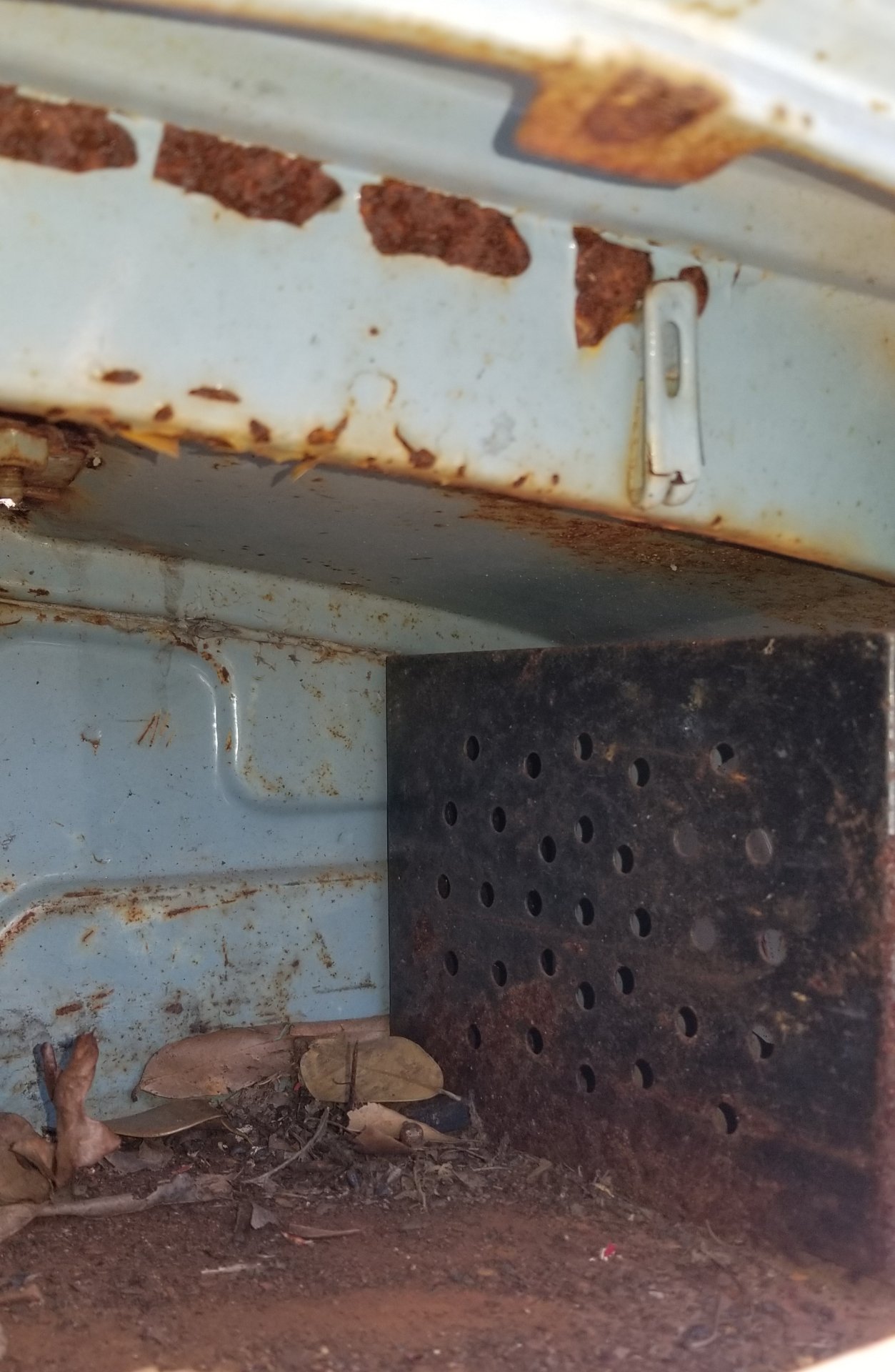

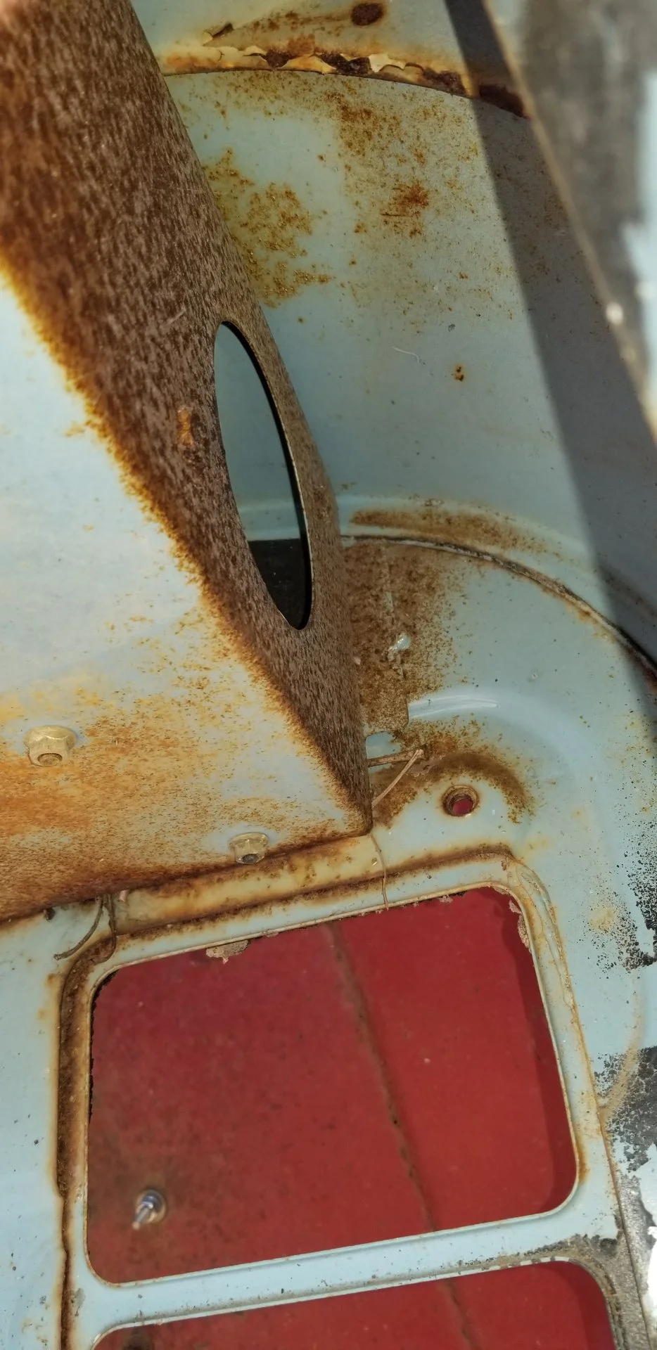

1974 location. Cage is inside the glove box.
Single speaker.
1974 location. Cage is inside the glove box. View attachment 3082221Single speaker.
That's the only OEM speaker I've ever known about. Not sure where the 2nd would have been if that was ever a thing. I've had some earlier than '76 40s, which I have now, and still can't recall ever seeing a 2nd speaker location.

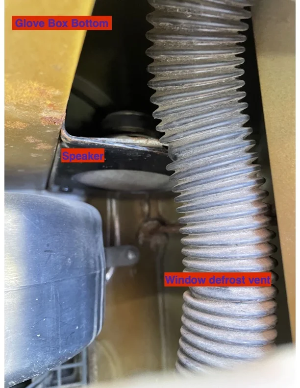

78 speaker mounted on the outside of the glove box.
Ha! I found it. I've only had my cruiser for a few months, but these things are so cool. See pic. Now I can hook up a radio and blast some tunes! I only found one and didn't see anything on the drivers side, so I'm guessing there's just one. I just snapped this pic and marked it up in case someone stumbles on this thread down the road and needs some help finding it. The speaker faces down.
