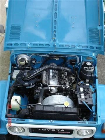

Ahhhhhhhhhh Mannnnnnnnn Thatssssssssssss Cooooooooooool that thing........ would fit in my nicely in my FJ55....Drool
1979 BJ40

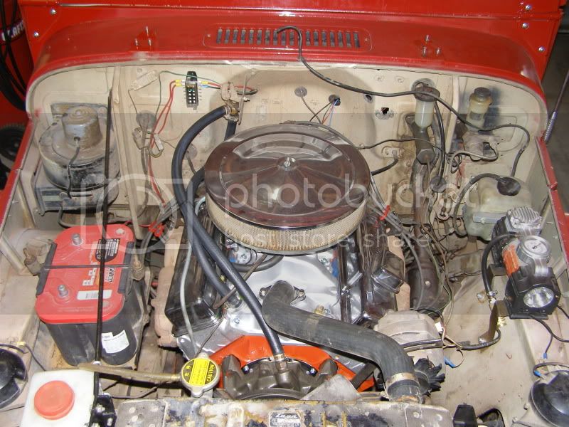

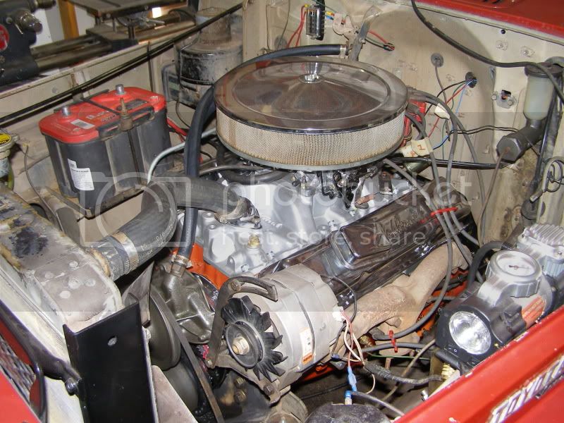

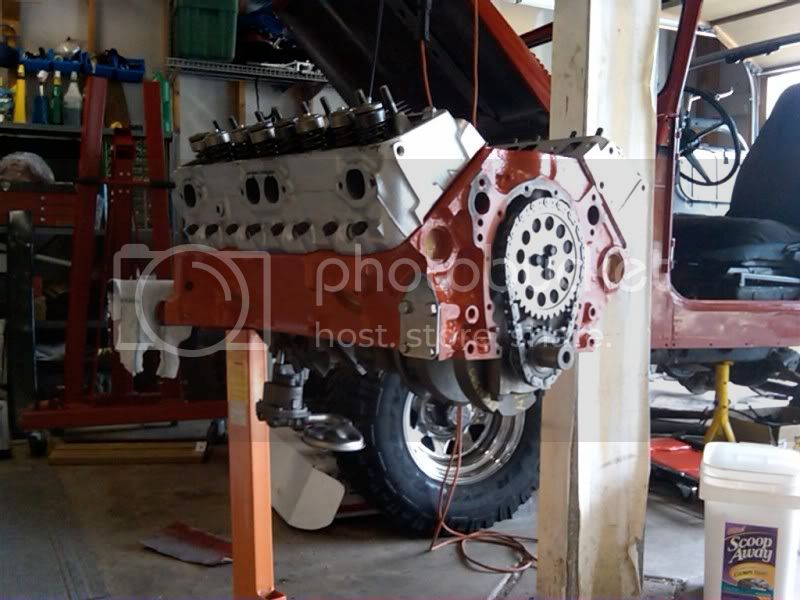

355 Chevy. No miles yet, but it's close to getting some miles!

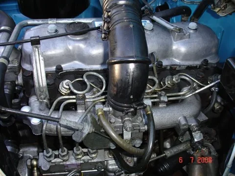

3B with aftermarket turbo
3B with aftermarket turbo upgrade, can definately feel the pull. compressor 3 inch inducer , and 2.5 outlet, a/r .60 and turbine .63.
internal waste gate set to open at 8 psi. exhaust down pipe to out 2.5 inch without muffler. Can hear the turbo wine all the way. Sounds good. Running 31x10.5x15 bfgoodrich mud terrain km2 no problem.
thx for viewing

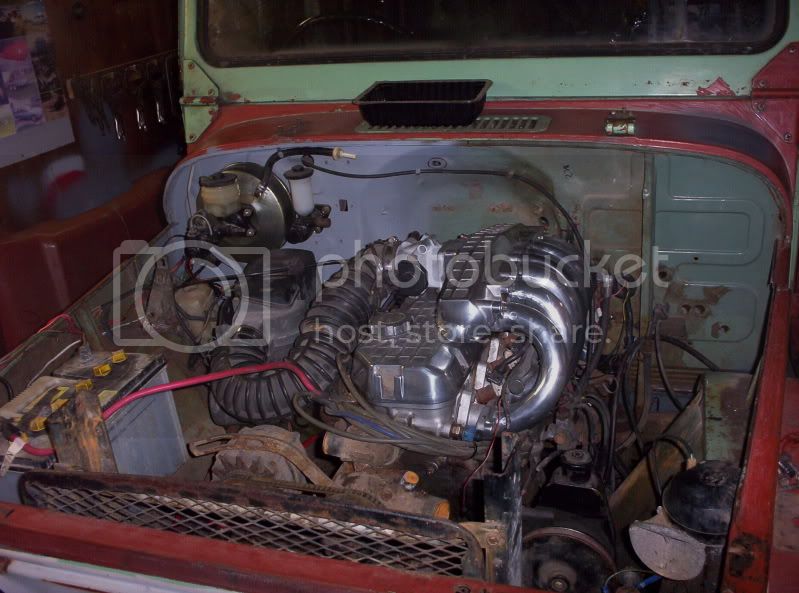

My F135 Pancake....:)
