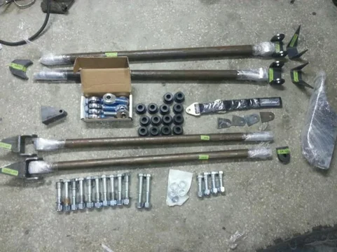

Quick question for you are those link kits for the Toyota axles? cause it look likes the truss is and your going to need to fab or order new trusses.
