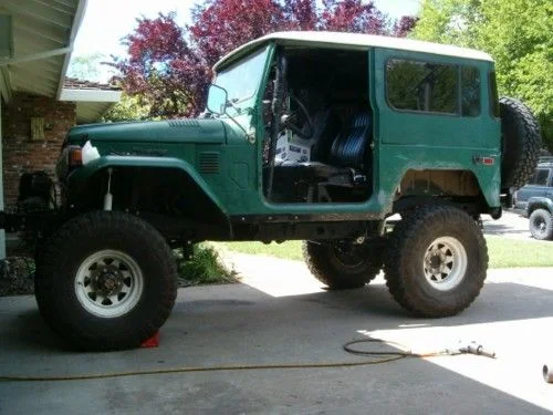

My truck when I bought it in Jan 2007:
My truck as it sits now:

Here's mine-SOA, 99 inch wheelbase, FJ60 axles, Longs/Polys, SM420 etc.
attachment.php
I strongly recommend you swap to the FJ62 axles. Run polys in the rear and Longfields 30s in the front and that's about as good as LC axles get. You'll also get the larger and stronger knuckle pattern, better hubs etc.
If you can really cobble together a Toybox, that's great. Please keep us posted on that. I would run the split case for sure if that is an option. It's a much better transfer than the one piece case.
Nice looking rig!
