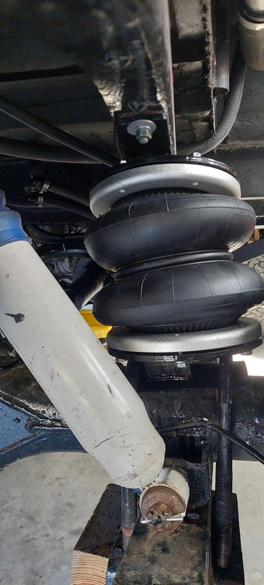

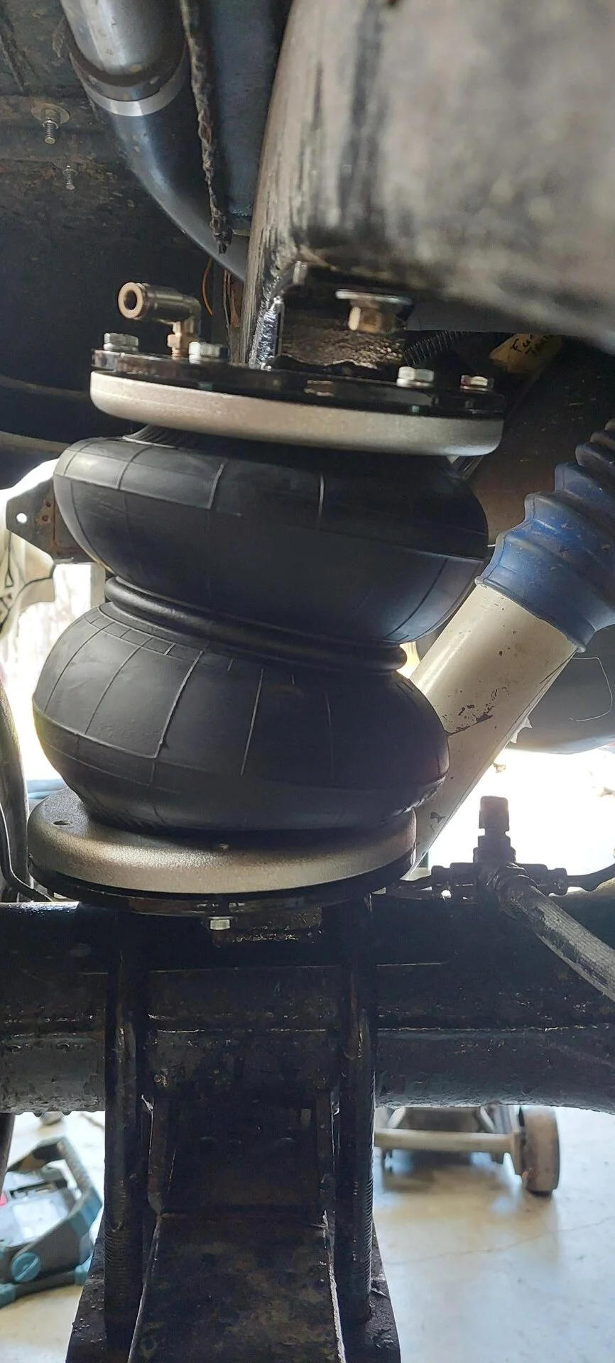

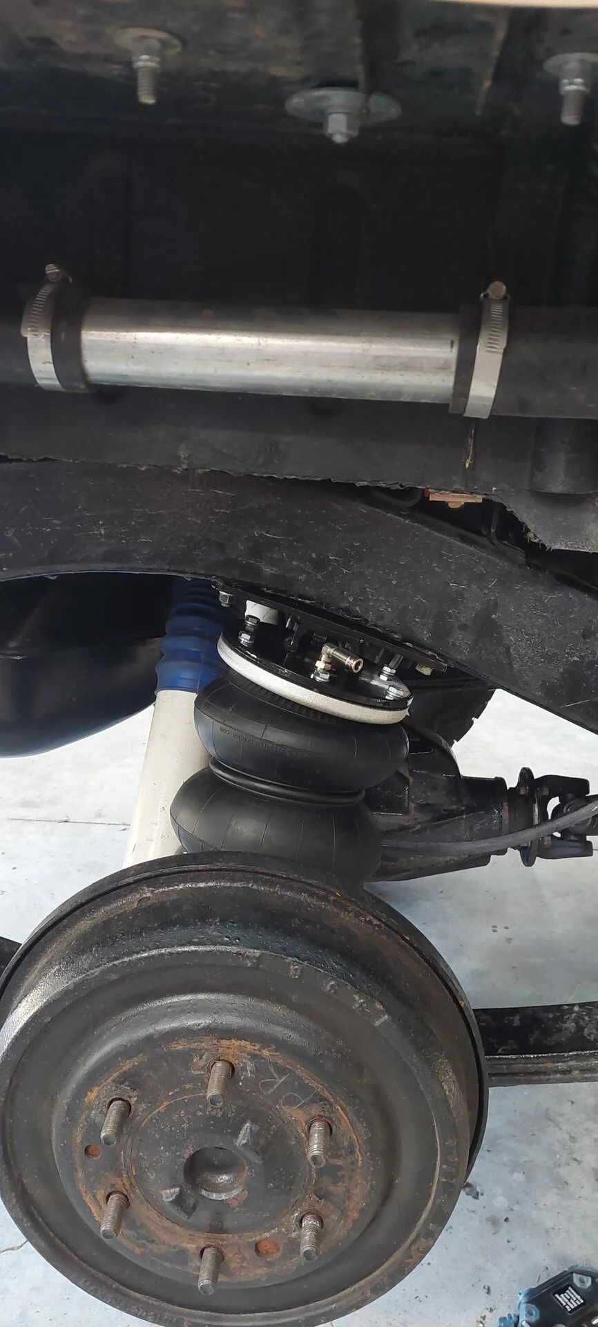

Does this look right. The bag mounts are not right underneath each other. The top mount is leaned toward the front of the vehicle
There should be some pics in the MM40 thread. Bottom line: the LC brackets were designed for the longe wheel base of the 43, 45 and 47 series, where the top of the arch in the frame is directly over the axle.
