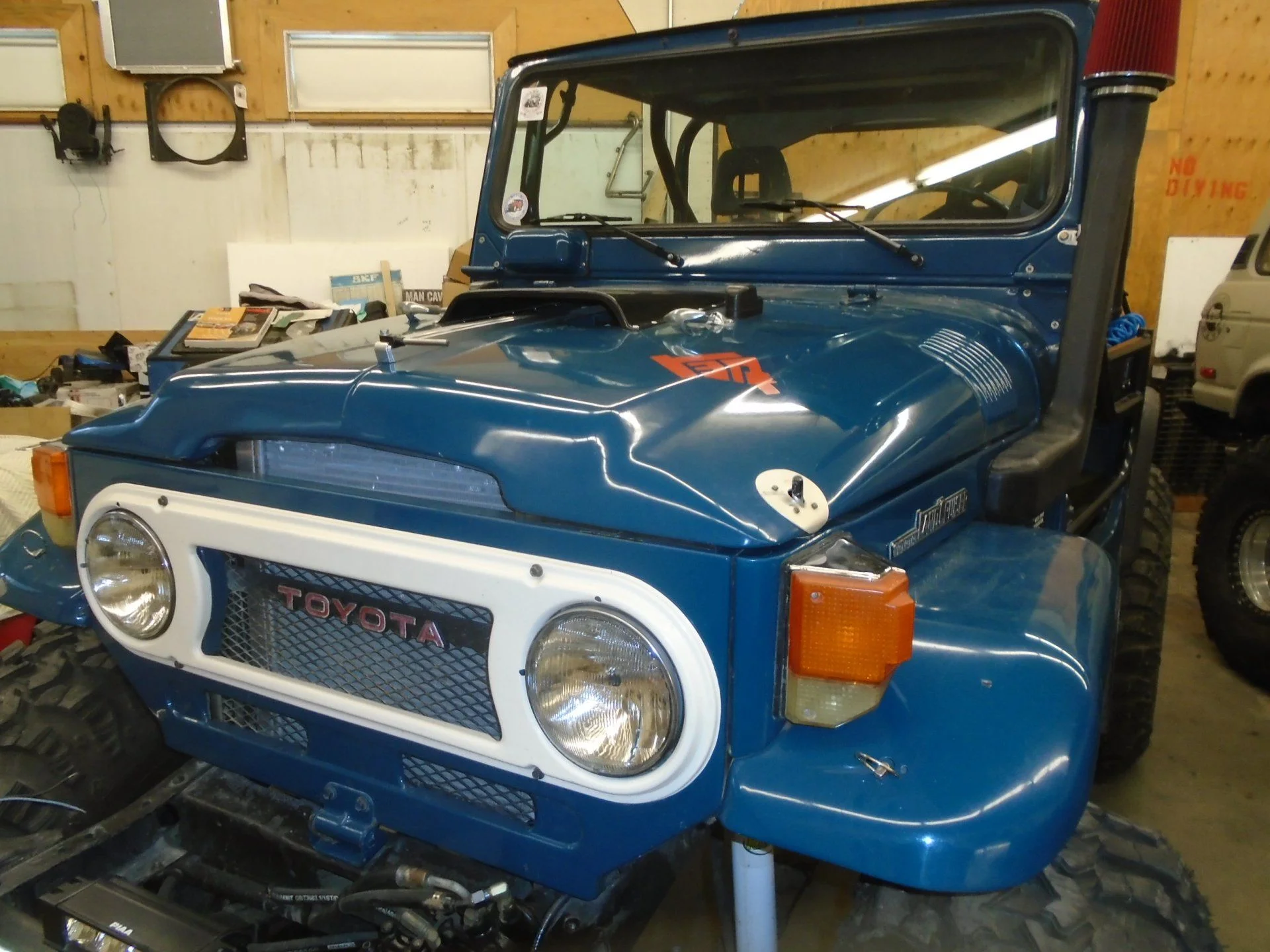

A shot from 2019, another engine 383 LT1.
nice! What headers are those? My old V8 40 had the Advance Adapter ones, which got extremely rusty being exposed like that. I did get some old ramhorns finally, but never got them in before I sold it.
They are indeed Advance Adapter headers, i had them coated though.

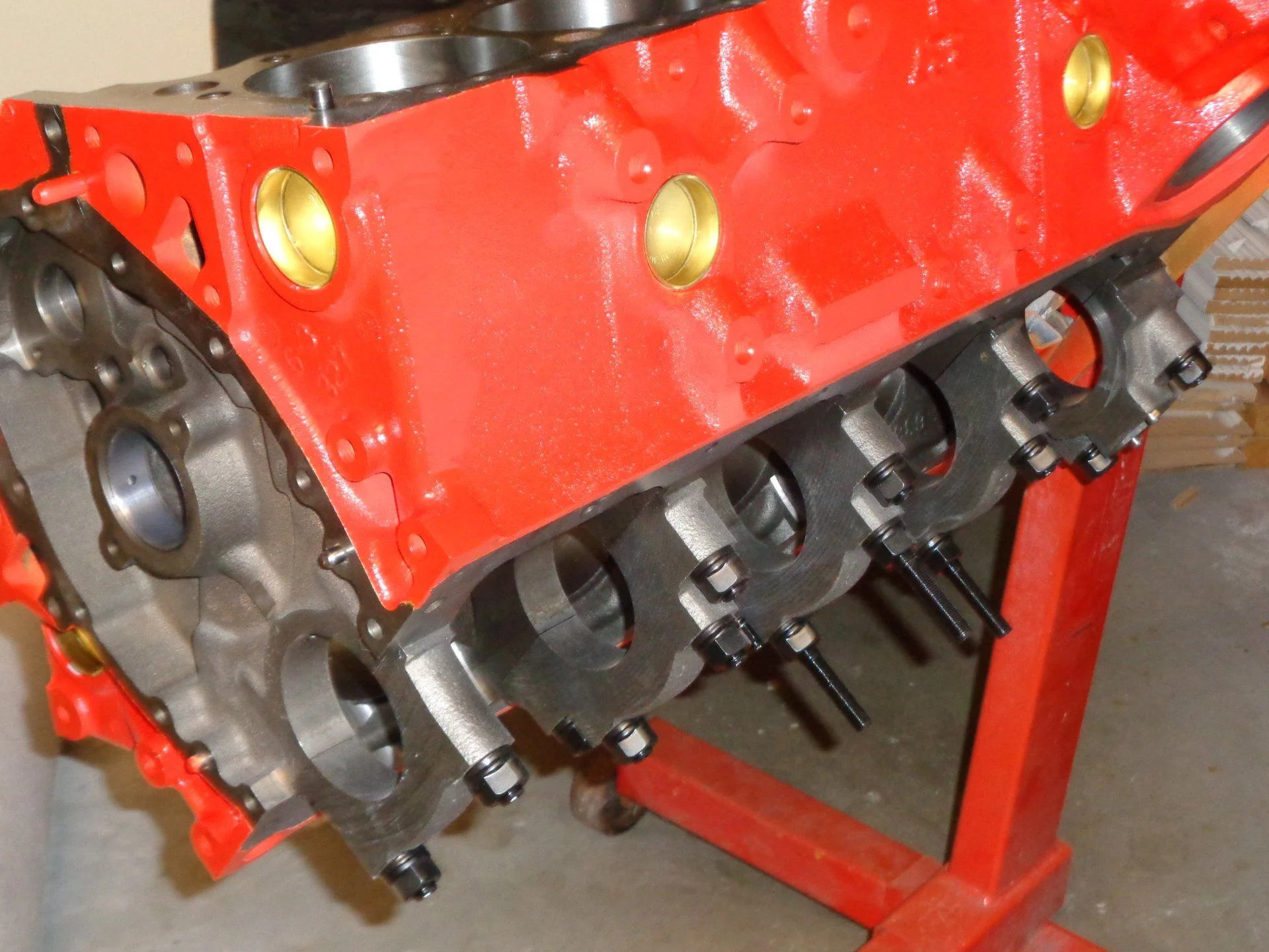

Was lucky enough to find a 4 bolt main block from a Vette. Coated & ported factory intake , removed all the EGR crap & installed larger injectors & throttle body.
These are a little more recent. Changed the seats for these Acura ones. Had a set of IROCs so why not. Scoop is off the car.

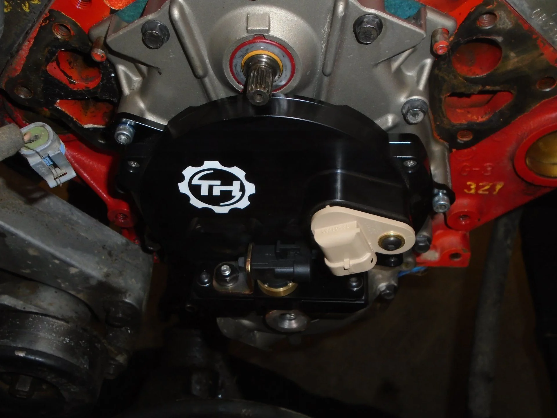

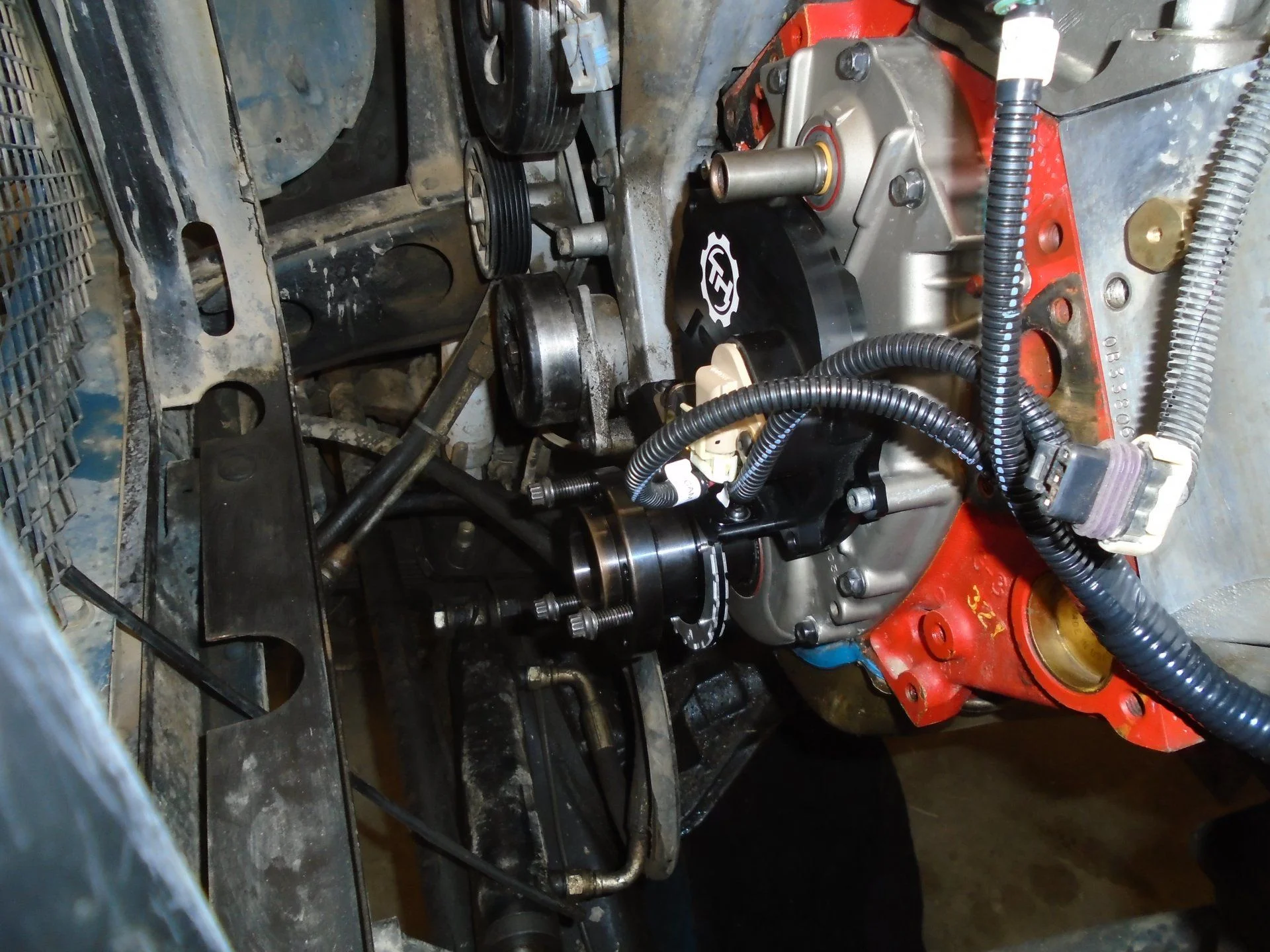

Ignition upgrades for this summer, no more dreaded Opti Spark. I had upgraded to a MSD distributor / LTCC controler with individual coils but was having issues with it dropping cylinders and just running crappy. This time i am using the "Torqhead" system. It too uses 8 LS truck coils but it uses a repinned LS PCM, LS cam sensor, and a custom made crankshaft sensor. It does away completly with the distributor.
Fired right up on first try with suppied tune. Waiting on HP Tuners shipment to tweak the tune.
