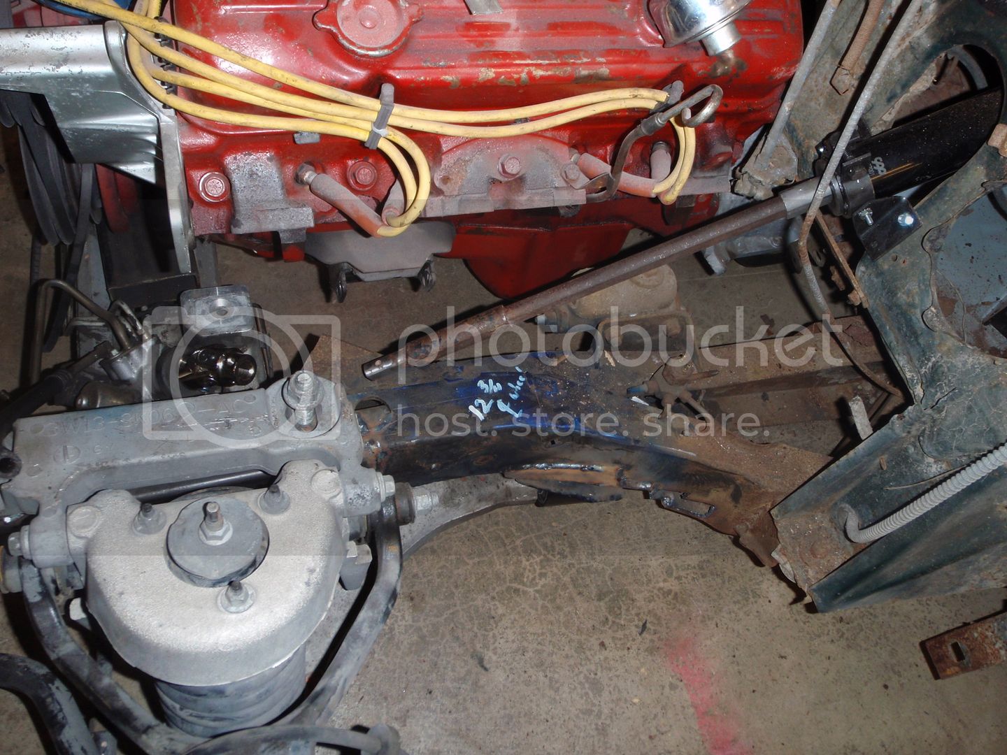

clipped a 2003 Lincoln town car suspension in a 50 Buick

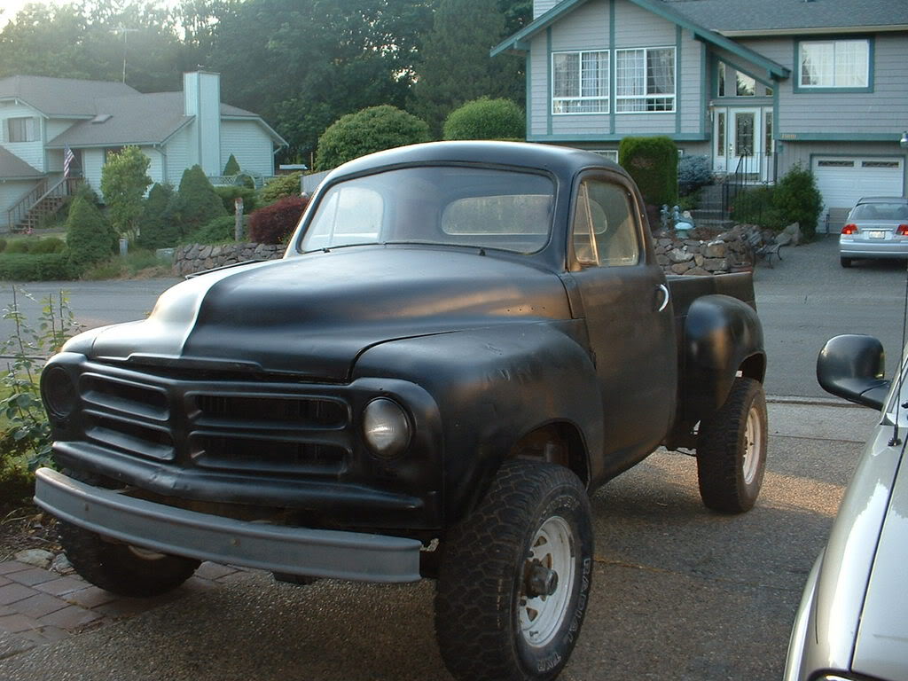

s-10 frame under 54 Studebaker

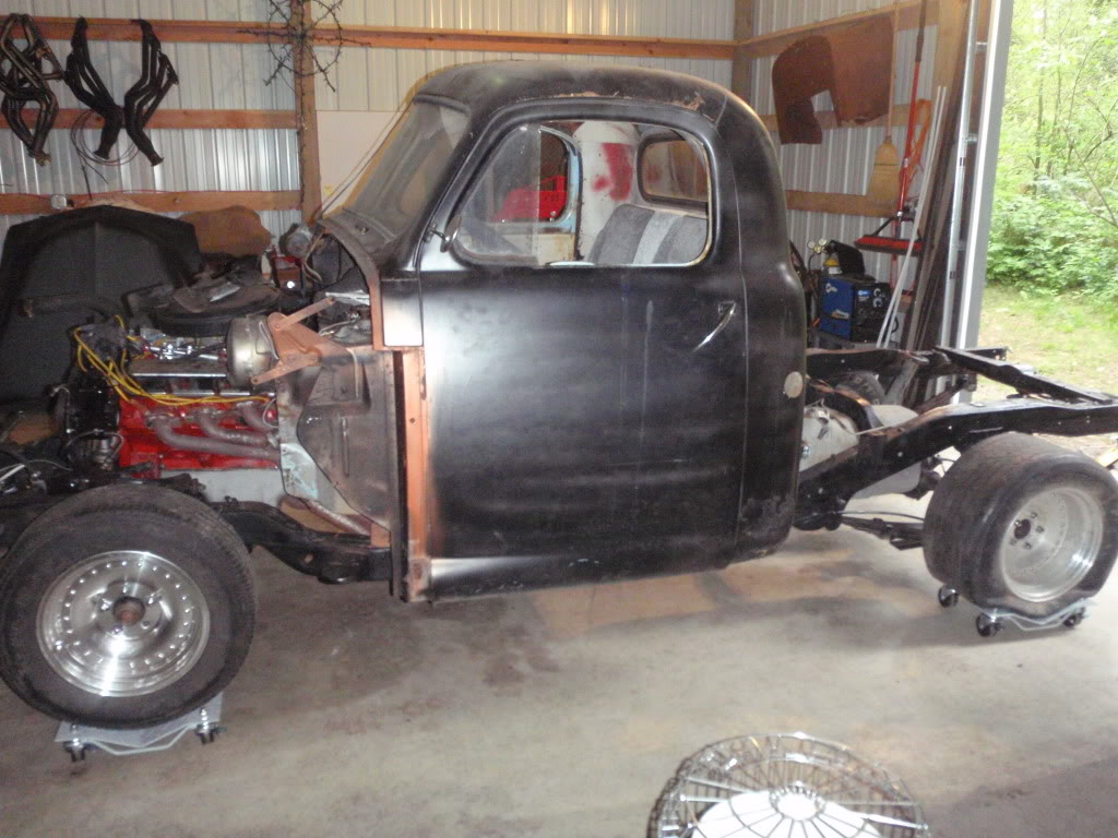

prior, same 54 Studebaker with a 3/4 ton chev 4x4 frame

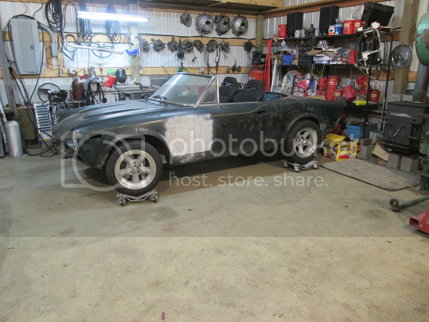

my garage art - but it's a 79 Fiat spider with a cadillac cts motor and twin turbos - the suspension is mostly aftermarket mustang 2... this one is probably most relevant because of the mistake I made - that is, I should have simply cut the entire firewall, floor, trunk and frame rails out of the car before I ever started.... I probably have 1000 hours in it, and would have only had about 200 if I'd simply started with a tube frame and hung the body on it like artwork.
